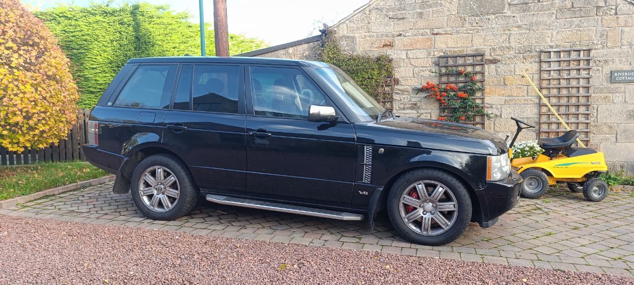

WHO WOULD HAVE THOUGHT that a Landrover product is a liability. After spending two hours yesterday replacing the driver rear brake hose (without destroying the rusty hard-line in the end fortunately) it's the driver side front airbag today that's suddenly leaking:
I can actually hear it leaking slowly so unless jacking it up on one side somehow compromised an airline (or causes the car to deflate the front very slowly for some reason) overextending the airbag ruptured it. Buying a relatively low mileage example with gearbox issues was supposed to give me a car that's cheap for one particular reason and otherwise decent but the Range Rover breaks quicker than I can fix it.

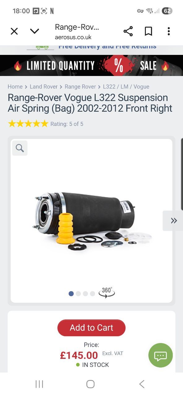

The next step will be finding out what aftermarket strut is actually worth it's money. I've replaced front air struts on my Mark VIII plenty of times so it should hopefully be fairly straightforward.

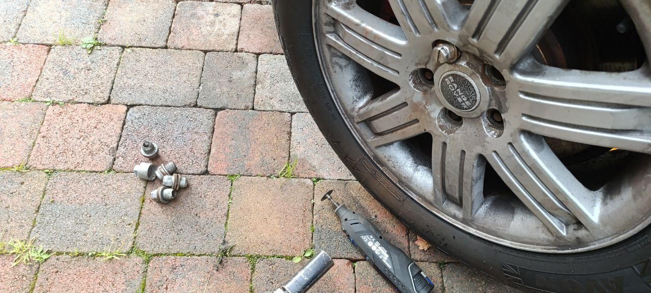

It also doesn't help that LR decided to put non-removable chrome covers on each lug nut which a few years on are all different sizes due to rust jacking now. The Dremel had to come out for one of them. Doesn't help that Halfords went nuts when torquing one of them either.
It also had to come out for that brake line fitting as well:
While in there I noticed that one of the CV boot clamps had snapped and started to fling the grease around. I replaced it with a leftover from the Alfa boot job which hopefully will do a good enough job.
Also, for some reason the dash screen is constantly staying black after starting the car now so I'll have to investigate that...
So yeah, one step forward, two steps back. Not particularly confidence inspiring considering I want to pull a trailer all the way to Germany and back next month...
Dunlop bags tend to be decent and not too expensive. Easy to change too. Sorry its being a pain, jacking them up does tend to weed out old bags.
Maxpeedingrod are also good. Fitted to my S211.
I was dubious. They are cheap. But they have a good reputation.
Aerosus also decent
Yeah mine had Dunlop airbags fitted and they seemed fine.
I replaced all my wheel nuts as the original ones do swell up under the chrome covers. I forget where I got mine from but I probably spent ages looking around and then bought some reassuringly expensive ones that were the exact same as the cheap ones🫣
Did both front struts on mine and replaced the complete units, circa £250 each from MM4x4 using Continental airbags. Figured that at 220k there wasn’t much point fitting new bags to the original struts.

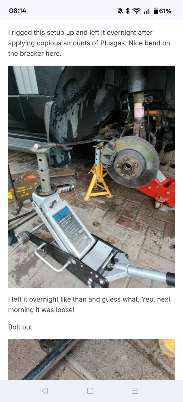

Edit: lower strut pinch bolts can be a twat to remove. Air hammer or heat + sledgehammer are both ways around the issue, buy new bolts and very slightly ream the holes in the upright to prevent them seizing again.
I also had a little grief with the bottom pinch bolt. I just used a breaker bar to get the bolt spinning and eventually that freed it up. I suspect heat wouldnt harm also
I would echo the above , had the same happen to mine, I fitted a Dunlop full strut assembly, which I think was about £300. It was a pretty easy job, other than the pinch bolts which even my big bastard electric ugga dugga gun wouldn’t shift (they looked horrendous so I tried these first). I ended up soaking them in plus gas for a week, then trying again and they relented.
Here's my technique for getting the strut bolts out. Good luck!
