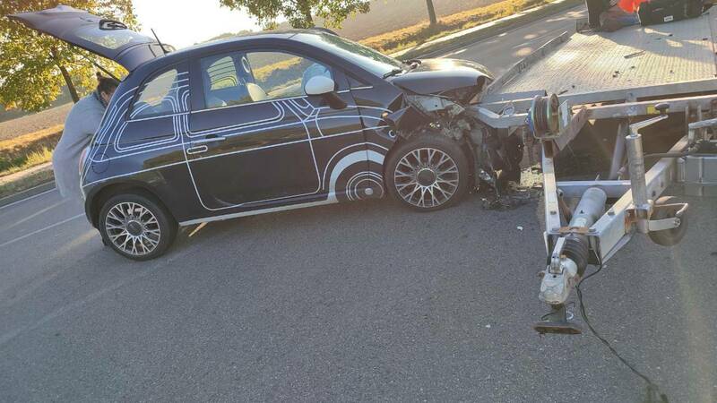

The E39 might be briefly in the evening news today as there was a crash on the way back from collecting my front wing.
The bmw driver told me he had a blowout with the cruise set to 200. Seems like everyone is mostly fine. I really only saw a cloud of dust from the distance.
