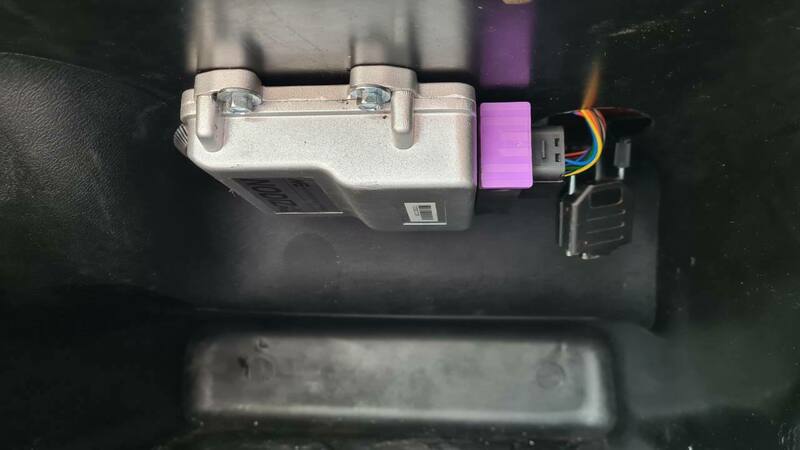

fordperv Posted July 24, 2022 Author Share Posted July 24, 2022 While there's been radio silence I've been chipping away at the old girl, she is now a runner thanks to a nodiz gen X ecu and a new bosch crank sensor, i was having an issue with the other ecu which was out of warranty, it wasn't recognising a crank sensor on vauxhall trigger pattern, I tried numerous crank sensors, sutty2006 kindly let me borrow his crank sensor which was the correct VR type but still no joy, i sent it away to get tested they could find no fault it fired correctly on the test rig, it had us baffled the only thing came up with if the signal wasnt clean enough so it was saying computer says no, the kind chap at the manufacturer offered me a good discount on the gen X which has a diagnostic function and a better software on the laptop to set it up so would show up any issues and it would have warranty also gives me access to support if any issues arise, it was a nice and easy with no fuss installation and it fired up, since the video I have messed about with the carbs as the air valves had been blocked and it was overfuelling like a bitch so now runs a little more even, I suspect there's a little air leak through the silicone hose between the carbs and manifold as the flouro lining is damaged on a couple of them so I will get some ordered up so I can balance the carbs and set the fuelling. 20220720_215750.mp4 getting the car running showed the radiator was no where near man enough for the C20XE so ordered up an alloy rad from ebay, the delivery was speedy, initially they sent me the thinner one when I had ordered the thickest core diameter they list but they soon sent me out the correct one and collected the wrong one A little difference in diameter looks well in the engine bay, a small modification was required with the grinder to fit but nothing major i also fitted the electric cooling fan and wired it up, got a choke cable and installed it in the original dash blank grabbed a grommet for the wiring and installed the ecu in the glovebox so it's all tidy UltraWomble, Low Horatio gearbox, JeeExEll and 16 others 19 Link to comment Share on other sites More sharing options...
