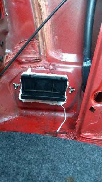

willswitchengage Posted January 1, 2021 Author Share Posted January 1, 2021 Today I have celebrated Brexit by attempting to seal up the Rover's errant leaky water vents (as recommended by 1,000 threads on the R200 forum), then discovered there is another source of water above them that remains totally elusive. I have also tried and failed to remove the stupid cigarette packet holder 'option' in the dashboard. A bright start to 2021. The Moog, Justwatching, spartacus and 1 other 4 Link to comment Share on other sites More sharing options...
vulgalour Posted January 1, 2021 Share Posted January 1, 2021 Now you've done the vents, other points of ingress are the rear window seals, rear light gaskets, tired tailgate seal, rubber wiring 'caterpillar' thing at the top of the tailgate, spoiler mounting points, rear number plate/trim panel screw holes, tailgate hinges (there's a gasket between the hinge and body sometimes, they fail). I can't remember any other leak points off the top of my head right now. TADTS and Heritage and all that. spartacus 1 Link to comment Share on other sites More sharing options...

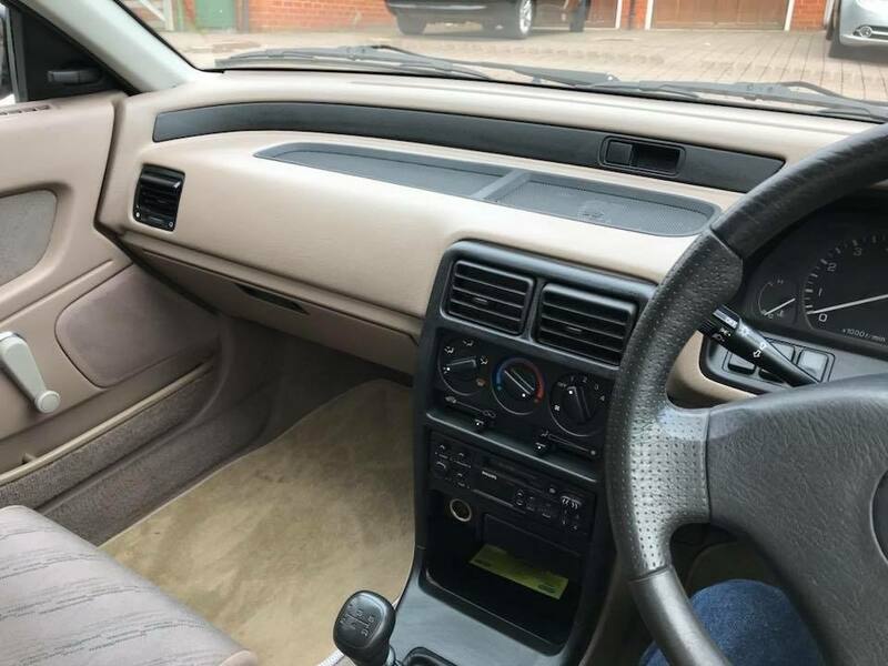

willswitchengage Posted January 2, 2021 Author Share Posted January 2, 2021 This Google image has it This one does not Bottom of the centre console, an insert that appears to fit a few fag packets but is annoyingly too small for a wallet/smartphone. I'm trying to remove it. Will go to full dashboard disassembly when it's stopped snowing... Link to comment Share on other sites More sharing options...
Shite Ron Posted January 2, 2021 Share Posted January 2, 2021 Is it not a cassette holder? Link to comment Share on other sites More sharing options...
Shep Shepherd Posted January 2, 2021 Share Posted January 2, 2021 That's a cassette holder. I found it quite handy when I owned my 1994 214Si back in the early 2000s, but unless you are a total hipster, it's pretty useless nowadays. Link to comment Share on other sites More sharing options...
vulgalour Posted January 2, 2021 Share Posted January 2, 2021 I'm a total hipster and used the one in my R8 saloon, still found it to be annoying though because it stores the cassettes end on so you can't see which is which until you pull them out. I'd expect the insert to just clip in, so you can probably prise it out and then shave off the cassette holder bits so it becomes just a plain box. Shep Shepherd 1 Link to comment Share on other sites More sharing options...
Shep Shepherd Posted January 2, 2021 Share Posted January 2, 2021 Just now, vulgalour said: I'm a total hipster and used the one in my R8 saloon, still found it to be annoying though because it stores the cassettes end on so you can't see which is which until you pull them out. I'd expect the insert to just clip in, so you can probably prise it out and then shave off the cassette holder bits so it becomes just a plain box. Haha! I too would very often select the wrong cassette due to the way they fitted into the holder. The arrangement was still better than having to store cassettes in the centre console box or in the glovebox like I had/have to do with The Volvo, though. Link to comment Share on other sites More sharing options...
Ghosty Posted January 2, 2021 Share Posted January 2, 2021 Yeah, tape holder. Can't remember how you get it out. Think it's only late cars that have it but don't quote me. Link to comment Share on other sites More sharing options...

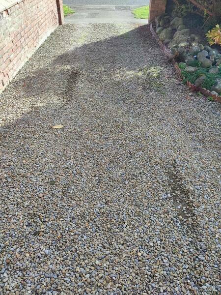

willswitchengage Posted October 15, 2022 Author Share Posted October 15, 2022 Currently giving the 2CV its periodic once-over. Including driving it up and down the road, thrashing it, brake test etc. This is interesting: And was the result of me locking the brakes on the driveway. I only assume one circuit is working more effectively than the other for some reason? I seem to remember brakes are plumbed diagonally but am no expert. The car was MOTd only a few months ago, but is otherwise fine. Car not pulling to one side or anything. Dyslexic Viking and tooSavvy 2 Link to comment Share on other sites More sharing options...
