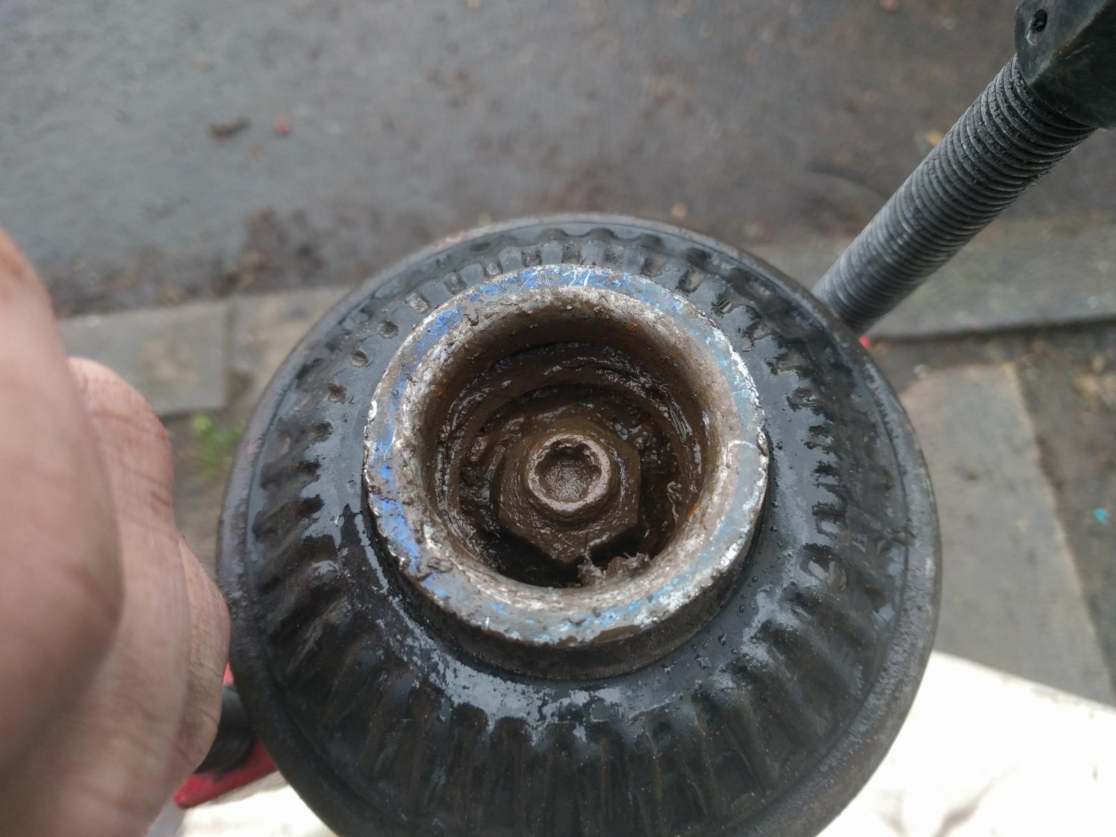

I don't think I can do it, the top strut fixing is too rusty, and I don't have a spanner deep enough to hold the nut and get a torx on the top. Holding the top cap and turning the bolt just results in rubbery noises...
Any ideas?
Pair of used struts is your easiest and cheapest way out of that . Or impact tools and patience
You need a box spanner and torx down the middle.
Or long socket held with stilsons, or a bar welded on the socket so you can get the a torx down the 1/2" drive hole.

Good thoughts guys, and I tried all of that! Waterpump pliers around the top metal bit - no dice. Lambda sensor socket and a torx down the middle and 2 feet bracing various stuff - no dice.

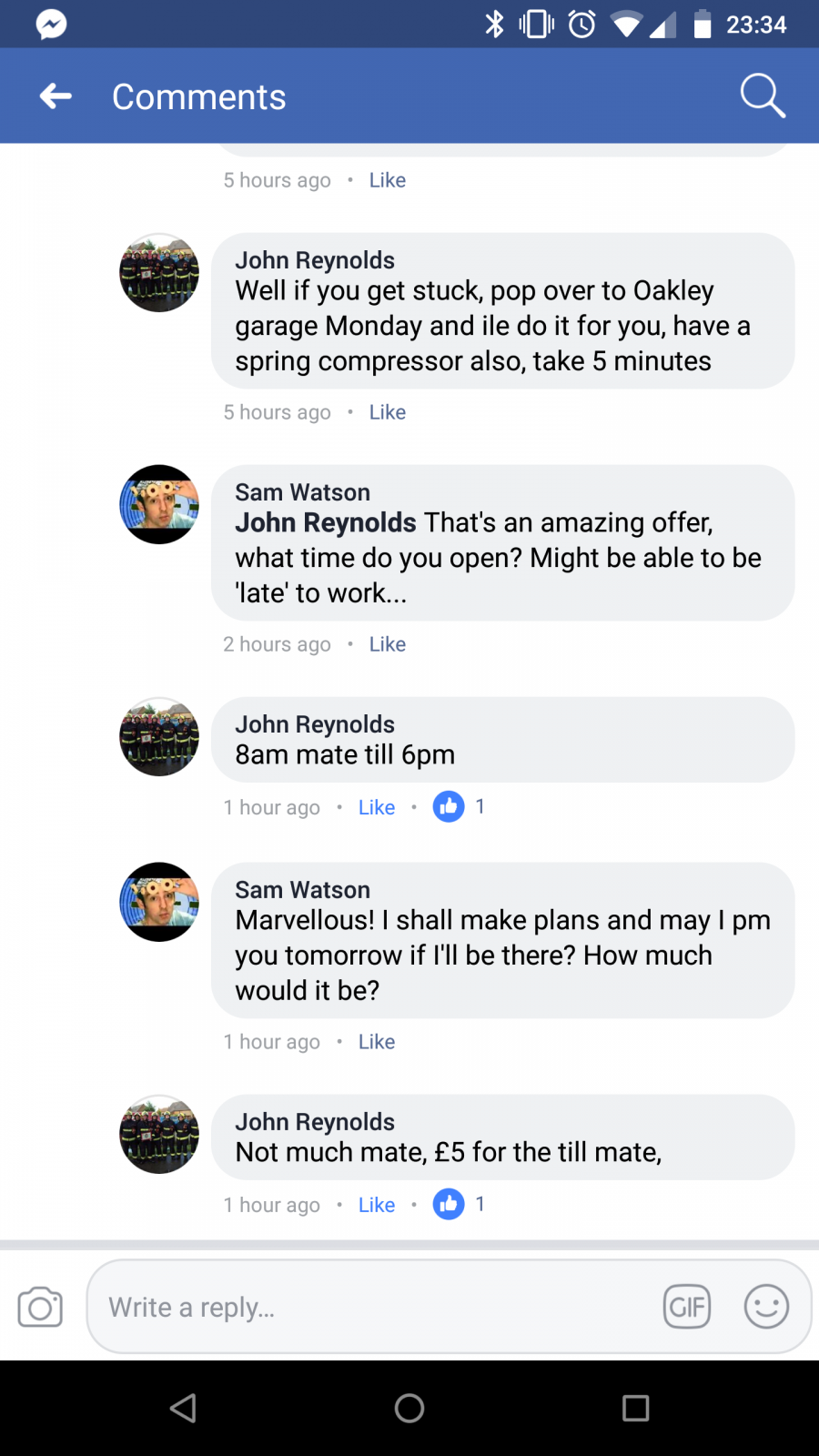

That makes deep sense to me... Someone who works at a local garage said run them over next week and they'll see what they can do, and apparently Amy knows the guy quite well (and he's mutual friends with her sisters too) so I've sent him a message, if I can blag a day off work I can have them off and over in about half an hour
Another trick is to drill down the nut on one side and split it with a thin narrow chisel.
But put the spring clamps on and leave the strut on the car in case something lets go besides the nut.
Oh you need new nuts as well. Maybe 4!

Problem hopefully solved! Will get them both off tomorrow afternoon and mosey on over Monday morning! I think Amy has been feed a loan car from her friend (husband is a driving instructor who has 2) so it can sit on stands for a day or so

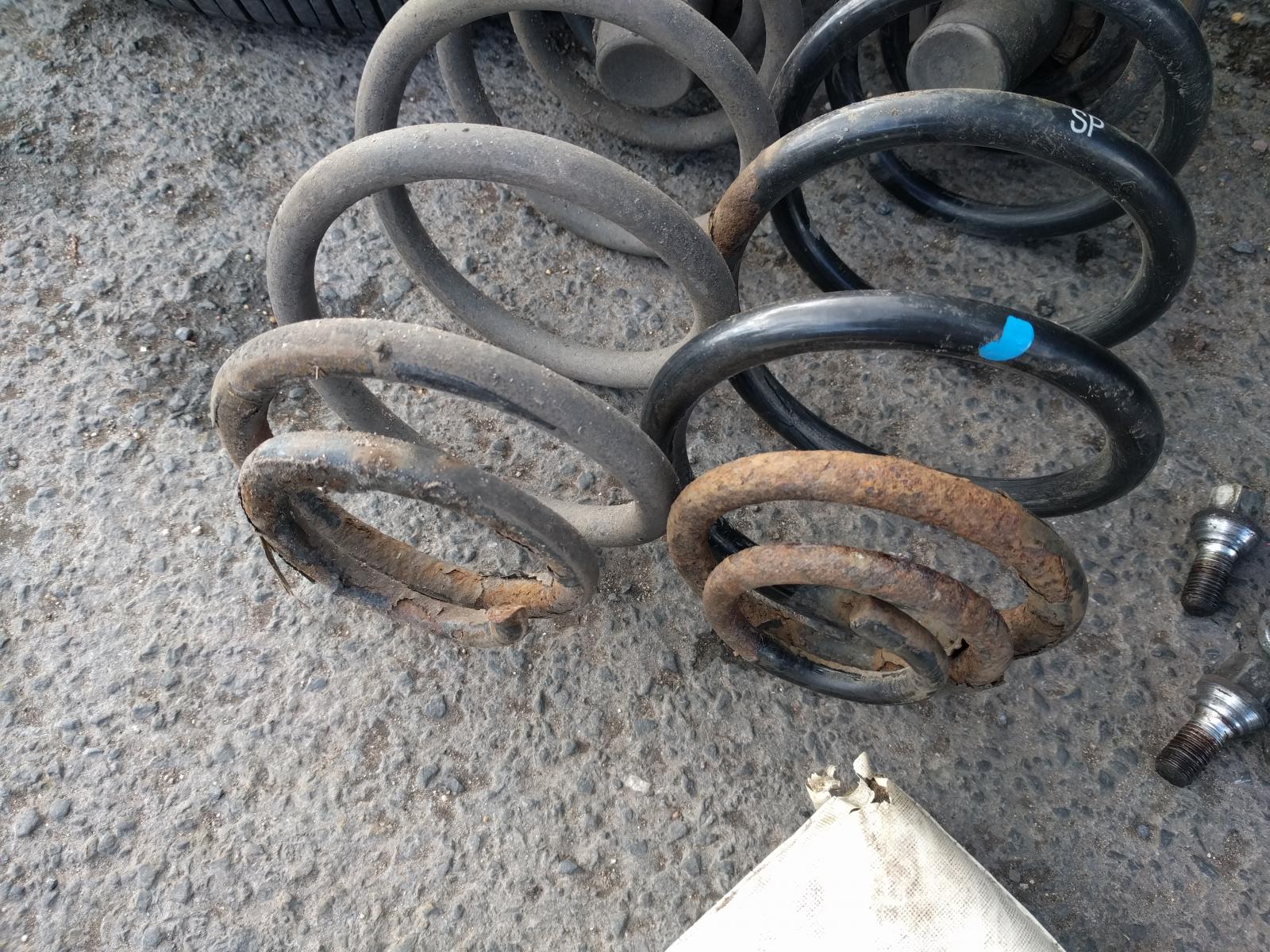

Also did the rear springs, and one was indeed a bit poorly
Ah there's the broken bit!
