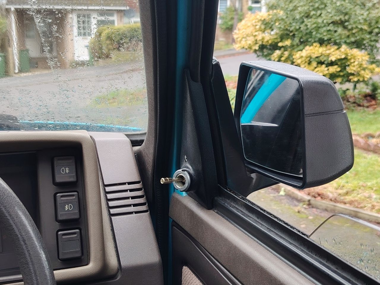

The duct tape was doing such a good job I left it alone but finally decided to bite the bullet and buy a new pair from CZ.
They were only £25 each but are made of Chineseum so it's a bit of a gamble, let's see what happens.

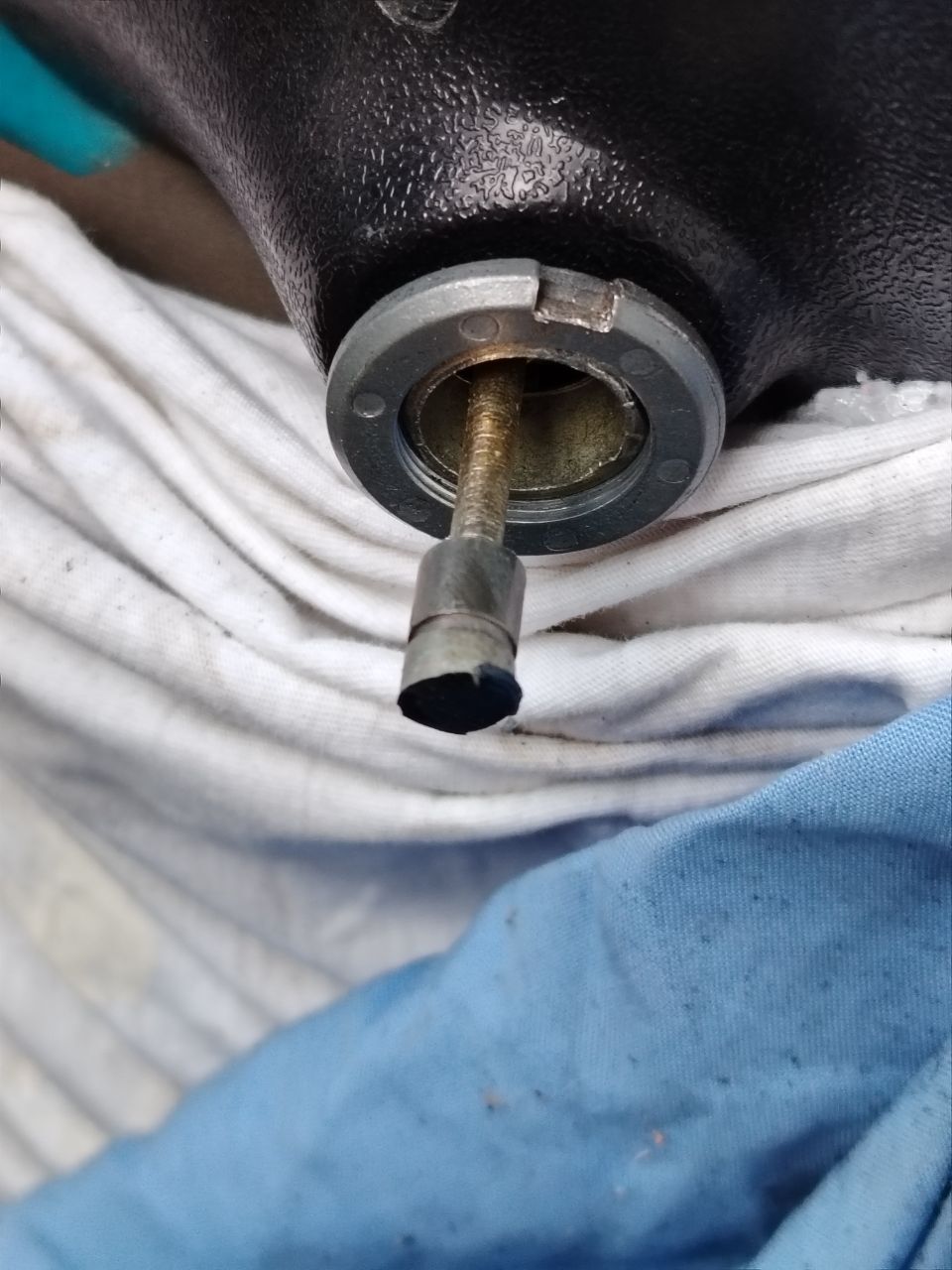

First thing I noticed is that on the original Škoda mirror the three cables are wrapped in a plastic sheath whereas these are bare.
More noticeable underneath.

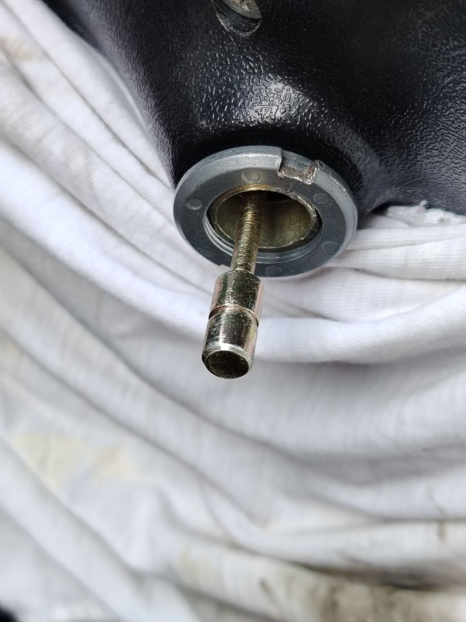

And the thread here was rather messy meaning the locating ring that screws on to it would only go so far. I tried cleaning it up but to no avail. Fortunately this was only on the one mirror.

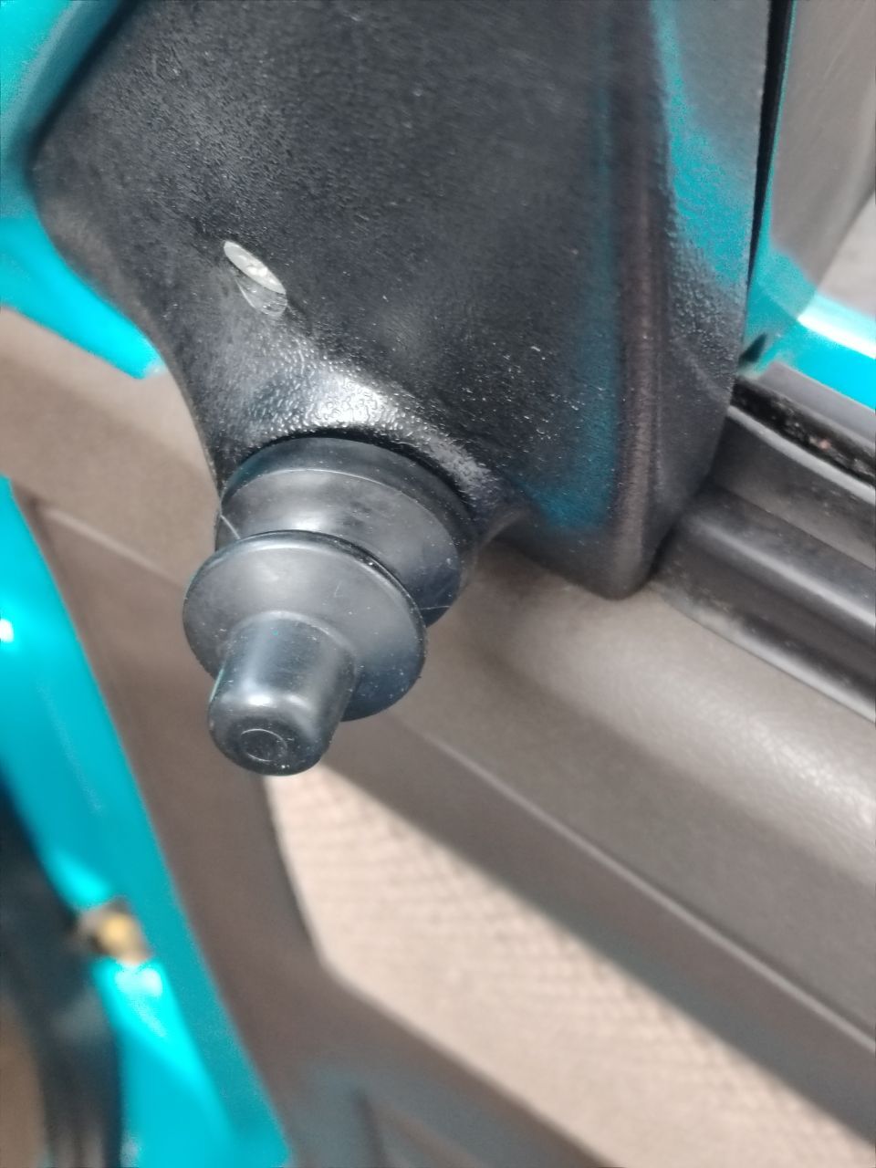

And then when I fitted them I noticed the adjusting toggle is slightly longer so the rubber grommet won't locate properly, so I need to shorten those.
Then, best of all, when I tried adjusting the mirrors, well the toggle does adjust them but not in the direction you move it. It appears to be completely random. I just had to laugh at that point. So, so far, exactly what you'd expect from cheap Chinese shit.
BUT! And it is a big but that warrants both capitals and an exclamation mark, the mirrors fold in like they are supposed to.
None of the original Škoda mirrors do this anymore as they have seized solid. The two parts of the pivot are made of different metals that react with each other and fuse together. This is the whole reason I needed a new mirror in the first place. As I said before I just clipped wing mirrors gently with another car quite slowly and it just snapped off. I doubt any original Favorit mirror has been able to this for about 25 years.
But mine does.
Look, powerfold mirrors. With my hands providing the power.
Of course, I've no idea how long they'll stay like this, they might seize up just as quickly as the originals so I need to remember to fold them in on a regular basis to keep them supple.
