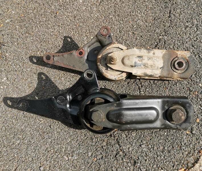

So I've had the new Fav a week now, so do I regret it? I must admit I was beginning to before I actually picked it up. During the day I was convincing myself it was a good idea but I was laying in bed at night thinking what have I done and praying somebody would outbid me. And then in the morning I'd calm down again and hope I'd win it again.

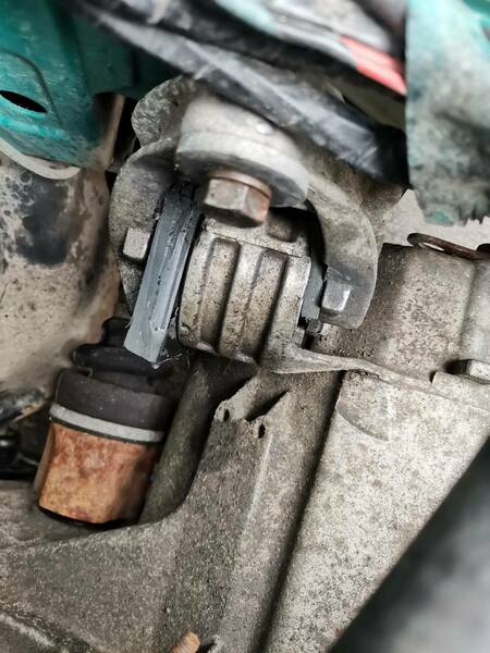

Driving home it was obvious it needed some work, mainly there were any number of clonks and rattles underneath which I have been slowly working my way through. First thing I found was this lifting eye (?) on the end of the gearbox.
You can clearly see a scuff mark on the chassis leg above it. So I simply loosened the bolt swivelled the eye round and tightened it up again. This helped but the big clonk was still there and its fairly obvious that if it is moving that much there must be a problem with the engine mount.
Seen here alongside the eye. But there is also another mount underneath. I had recently replaced it on the Felicia so I took it off again. This is the two together.
IMG_20220422_155723_edit_260635250318562.thumb.jpg.fa631d9d7c9551b2fdb24804cf9887dc.jpg
The old one is solid but quite obviously elderly, and actually has an Audi logo moulded in to the rubber, but seemed OK. I had to remove it to see the small end which also has a bush in but it's not visible with it in place. But really there was no problem there.
So back the top mount. The rubber looked OK but is probably a bit soft. And the whole design is probably not up to the extra power. In fact it was modified on the Felicia, even the 1.3. It looks like this.
IMG_20220424_152332_edit_309667133333476.thumb.jpg.0f8b5b7badbfe0d82c1dc9fb89c384ee.jpg
The square bit you can see is a bit of raised aluminium cast in to the gearbox housing. Then in the bracket that surrounds it you can just see two bits of rubber so as the engine rocks sideways the the square casting bumps into the rubber thus stopping it moving any further. That is attached to a new bracket spot welded to the chassis leg but the same round rubber mount is underneath.
So I found a bit of rubber and wedged it between the two parts of the mounting.
Which I think can be officially called a bodge but it did the trick. No more clonk. So I have ordered a sheet of thinner, 6mm, rubber and will cut out some big washers, slide the bolt out and put one either side so there can still be a bit of movement but the rubber will stop the two metal bits clashing.

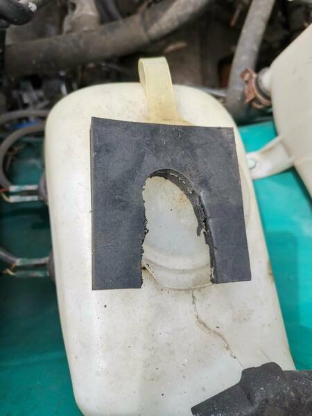

Elsewhere I found these rusty marks under the bonnet.
IMG_20220424_135852_edit_308797694581005.thumb.jpg.69344038dbdd34f1bb0997a9e3d1df26.jpg
With corresponding rusty marks on the strut brace. So some self adhesive foam rubber on the strut brace and you can already see the impression the bonnet has made.

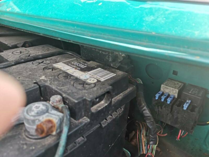

I also found the ECU. It is tucked away behind the battery. Just visible here.
It was just a case of following the wires really. Quite a neat place

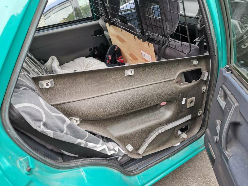

In other news it is now designated dog car to replace Felicia. Now Chieveley travels quite well, he's happy to sit there looking out the window, then have a bit of a lie down, then get up and have another look about. But he gets impatient when we stop and don't immediately get out, he doesn't understand the concept of traffic lights. Then he starts wacking the door trims with his not inconsiderable feet and has put some big scratches in the door trims. I don't want him doing it to the new car so I have taken the door trims off the Felicia and overlayed them in the Fav. They fit quite well seeing as they are essentially the same door.
IMG_20220428_112849_edit_36481826494433.thumb.jpg.a3340747891f1d9c31720eb4075e6961.jpg
So I put him in, put the door trim here and shut the door.

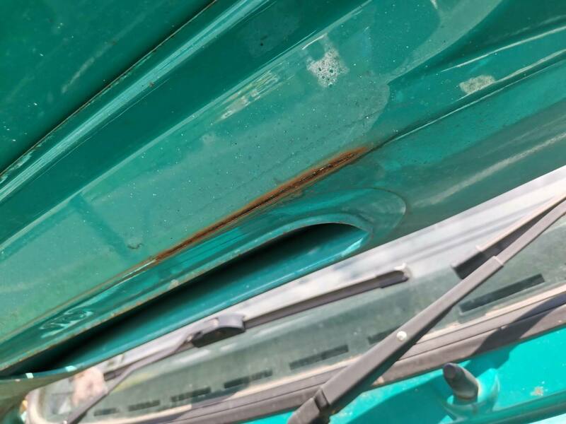

I have literally just noticed, whilst proof reading this that the rear wipers point opposite ways. That's another difference between the mk1 and mk2 that I didn't know about. There is almost nothing interchangeable on these two cars.
Link to comment
Share on other sites
The offside one is. The nearside one has a little rust just in front of the wheel above the bumper where they usually go but it might not have gone through. I don't actually know I was making a point of not poking it while it was still in use. Are you interested?

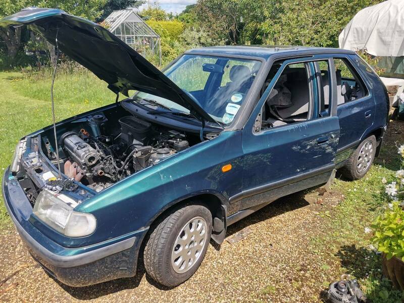

Been round my friends stripping more bits off the Felicia. She looks a bit sad now, definitely past the point of no return.
Some interesting stuff keeping it company.
Yes, he's a VAG man but there's not a pineapple in sight. The Audi 80 and A2 are bog standard the T2 is a bit lower and has some period alloys on but that's it. And I have to say the ride quality is brilliant, it really is smooth. Its a day van not a camper and I have to begrudgingly admit it is a nice place to both sit in and travel. There's a V8 Morgan sitting in the other corner too.
He lives in a village on the edge of the New Forest where everybody knows each other. He was attempting to wash the 80 while I was stripping Felicia. First an old boy trundled up in an Austin 7 for a chat. Then somebody else arrived in an Omega (bit more Autoshite) with a stash of original Trico stainless steel wiper blade arms that he'd found somewhere. Then a third guy turned up in a modern but apparently he owns a TR6. It's like that all the time round there.

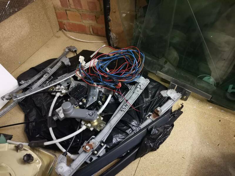

Now I am obsessed with the electric windows on the Felly as they are so rare and was determined to remove them in their entirety and intact. I finally did it but the car looked like this by the time I'd finished.
I am hoping to eventually fit them to the green Favorit but I will certainly simplify the routing. Though one of the things I had to remove was the seat belt pre tensioners because the plug that plugs in to the motors wouldn't fit through a hole they shared. That won't be a problem on the Fav.
So this is the whole loom spread out in the loft.
The thick blue black wires go in to the doors and attach to the motors. The thin red wire on the left ends in a white plug that takes a standard four pin relay (which is currently still attached to the car as I couldn't reach the self tapper that attached it to the bulkhead but I will get it). Two of the wires coming out of the relay went to the fusebox. They are the only wires I cut as they went in to terminal blocks shared with many other wires.
The switch pack has a few extra wires as they light up but it's all self contained. This sits in the centre console.
The long brown wire on the left went to an earthing point on the steering column but it could be earthed anywhere. And that's it. Just about the simplest electric window system possible.
The whole lot, windows, mechanisms and loom are now carefully marked up and sitting in their own corner of the loft.

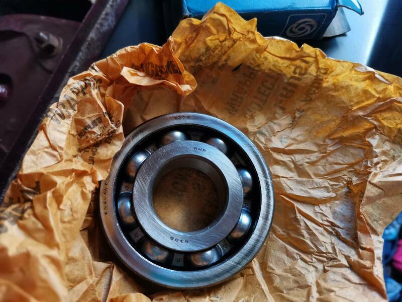

So I ignored the Felicia today and had a go at the Triumph which has a poorly sounding gearbox. I had already stripped out the carpets and parcel shelf. Then there is a big rectangular tin plate in the bulkhead that gives access to the back of the gearbox.
I had already removed the input shaft by the time I remembered to take any pictures.
I was hoping this bearing at the top was the culprit as it sounded noisier at the top.
Also I have a brand new one.
In a nice British Leyland box
Close up. But to remove it I have to take the back off the gearbox.
Which involves putting a trolley jack under the engine/gearbox, jacking it up enough to get rear engine mount out and then it's just about ten half inch bolts around the outside. And you have this.
That bearing is a push fit in to the centre plate. There are some bits of selector fork that unclip then you screw a slide hammer in to a hole in the centre plate to tap it out but before I got to that I thought I'd clean the back plate up a bit.

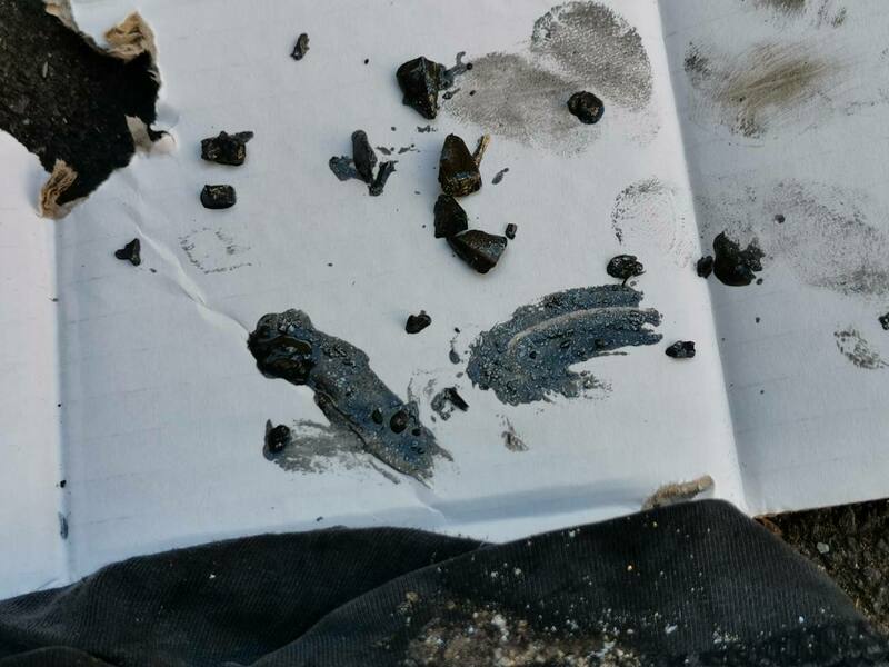

That's when I found these bits.
Well that's fucked then. That's bits of teeth and notice the metallic grease on the rag at the bottom of the picture. That's in the oil. So even if I find the offending gear the the whole box will need stripping and cleaning. New gearbox time then. We'll, not new but I have a spare one, although it is currently stored in a friends unit but I think I'll be giving him a ring.

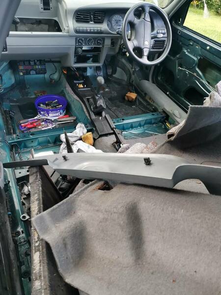

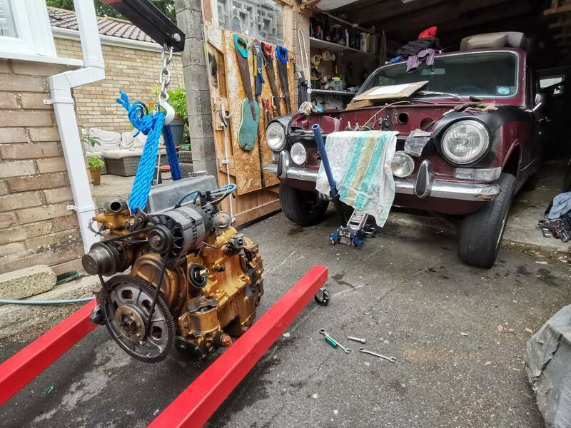

So I removed all the seats in blue Favorit, or all bar the drivers seat if we're being pedantic, and filled it with as much flat and soft material as possible so something must be going on.
As mentioned a couple of weeks back the Triumphs gearbox is dead and a friend of mine was looking after my spare gearbox. He took it in nine years ago when I was moving house and I was trying to get as much stuff out of the way beforehand as you really don't want to be lugging shit like that around on moving day itself.
I have mentioned it several times over the years but he said it wasn't in the way. He does have a nice big unit, big enough for four cars so I thought I'd let him look after it. Well now it's time to go and get it back. He also has an engine crane he said I could borrow which is handy. This is why the front passenger seat had to come out too.
Hence one gearbox and one engine crane.
And the view from the drivers seat.
Perfectly safe*. We used the seatbelt and some big cable ties to keep it steady but even so I was cornering very gingerly. But its only ten minutes away so not too bad.
A Triumph 1300 gearbox is just about the heaviest thing I can lift on my own but even then only for very short periods. This is the sole reason I own this set of sack trucks.
Even then they had been sat outside since 2015 which was the last time I had the engine out and the wheels were seized solid so before I went and picked the gearbox up I had to strip the wheels off it and clean up and grease the axles, which are actually just bits of tubing.

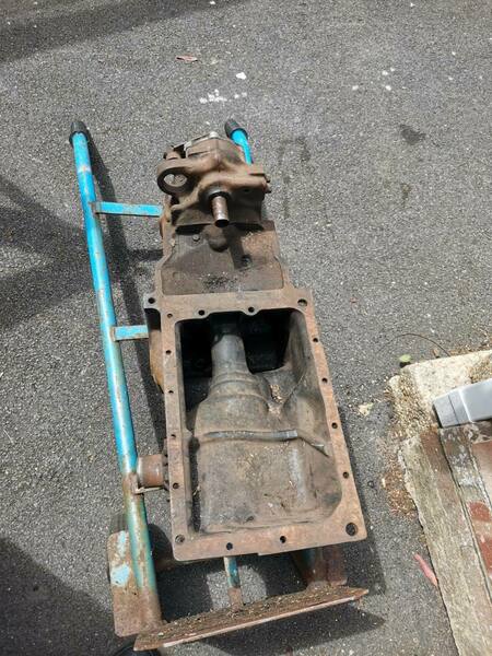

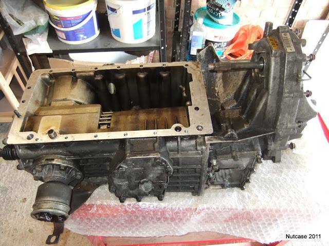

Anatomy of a Triumph front wheel drive gearbox if anybody is interested. It's a big bugger as I already mentioned. Unlike the BMC FWD stuff it has separate fluids for engine, gears and diff.
The gears are on the left in this picture and the diff on the right. The big rectangular hole is where the engine sits so that is effectively the sump. And the little tube on the left carries the clutch release bearing.
The clutch itself sits on this shaft, that's where the back of the engine sits.
And if I slide the other end of the shaft out you'll see these splines. These carry all 75 bhp down to the gears themselves. And if they look feeble, this is the uprated 1500 version. They're about 30% shorter on an original 1300 box and would quite regularly strip their splines.
From above you can see this big tube running through the sump. This carries the main shaft from gearbox to diff so the sump is effectively just those two holes either side of the tube.
And all of this is cast iron so you can see why the bloody thing is so ridiculously heavy. Look on the bright side I guess it helps the centre of gravity.
Here I have test fitted a gear stick just to see if it still selects gears. That is all there is, no other linkages so as long as you fit new bushes in the base of the lever it is a lovely slick gear change. That's the extent of my testing. I could strip it down and check all the gears but this is the only box I have so I don't really have any other options so I may as well bung it in and see.
Gearboxes are supposedly filled for life, though I don't think life was expected to be 53 years. So there is no drain plug, you have to tip the gearbox on its side and pour it out of the filling hole. On filling you just keep putting it in until you reach the level of the filler hole. The old oil was still a lovely golden colour unlike the black stuff that came out of my other box so I'm hoping for the best.

Then refitting is the reverse of removal. So the engine and new box are now back in the hole and all* I have to do is join everything back up again. I forgot to take more pictures as I had a deadline in that we had a load of washing in and I needed to get the car back in the garage before the washing finished as I was doing this work under the washing line!
But here it is all tucked away back in the garage. I still need to realign it to get the engine mounts to line up but the worst is done now and the major potential for mishap hasn't happened so I I feel a lot more relaxed.
Chieveley was in his usual spot.
Until I put everything away. Then moved to gaurd the garage doors for me.

I was talking to @Andyrew the other day, mainly Škodachat but the subject of this gearbox swap came up. The main question was why? Why did Triumph do it like this? My theory is the Mini and then ADO16 had just been released and Triumph wanted some of the FWD action as it looked like the future. But how to do it quickly as possible using as many stock parts. So it had to have the Herald/Spitfire engine and the gearbox internals also have some common parts with the Herald. But that engine was never going to fit sideways in this upcoming saloon so it had to be in line. And this is what they came up with.
To be honest it is all a bit Heath Robinson and is the weak point in the whole car. Whilst chatting I remembered that years ago I heard Saab actually based their gearbox for the 99 on this contraption but developed it so it worked. They did the same with the engine of course. Early 99 engines are a direct copy (under licence, they didn't just steal it) of the Dolomite 1850 slant 4 but again Saab developed it over the years and later ones look rather different. Their 16v had twin cams unlike the Dolomite Sprint.

Diff end on the Triumph. IMG_20220708_103615.thumb.jpg.af2be779c59bf1e3c69d92173131cc9e.jpg
And the Saab
The most notable thing, to me at least, is that it appears to be aluminium so it is probably quite easy to manhandle.
Input shaft on the Triumph
And Saab
Though the Saab uses a big triplex chain to get power from the shaft to the gears...
Whereas the Triumph has a series of gears.
But the biggest difference is that Saab install it the other way round so that the clutch is at the front. In this respect I think triumph got it right as most of the weight is behind the front axle and whilst the clutch is at the back it is still easily accessible from the engine bay.
This sums up Leyland stuff really. They came up with loads of good ideas and were technologically miles ahead of Ford and Vauxhaul but never devoloped anything properly. Any flaws that made it through to production stayed in production for the duration of the model. Just my observations anyway.
