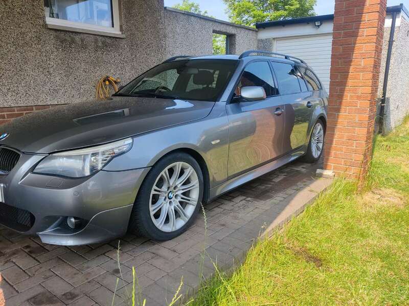

dome Posted March 10, 2023 Author Share Posted March 10, 2023 So, as you may have seen from my collection thread I picked up the Rangeys replacement last weekend -a 2008 BMW 530D MSport touring auto. Here's some pics from the ad. It's got the M57 engine which had 230bhp as standard, this one has been remapped to 272 though (same as a 535d). It goes well 😳 It's on 160k but has full history and the guy I got it from has had it since 2016. It's a nice spec and drives well but I wanted to do some fettling before it was pressed into service. First up, some cosmetics. The number plates were the only advisory on the MOT it has just passed the day I viewed it so new ones were ordered up. Old New. I'm going to relocate the rear, it's too high 🙄 The centre caps were also knackered, £10 to eBay sorted that. As it'll have a bike and/or dog in it most of the time a boot liner was required, I scored a genuine one locally. And it is due a service so Opie were called upon. sdkrc, yes oui si, AnnoyingPentium and 13 others 16 Link to comment Share on other sites More sharing options...

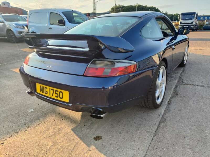

dome Posted June 23, 2023 Author Share Posted June 23, 2023 Well, I've not bought a car for a while. This one isn't very autoshite, although it's 23 years old and is leaking fluids from various places. Location: Dundee #prayfordome PC 2 and highly likely to increase ETA around 3pm djim, The Moog, loserone and 7 others 9 1 Link to comment Share on other sites More sharing options...
