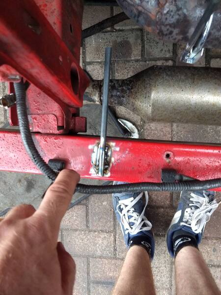

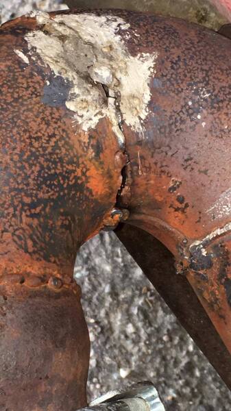

dome Posted May 29, 2019 Author Share Posted May 29, 2019 Well we're at 200 gentle* miles now and all is well so far. Apart from this That's the centre section of the corolla box which is now our silencer. A victim of me working out how to hang the exhaust (answer: better than it is currently). To be fair it was pretty rotten at that point. I chopped the end off and welded on a new section I fashioned off an old part of S4 exhaust. It's back on and has a better but still temporary hanger arrangement. I also refitted the MR2 heat shield which has made a big difference to the temps It'll need to come off again to seal up some pinhole leaks and clean up my welding, I've got a powerflex mount here to fit too and will get a new manifold gasket as ours is a bit shonky. Just arrived at Scotoshite in it. It's fecking sketchy out-hit lift and it lights up the tyres. That may be more amusing when it's not rush hour traffic. The alignment desperately needs sorted too, it's twitchy at the front end. Getting there though. LightBulbFun, nacho man, djim and 4 others 7 Link to comment Share on other sites More sharing options...

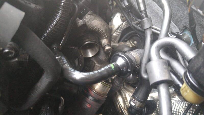

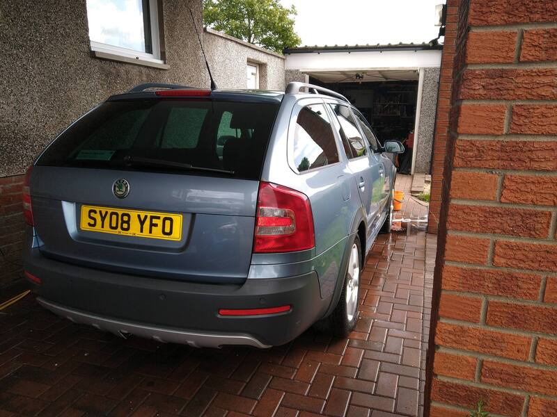

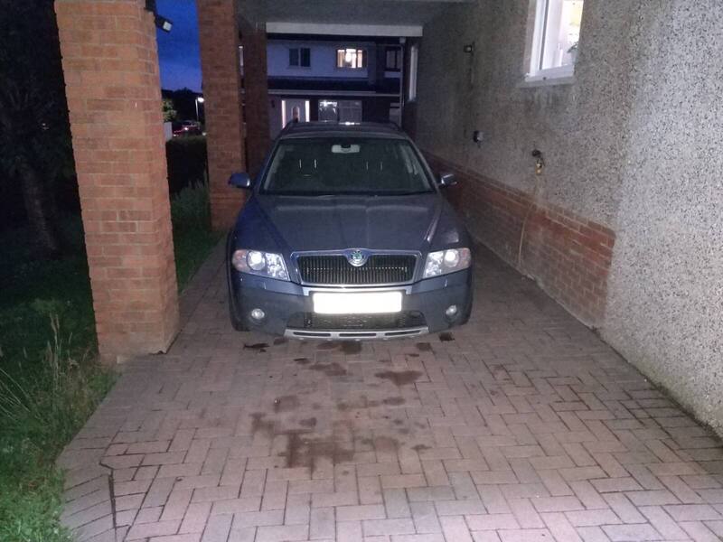

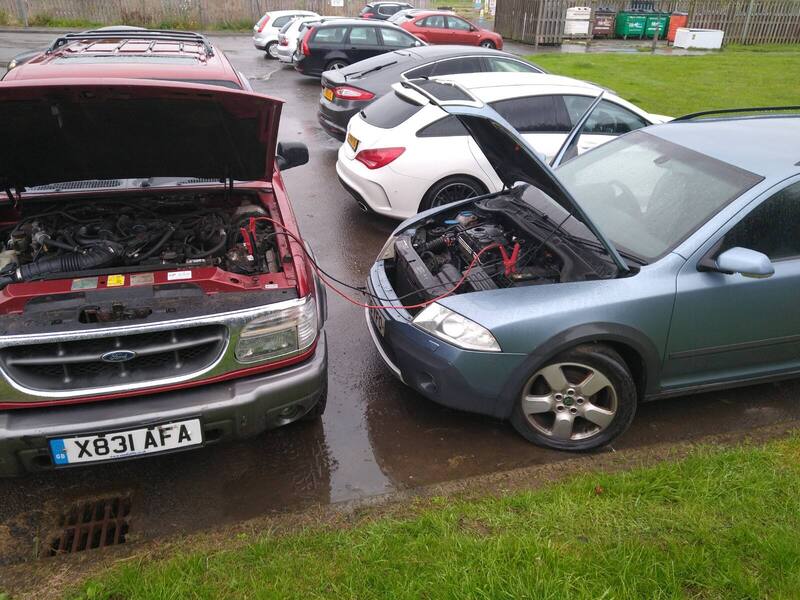

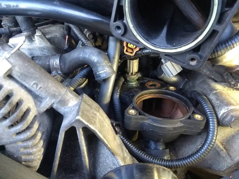

dome Posted June 2, 2019 Author Share Posted June 2, 2019 So, I'll get to MR2zz shennagins later. The Exploder was requiring some attention. It still had a bent caliper carrier and I had a new set of pads for it. I also had bought a pair of timing chain tensioners for it and the idle was a bit high. Last Monday, this was the site at dome mansions Brakes went well, the new caliper carrier was fitted and the old pads. Well, this picture tells a story Onto the tensioners and there's 2. One is on the back of the right hand head and is easily accessed by removing a wheel and going in through the removable arch liner. The other one, not so easy. It's on the front of the LHS head and handily* has the thermostat in the way. I watched a few redneck YouTube videos and learned that The thermostat is in the way of the tensioner The inlet manifold is in the way of the thermostat Fuxake Ah well, here goes nothing... Further in, EGR had to be removed from the inlet to get access Tensioner is just visible below that cable, a 27mm socket takes it off The new tensioner in place, you can see the extended body on this one, it's an upgraded part. Both tensioners have to be primed by sticking them in oil and compressing them til they firm up. Oo err. Both old ones were tested and were fucked so this was a worthwhile enterprise. Kringle, The Moog and djim 3 Link to comment Share on other sites More sharing options...

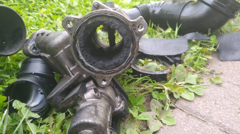

dome Posted June 3, 2019 Author Share Posted June 3, 2019 The Exploder got left til yesterday as smoll red cars were taking priority but I got it stuck back together. It ran shite at first as the EGR valve had a leak, i fixed this and took it a spin. Whilst fixing it I noticed that the EGR valve had been blanked off, this probably explains why the inlet was pretty clean Brakes are a lot better, engine is quieter and the idle is better. Win! The Moog, Tickman and Kringle 3 Link to comment Share on other sites More sharing options...

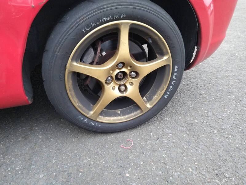

gm Posted June 3, 2019 Share Posted June 3, 2019 do you have any videos of the mr2 on track ? I bet it sounded great, especially with the missing backbox. those tyres look like you've had your moneys worth out of them, I presume they were part worns before you started ? Link to comment Share on other sites More sharing options...
dome Posted June 3, 2019 Author Share Posted June 3, 2019 1 hour ago, gm said: do you have any videos of the mr2 on track ? I bet it sounded great, especially with the missing backbox. those tyres look like you've had your moneys worth out of them, I presume they were part worns before you started ? Here's a vid that Duncan's mate shouldn't have been filming (hence the black flag at the end). It sounds better with the back box on to be honest. Duncan driving here. The tyres were very cheap from a mate so yes, have seen better days. I don't think we troubled them much so we might get another track day out of them. They felt good though so were a good investment. Dick Longbridge 1 Link to comment Share on other sites More sharing options...

dome Posted June 3, 2019 Author Share Posted June 3, 2019 Went home via Duncan's to check over the MR2 tonight after Saturdays shenanigans. Oil level ok, coolant too. Brakes ok and not too worn, proof we're not trying hard enough. Here's the exhaust after getting launched across the track at 70 odd mph oops. still, my weld on the tailpipe held up... I put it back on just now with a coke can cut up to help space things out-its just a bit too loose where it sleeves into the system. And back on road wheels. I actually prefer the gold now... The Moog 1 Link to comment Share on other sites More sharing options...

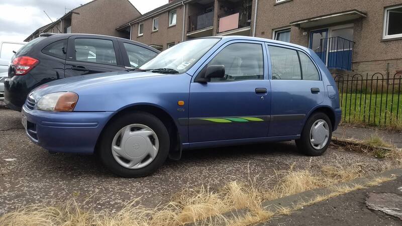

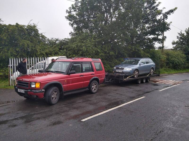

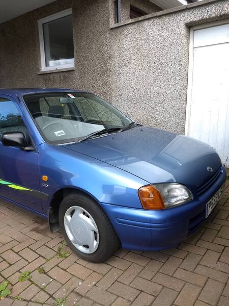

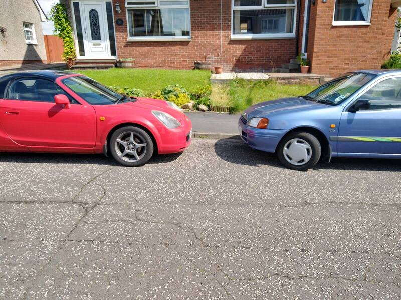

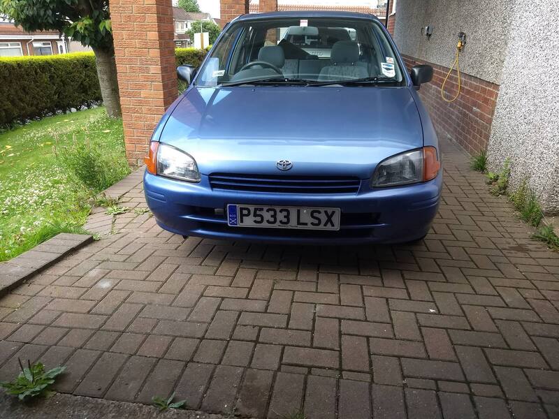

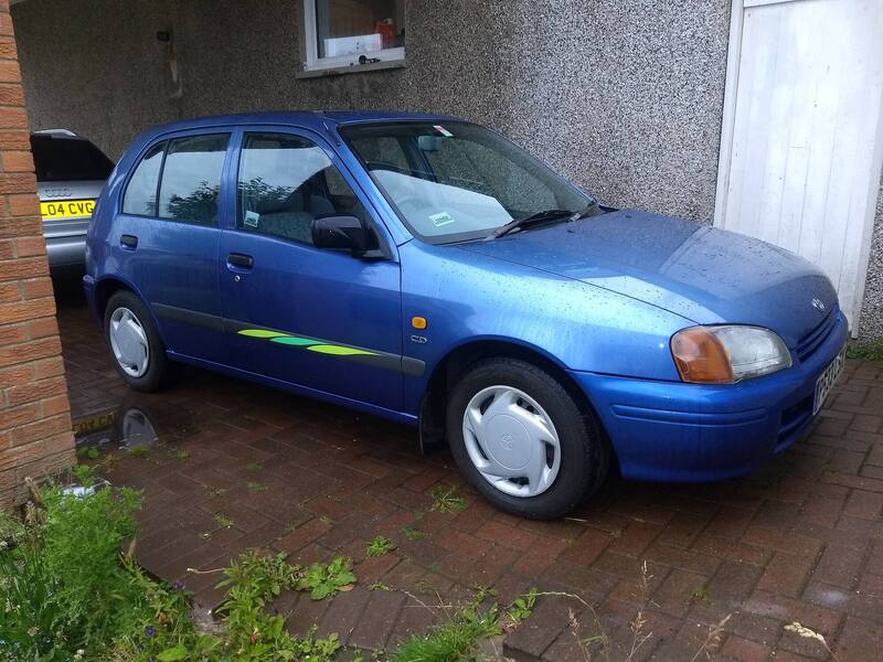

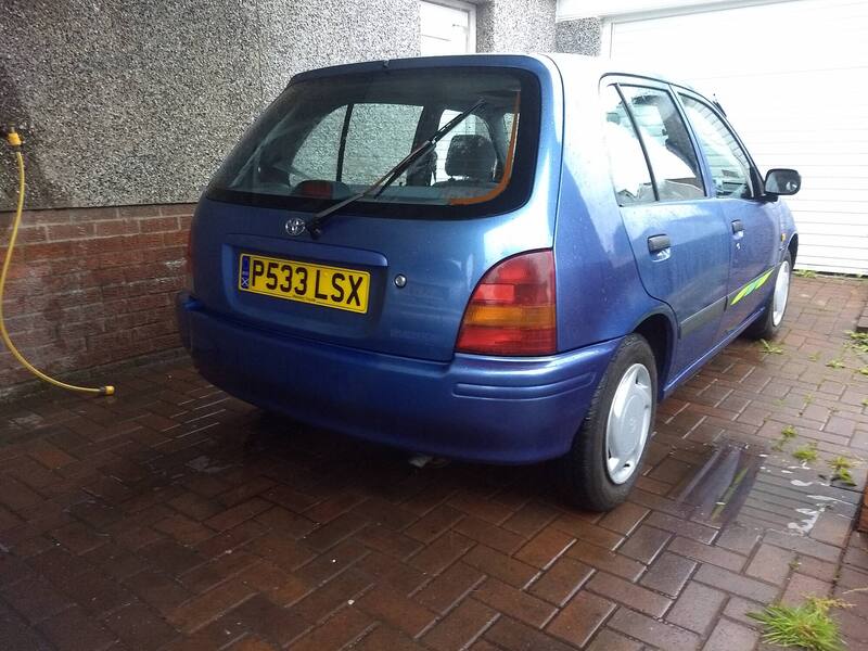

dome Posted July 8, 2019 Author Share Posted July 8, 2019 So, not a lot to report here on the existing fleet. I've enjoyed some time off from fixing cars which is nice. The MR2 has been intermittently losing lift and throwing up a code, I'm in the process of investigating this. Other than that not a lot has happened. Well, until yesterday... So I'd casually mentioned to my mate that I was thinking of finding a little project to make some cash on as funds were tight. The plan was to fix up the Exploder and maybe move it on and also get the Locost back together and advertised first so I wasn't thinking straight away. I then got a message on Saturday night saying "want a free car?" You can guess my response. The info was sparse. Toyota Starlet auto, owner was giving up driving and wanted it to go to a good home. It hadn't been used for over a year. I was in the borders MTBing yesterday where the contact was so gave them a call, it turned out the car was in the middle of Edinburgh so we met up and followed them over. I had no idea what I was getting myself into. How fucked was it? Had it been touch parked for the last 26 years or was it rotten? Would it run and drive? Let's find out... First surprise-It was sitting parked at the side of the road. A quick search of the reg showed it was MOT'd. It also had air in it's tires and whilst it looked a bit neglected it showed potential. Here she is as found Introductions were made, the owner was 91 years old and had given up driving due to poor eyesight. she was still pretty sharp though She'd bought it new when she passed her test in her 60s but hadn't used the car for over a year. She had kept it roadworthy though. Sure enough, it fired up and ran sweet The paint is pretty badly oxidised from sitting outside but bodywork was in mostly good shape. My checks didn't really go beyond a cursory glance under the bonnet to make sure everything was there, which it seemed to be. She had tried We buy any car but the salesman had never heard of a toyota Starlet nor of the "old" reg format. She was pretty switched on to be fair she had some young folk asking about the car and was sure it was because Toyota made a "fast version" (The mental little turbos) and they mistook it for one of those. She wanted the car to go to a good home so i was happy to take custody of it. Although I was slightly nervous of it's first journey in my hands being through the middle of Edinburgh on a warm (for Scotland) Sunday. Amazingly the handbrake was free and it drove happily out of it's parking space, straight to the pez station at the end of the road. It had half a tank in it but i thought i'd better put some in to dilute down the probably at least 2 year old petrol that was in it. First problem-the screw in petrol cap was missing. I chucked in a gallon anyway and off we went. And, do you know what? It drove spot on. The gears shifted fine and the temp gauge sat rock steady for the 20 odd miles home. It's first trip into Fife in it's life, no less! And quite possibly its first time above 40mph... First thing I did when i got home was dig out the fuel cap I'd kept off the Corolla-someone had messaged me about it when I was breaking it but never came back to me. Well bugger me but didn't it just fit perfectly? Result! Plans? Clean and tidy it, investigate the timing belt situation and possibly change that for piece of mind and then it'll be getting flogged. It'll do someone very well as a smoll auto for nipping about town but is no use to me as I'd struggle to get my bike in it. Shame, as I do enjoy smoll cars. I drove it to work today, will take it home tonight and have an exploratory prod of it. djim, 320touring, Tickman and 10 others 13 Link to comment Share on other sites More sharing options...
320touring Posted July 8, 2019 Share Posted July 8, 2019 Well in! LightBulbFun and dome 2 Link to comment Share on other sites More sharing options...
Split_Pin Posted July 8, 2019 Share Posted July 8, 2019 This looks like an utterly smashing little car. Quick win on the fuel cap too dome and LightBulbFun 2 Link to comment Share on other sites More sharing options...

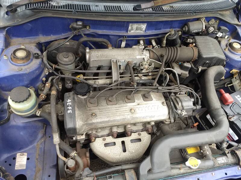

The Moog Posted July 8, 2019 Share Posted July 8, 2019 What size engine does it have? Link to comment Share on other sites More sharing options...
dome Posted July 8, 2019 Author Share Posted July 8, 2019 14 minutes ago, snagglepuss said: What size engine does it have? It's a 1.3 with, it would appear, 75bhp. The Moog 1 Link to comment Share on other sites More sharing options...

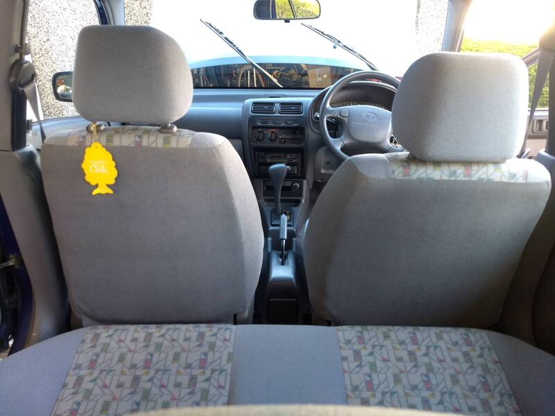

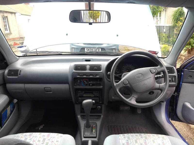

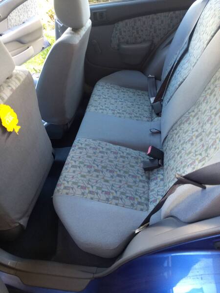

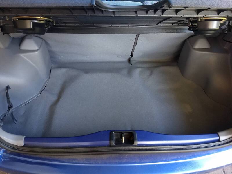

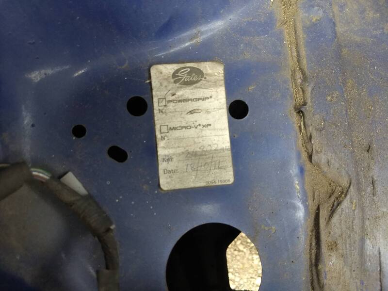

dome Posted July 8, 2019 Author Share Posted July 8, 2019 Some more smoll car pics for you all. I've not cleaned the interior yet, as you may be able to tell. Powerhouse. All fluids fresh and levels correct, belts look new too. Timing belt changed 8 years and 2000 miles ago... I gave it a quick wash and clay in fading light, it's came up ok. Some paint is pretty flat. Shame I'm shit at polishing but I'll give it a crack sometime. Shirley Knott, RayMK, Tickman and 4 others 7 Link to comment Share on other sites More sharing options...
