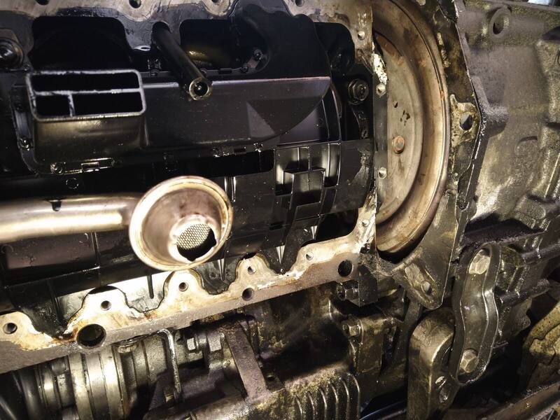

dome Posted August 19, 2019 Author Share Posted August 19, 2019 Oh and not forgetting the Exploder. It got some attention last month. Sump dropped again and the leaking instant gasket replaced with a real gasket. That'll teach me. Worryingly only 3 litres came out of the sump however when I chucked 5l in towards the 6l capacity it's now well above the maximum on the dipstick. Go figure... It also had started to use a bit of water which I noticed on a routine fluids check luckily-the gauge had been fine and the heater worked well. After a bit of detective work I traced this to the thermostat area. The thermostat housings on these are a common failure and sure enough this one had a hairline crack in it. Fine with the engine off but a steady stream of fluid was visible with the engine running. Handily* I'd been in here before when doing the timing tensioner so it wasn't too bad to get off. I managed it without removing the inlet manifold which was tight but doable. Here it is in place prior to removal And the crack A new one arrived from Rockauto fairly quickly. I took the opportunity to replace the pain in the ass sprung clamps with jubilee clips and got it back together. And how did it reward me? The LPG system has failed. A valve on the tank needs replaced. It's only £20 for the valve but it involves unscrewing it from the tank, releasing the gas. Fuck that! So, if anyone wants a mildly shonky but endearing 4x4 with all the common issues fixed(but plenty more to fix) then an advert will be going up shortly. My local LPG station has shut which isn't a big issue for the S4 as it does bigger distances. The Exploder which stays local is harder to justify. Also our office is due to move and my commute will be getting longer. A diesel bike carrier will be happening soon most likely. Mk 2 V70s and Octavia Scouts are on the list. Broken, naturally... Split_Pin 1 Link to comment Share on other sites More sharing options...
