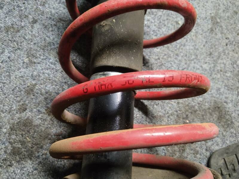

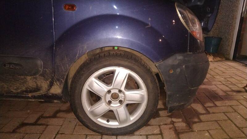

dome Posted November 29, 2020 Author Share Posted November 29, 2020 Small update on the Kangoo. The ride was pretty bad at the front-crashy over bumps and not particularly pleasant. It did look good though. It was on a set of unknown lowering springs at the front with new Clio 182 shocks and lowered on the torsion bar at the rear. Eibach Pro Race springs seemed to get a good reputation for Clios so I thought I'd give a set a try. I picked some up a week or two ago so last night decided to swap the fronts on. First off, let's get the struts off and see what was fitted Ah, that explains it. Gmax springs, beloved of Macxcy Ds car park fans everywhere. Off you fuck! No compressors needed as OMGLO so they were soon off and replaced with these. Back together and here's how it looked. It's settled a bit now but is still a bit higher than previous But, what a difference! Anyone who's experienced this thing can't have failed to notice the choppy ride- it's a million times better now and has some actual body control. Gmax-just say no kids! GMcD, loserone, Tickman and 15 others 18 Link to comment Share on other sites More sharing options...
bigfella2 Posted November 29, 2020 Share Posted November 29, 2020 I think even with standard springs you can get away without compressors. Clio 2 and kangoos are so easy to change fronts springs it's unreal. dome 1 Link to comment Share on other sites More sharing options...
