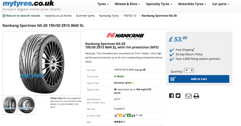

gm Posted June 8, 2019 Share Posted June 8, 2019 I'm not sure how you are fixed tyres but I just happened across this very good price for track day rubber https://www.mytyres.co.uk/cgi-bin/rshop.pl?dsco=110&cart_id=M9MCowzeaevnJhp5.110.297965637&sowigan=So&Breite=195&Quer=50&Felge=15&Speed=&kategorie=6&Marke=Uniroyal&tyre_for=&x_tyre_for=&Herst=Uniroyal&m_s=3&Ang_pro_Seite=50&weiter=50&rsmFahrzeugart=ALL&Label=E-B-71-2&details=Ordern&typ=R-394575   xl is the one with the firmer side wall, designed for heavier cars but I have these on mine and find them to be brilliant on track (although comedy in pissing rain, like we had last night on the way to sainsburys, so much sideways)  The Moog 1 Link to comment Share on other sites More sharing options...
The Moog Posted June 8, 2019 Author Share Posted June 8, 2019 Not in budget at the moment but will bookmark them. Those nankangs are on list b of the blue book which is banned for autotesting hence purchasing a set of rainsports Link to comment Share on other sites More sharing options...
