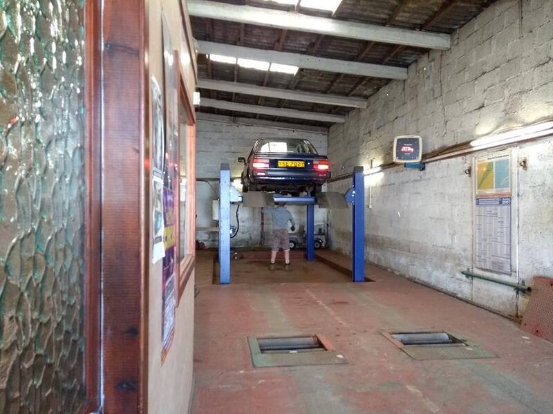

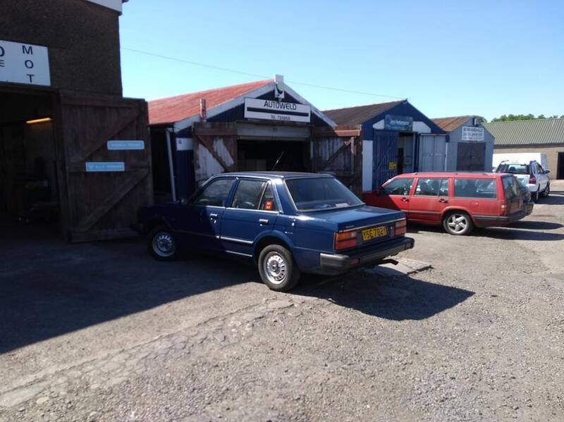

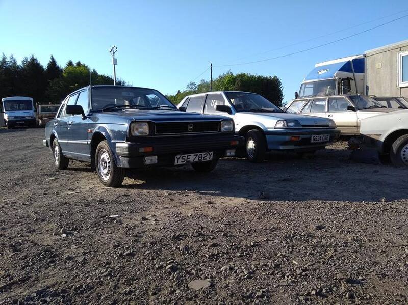

captain_70s Posted May 16, 2019 Author Share Posted May 16, 2019 Today was MOT day. Lovely. Steering suspension and brakes are all bob on, it'll need some work to the rear of the sills before the next one. Then swung by DodgyFOADKnight's place for a chat about shit old cars and to nosy at some of the newer additions to the fleet. Also had a wee drive of the Mk2 Polo Saloon. It's a bit rapid. As a bonus there was a Mk2 Honda Ballade there belonging to Nisfan. So we had a rare sighting of a Mk1 and Mk2 Ballade. RayMK, catsinthewelder, Coprolalia and 45 others 48 Link to comment Share on other sites More sharing options...
SiC Posted May 16, 2019 Share Posted May 16, 2019 I guess that was pretty pleasing and relieving result to get a clean pass first time. captain_70s 1 Link to comment Share on other sites More sharing options...
captain_70s Posted May 16, 2019 Author Share Posted May 16, 2019 13 minutes ago, SiC said: I guess that was pretty pleasing and relieving to get a clean pass first time. I was hoping but not expecting tbh. Although in all fairness the car is really in better condition overall than when it last got MOT'd aside from bits of cosmetic grot. My only real concern was the travel on the brake, but it doesn't actually affect the braking power, it'll still lock the wheels up. But aye, it is a major relief nonetheless! Link to comment Share on other sites More sharing options...

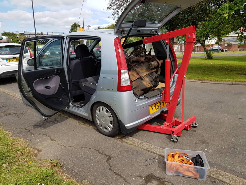

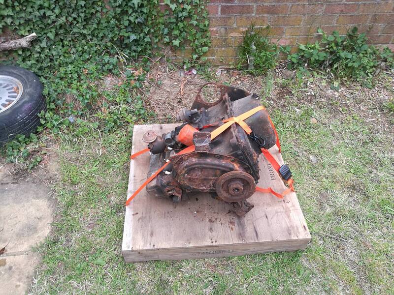

captain_70s Posted July 30, 2019 Author Share Posted July 30, 2019 Right, update. Engine situation I have two 1300 engines which need moving to my location, I'm currently arranging Shiply as it's cheaper than me collecting them in person. Engine No.1 is a Mk4 Spitfire engine which was donated by JudicialGrunt. It turns over and he pulled the head and it all looks decent, currently drained of fluids and strapped to a pallet awaiting transport. With a light rebuild it'd drop straight in. Located near Bedford. Engine No.2 is a 1300fwd engine/gearbox which Jikovron spotted for sale local to him. It was a quarter of the prices these engines usually fetch so I jumped on it. Its been sitting 30 odd years but turned over. Jikovron has stripped it and sent it to his local engineering place and has had the crank ground and had it rebored to 20thou. It'll need a bit of fiddling to fit a Dolly but it is a better pre-rationalisation engine. This engine is located near Chesterfield. Big thanks to these two shitters for their massive help. I jumped on the second engine as JD was super busy for a few weeks and I'd not heard anything, the day after I agreed the purchase of engine no.2 via JK he messaged me to say the engine was drained and strapped on a pallet ready for moving! Hence why I now have two. I'm currently have 3 cars and 7 engines, which seems a decent ratio. Big thanks to the multitude of shitters who offered help with engine transport as well. Given the distances involved it is cheaper to have them couriered than drive all the way there and back to collect them. Acclaim News. I bit the bullet and bought an exhaust. It's a mild steel example from IMASAF. Total cost inc delivery from Germany was £250 but I figure once it rots out I at least have a stock exhaust to have replicated in stainless. Fitting was painless and required no fettling, it is about half the weight of the old exhaust and sits perfectly, volume levels are probably also halved and rattles are eliminated... My mate kindly lent me his driveway to make fitting easier... I then took the car on a 1380 mile, fortnight long roadtrip around Scotland. More on that later... I now have to dash to work! Split_Pin, danthecapriman, LightBulbFun and 26 others 29 Link to comment Share on other sites More sharing options...
SiC Posted July 30, 2019 Share Posted July 30, 2019 What about nicking the 1850 engine and putting it in the 1300? Or is that too big a job you would want to do? captain_70s and LightBulbFun 2 Link to comment Share on other sites More sharing options...
Yoss Posted July 30, 2019 Share Posted July 30, 2019 Fitting an 1850 might be easier than trying to fit a 1300 FWD. The FWD crank is different. The front end is tapered (unless it is a really, really, really early one), to take the front flywheel/starter ring. The other thing is that there is no dipstick hole as they have a dipstick coming out of the gearbox (the FWD gearbox/diff/sump is one massively heavy lump of cast iron (well done getting the whole thing in what, I think, is a Daihatsu Somethingorother). The casting for the RWD dipstick hole is there but it would need drilling out. No real problem. You certainly seem to have enough bits to make an engine anyway. If it's a proper Spitfire engine I'd be tempted to go with that. The engine in my 1300TC is mk3 Spitfire spec and it's lovely. Really likes being revved. Much nicer than a 1500. purplebargeken, mk2_craig, captain_70s and 1 other 4 Link to comment Share on other sites More sharing options...
captain_70s Posted July 30, 2019 Author Share Posted July 30, 2019 1850 swap would require taking the whole drivetrain and axle out. Doable but nothing on the 1850 is in good enough nick to be worth the effort. The subframe is crusty, engine has done 90k and the diff whines. The fwd motor is a weird wild card but worst case, if I can't convert for rwd use, I'll rebuild it for fun and sell it on. Or, the Shitter's Choice, buy a fwd to put it in... somewhatfoolish and Yoss 2 Link to comment Share on other sites More sharing options...
