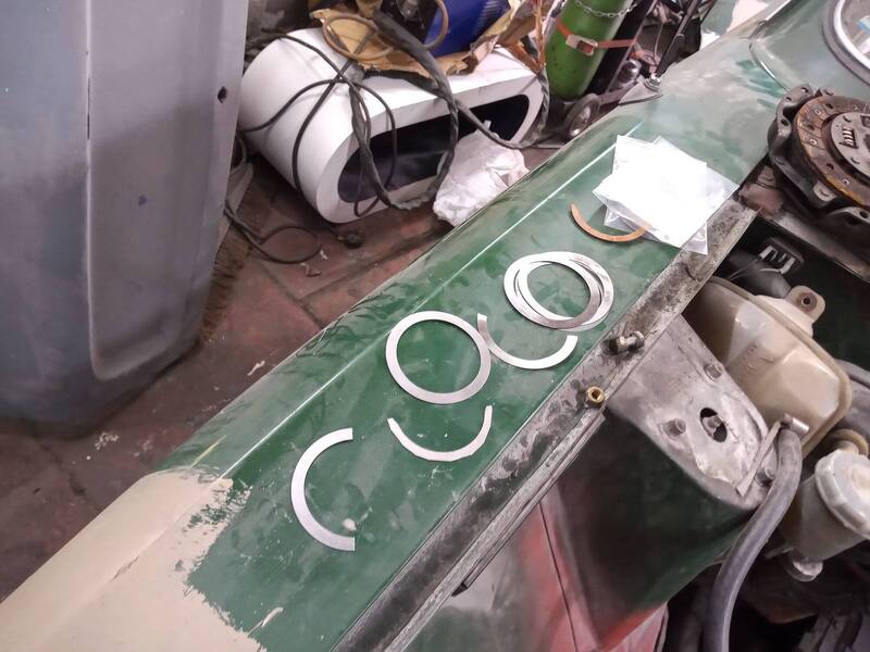

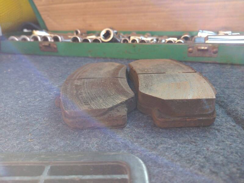

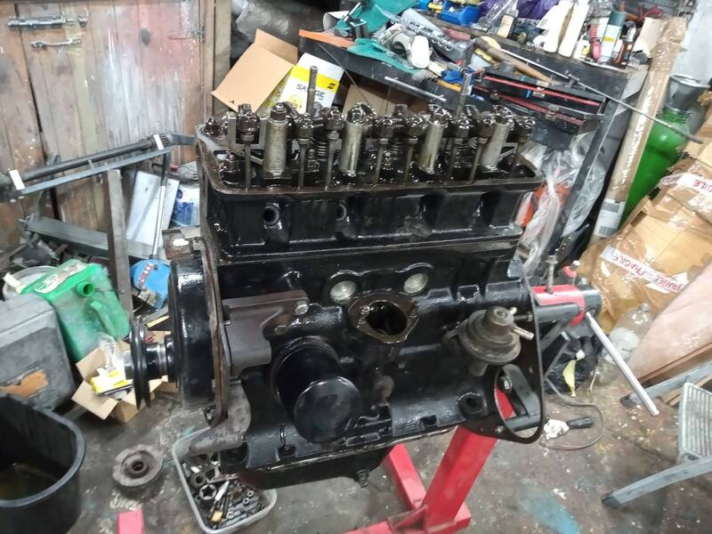

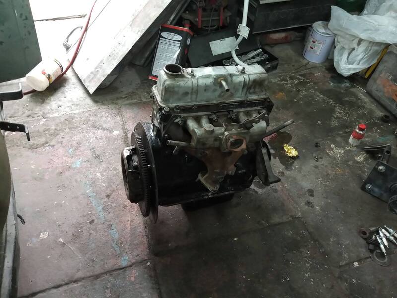

captain_70s Posted August 17, 2020 Author Share Posted August 17, 2020 Aye the bronze wear material on the washers is pathetically thin and once it's gone it's steel on steel with very little room for wear until the crank is FUBAR. Commercially available oversized examples simply have a thicker steel section, so they don't last any longer. Making them out of solid aluminium bronze would likely be the best option as that way even if they wear excessively they won't cause any damage until they physically drift loose. It's easy enough to check the crank float periodically and when they wear down drop the sump and install new ones. I think @Jikovron's assessment that the crank has been ground with filleted edges and is riding up on the block with excessive fore/aft movements and causing the engine to lock. Would also explain the suddenly changing float measurement, with the engine on the stand I probably never lent on the crank hard enough to drive the crank up onto the fillets, with all the heaving the engine out the crank was forced all the way giving the "true" reading. I then had a better levering technique the second time and was doing the same effort. The oversized thrust washers should sort that problem as well by simply keeping the crank from ever moving far enough for the fillets to be an issue. We know it doesn't have any issues when working to the factory tolerance and only binds in one direction of travel, so we should be all good to go with Operation Custom Thrust Washer! This also arrived today. £60 for half of a cheap repair panel, but it's the best you can get these days and it'll make life loads easier... As for rust prep the whole thing is being plastered in zinc paint and then drowned in wax. No box section or internal surface will be spared, on hot days it'll leave a puddle of rust proofing products oozing out of drain holes... Dick Longbridge, scdan4, Coprolalia and 11 others 14 Link to comment Share on other sites More sharing options...

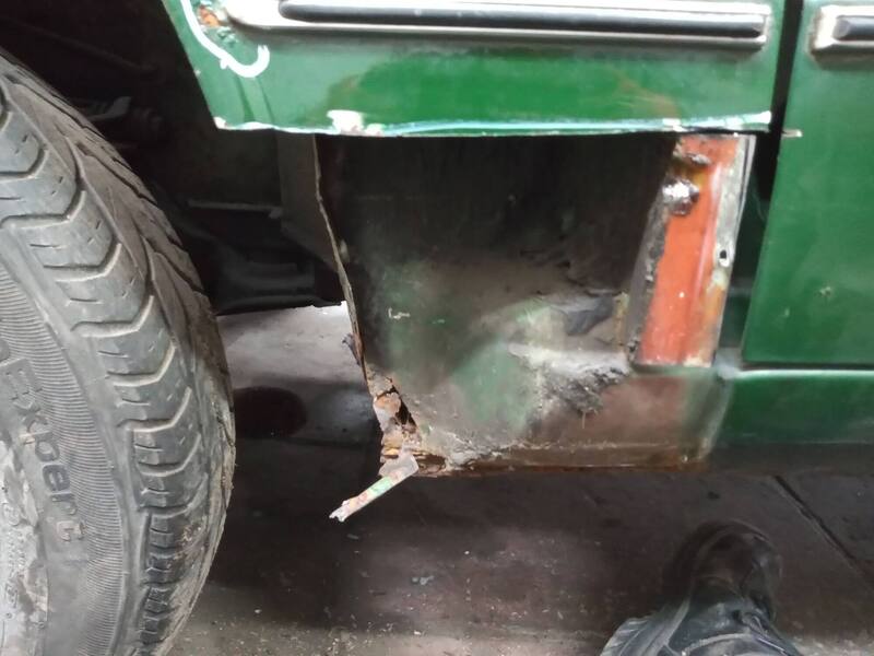

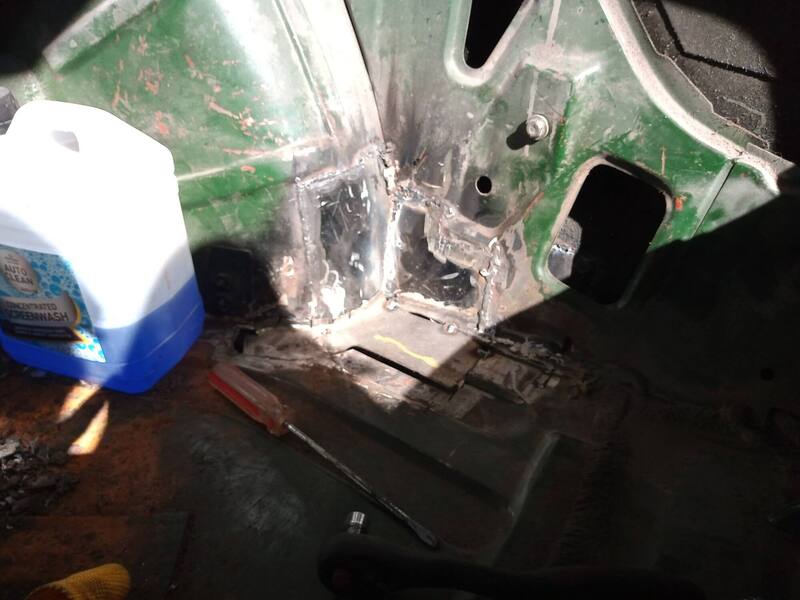

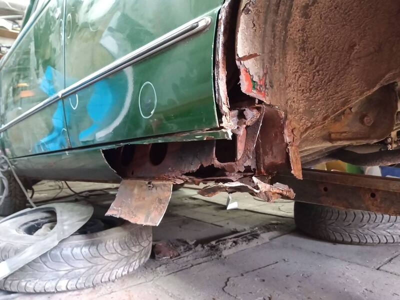

sloth Posted August 18, 2020 Share Posted August 18, 2020 excellent progress, i dunno if its of help but heres a pic of the sill end and rear pocket on my 1970 2500. its original and unrestored and unwelded. the joys of a dry climate. might be of use when making panels. apparently theyre very similar in design shape etc. GingerNuttz and Dick Longbridge 2 Link to comment Share on other sites More sharing options...

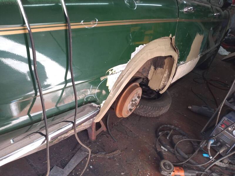

captain_70s Posted August 31, 2020 Author Share Posted August 31, 2020 Right, updates! Apologies in advance, my camera has died to death so my good photos are all trapped in a non-functional device until I can fix it... Doloshite Engine - Machine shops aren't keen on making washers, probably because it'd be a faff for fuck all money. We're going to try shims. The way the washers sit with the shims behind they'll be taking no rotational wear and will have no way to escape past the washer unless the washer has already fallen out anyway. We can also shim to keep the crank as central as possible while removing the most crank float possible. If it doesn't work I'll build another engine I guess, so stay tuned for that. ? Bodywork - Firstly, the Mk2 Golf inner arch was fitted on the O/S. The repairs ended up continuing northwards as the metal was too thin to weld to properly. The door jam had to be cut out again for access and then welded back in again once the repairs were done... The rot also extended into the boot with patches over filler over patches over rust... Needless to say the welds aren't being ground back on panels that will hopefully never be seen again... The beige paint is industrial zinc primer. The 1/2 a repair panel I bought was a shit fit, as expected for what was a cheap pattern part from the 1980s but the swage line matches and that's what we needed it for... Arch in. Distortion kept to a bare minimum, a bit of action with the dent puller sorted the worst bit. It'll still need spot welding to the inner. Needless to say I was not the one welding the above bits... I was around the other side of the car hacking into the other arch... Needless to say it was quite rough... At the trailing edge of the inner arch a huge plate had been welded over the top of the original and leading to both panels being completely rotten This was most evident in the boot. Not that the leading edge of the arch was any better... After cutting along the top and sides of the sills I pulled the rearmost section off by hand without even touching the bottom. Aside from one rotten patch the whole lot was crafted out of fibreglass... For good measure I also cut off the front edge of the sill and lower bit of the front wing... Much like the opposite side the jacking point was rotted out along with the sill reinforcing panel and trailing edge of the front arch. This side was actually quite a bit better than the O/S in that the base of the box section jacking point and the inner sill was also not utterly fucked. I now have my own MIG welder courtesy of @Tickman so hopefully this weekend we can get double the welding done as I can make an utter cunt of the sills and jacking points while @GingerNuttz does the good work to the arches etc. Here's a bonus shot of the front end of the car covered in primer to stop flash rusting while we work on other areas. It really shows how the shape is coming along despite still containing way too much filler that needs to be sanded away. dome, chodweaver, dave j and 42 others 45 Link to comment Share on other sites More sharing options...

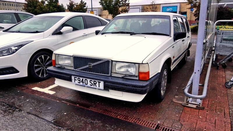

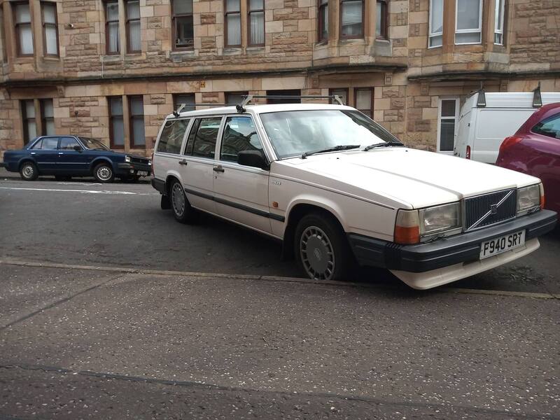

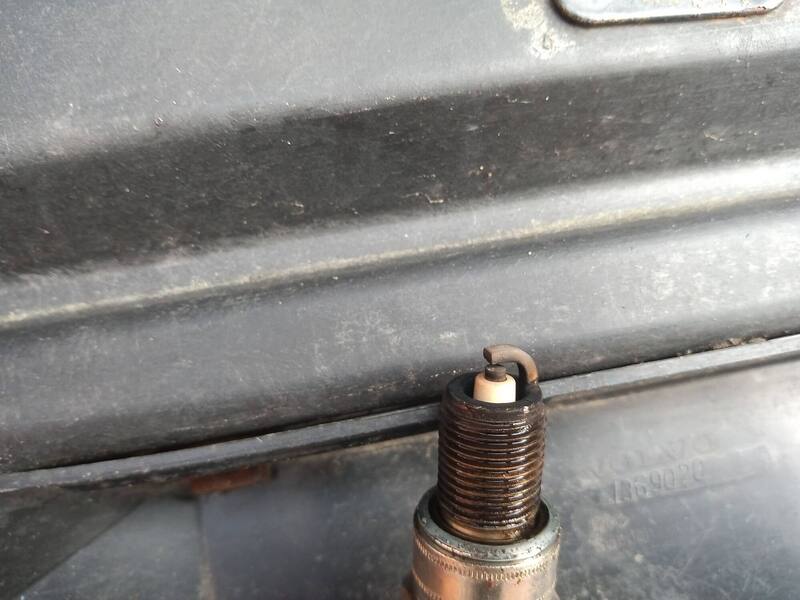

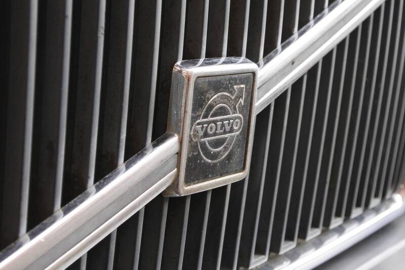

captain_70s Posted August 31, 2020 Author Share Posted August 31, 2020 Acclaim It actually used some oil for the first time ever (probably due to my newly frequent 70mph runs to Motherwell) Its also nearly eaten through it's front tyres, the rears still look brand new. Volvo The newest fleet member. Collection detailed here: Now back from holidays it can get some well needed tinkering. Firstly: Roof bar delete: -5 Practicality +5 Fuel Economy +2 Noise and Comfort Overall +2. WINNING. Then I set about checking various service bits. The plugs look pretty fresh. Dizzy cap and rotor arm were far from the worst I've seen. Cleaned up decently with the rough side of a sponge and some WD-40 Equivalent. There is mild pitting but nothing compared to what I've pulled out of the Dolly/Acclaim before. It also looks like somebody has been playing with the ignition timing so I'll have to dig out the strobe light to double check that's correct. The air filter looks pretty much new. I also adjusted some excess slack out of the kickdown cable. Tyres lacking a date code = Best tyres. The one on the opposite side (rear) is from '09 and is identical, the fronts are from '11. Great tread, perished to fuck. The car will kick it's tail out on hairpin corners going up steep hills locked in 2nd. Ask me how I know... I peered through the steelies to check there were pads. There are. The brakes squeal. I'll need to take the wheels off to look. Another day... So, it needs: Tyres x4 PAS pipe Welding to rear of sills Various electrical maladies sorting Work out why the starter motor won't always engage and just clicks at the solenoid Source cause of lumpy idle/misfire when warm The functional cars section of the fleet is actually looking not too bad... Dick Longbridge, Fumbler, chodweaver and 32 others 35 Link to comment Share on other sites More sharing options...

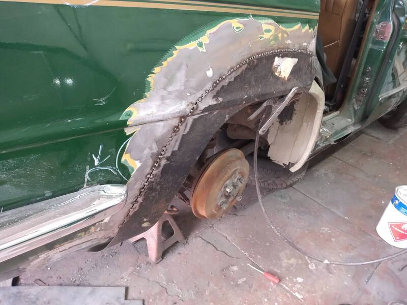

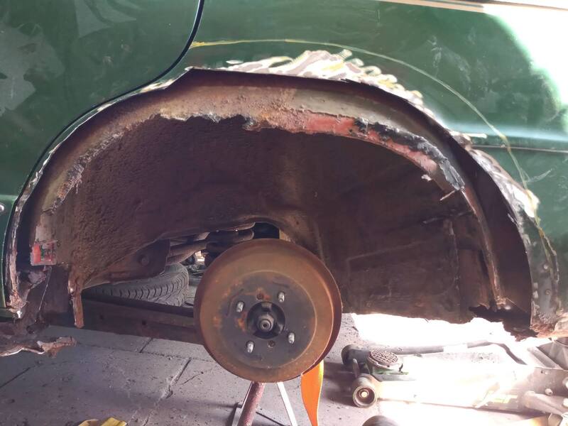

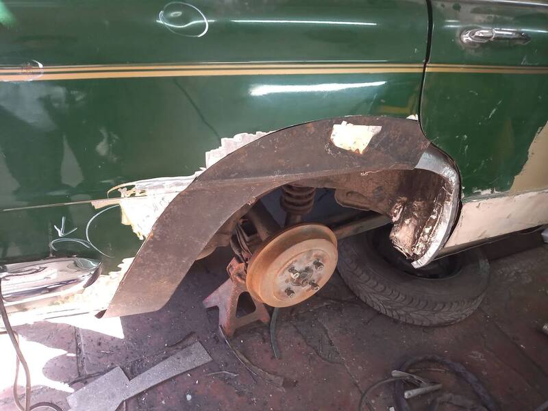

GingerNuttz Posted September 1, 2020 Share Posted September 1, 2020 Fingers crossed the passenger rear arch isn't as thin up towards the shock mount and we don't have to replace a shit ton of steel. LightBulbFun and Tickman 2 Link to comment Share on other sites More sharing options...

Talbot Posted September 1, 2020 Share Posted September 1, 2020 On 8/31/2020 at 8:28 PM, captain_70s said: Oopsie on the door there with the grinder! This is superb work and clearly a herculean effort. Have you got plans for what it will be used for once working and on the road? Also, what brand of welding wire are you using? I need to buy shares in them pronto. Link to comment Share on other sites More sharing options...
Spiny Norman Posted September 2, 2020 Share Posted September 2, 2020 Papped! ? Got to say that's a fine looking old Lolvo for the money, Captain. Fumbler, Shep Shepherd, BorniteIdentity and 5 others 8 Link to comment Share on other sites More sharing options...
captain_70s Posted September 2, 2020 Author Share Posted September 2, 2020 FAEM! Yeah, I caught the door with the grinder, after spending fucking ages trying not to. The rear edge of the wing doubles back on itself to be come a flange to weld onto the shell, I couldn't get the grinder in far enough to get at it and eventually I got impatient and sliced the door... A couple of blobs of weld and you'll never know! ? Mine isn't the worst Dolomite I've seen restored, although it is probably one of the least valuable examples to have such major works carried out. This sort of work is really reserved for OHC cars... LightBulbFun, Coprolalia, dome and 1 other 4 Link to comment Share on other sites More sharing options...

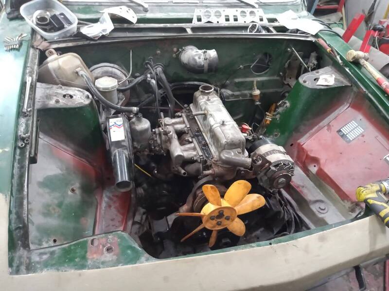

somewhatfoolish Posted September 6, 2020 Share Posted September 6, 2020 7 hours ago, captain_70s said: Installed. Handily, with the new engine mounts installed you now can't take the air filter off without heaving the whole engine clockwise to give the bolts clearance to get in. It was always tight but once gain repo parts aren't quite right... That would bug the tits off me; worth shimming the offside engine mount? Link to comment Share on other sites More sharing options...
GingerNuttz Posted September 8, 2020 Share Posted September 8, 2020 Just go twin carbs and don't shim the engine mounts, problem solved ? davidfowler2000, blackboilersuit and jaypee 2 1 Link to comment Share on other sites More sharing options...

alf892 Posted September 8, 2020 Share Posted September 8, 2020 RE thrust washers.......aren't they the same as the 1500 ones? Moss do them for the 1500 midget engine up to 30 thou over in increments of 5 thou. Mind you oversize ones shouldn't be used to take up wear.....not wanting to teach egg sucking but machine shop should grind the thrust faces as required and go from there.. If you try to take up wear chances are that the wear pattern on the crank will pretty quick take the new ones down. if thrust faces are fkd you can get it metal sprayed and machined back to standard Link to comment Share on other sites More sharing options...
Jikovron Posted September 8, 2020 Share Posted September 8, 2020 The machine shop did grind the thrust faces, and unfortunately only a +10 is available for a pre 71 1300 engine which realistically would have been absolutely fine if the crank journal radiused fillets werent ground bigger than stock and thus unknowingly at the time of build binding on the center main bearing however as you say a post 71 1300-1500 use a larger thrust bearing available in all of the sizes! alf892 1 Link to comment Share on other sites More sharing options...
captain_70s Posted September 9, 2020 Author Share Posted September 9, 2020 13 hours ago, Jikovron said: The machine shop did grind the thrust faces, and unfortunately only a +10 is available for a pre 71 1300 engine which realistically would have been absolutely fine if the crank journal radiused fillets werent ground bigger than stock and thus unknowingly at the time of build binding on the center main bearing however as you say a post 71 1300-1500 use a larger thrust bearing available in all of the sizes! WHS. Parts in that level of oversize aren't available for my particular variety of engine. In real terms this is the last hoorah for this lump, it's machined up to the hilt and can go no further. Not that there is anything wrong with the work that's been done, but there isn't really any scope for more cylinder boring/crank grinding - It'd already been rebuilt once when @Jikovron acquired it! Even if I only get 30,000 miles or so out of it (with a yearly replacement of thrust washers) that's still 6 years of motoring. The monetary cost of this engine is still pretty low (likely sub £500), so it's still mega-cheap if it works at all... If it blows up I'll find another engine, although all the examples I've acquired over the last few years (3!) have featured similar levels of ridiculous end float so the challenge will be finding decent core... Scruffy Bodger, alf892 and somewhatfoolish 3 Link to comment Share on other sites More sharing options...

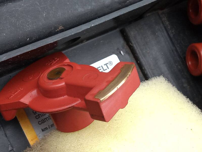

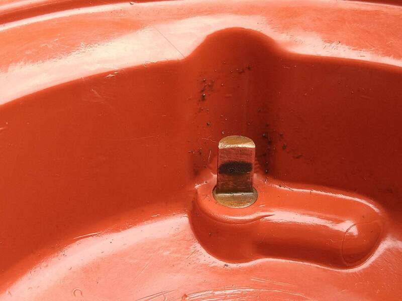

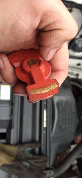

captain_70s Posted September 17, 2020 Author Share Posted September 17, 2020 Last Sunday tried to get the engine run in. Starter wouldn't work, kept sticking. Tried adding more power with jump leads, no help. Smacked it with a bit of wood, moderate improval. Replaced that with the old starter motor off the Herald. The engine span! And wouldn't fire. Not a sausage. So turned out we had the ignition timing out by 180 degrees. Correcting that got it to splutter a bit. Spark was pish, points in the dizzy were sitting wonky for a start. Then we did a compression test, 25psi per cylinder... Ah. Either we've fucked up the cam timing or somebody has sneaked into the workshop overnight and nicked the pistons. Fuck it, problems for another day. The car was relegated to outside under the Cover Of Shame as @GingerNuttz has restarted working on the Herald during the week. So. On to the Volvo. On my last run back from doing Doloshite related stuff it started making a horrendous grinding noise from one of the front brakes. It'd always squealed a bit but it was a distinct "no pad" type sound... This meant I'd have to investigate the brakes, which I finally got around to doing today after work. Mmmm, crusty. Not exactly the most even pad wear, the disc was corroded on the edges on the inside. The piston wasn't fully retreating but it wasn't binding. I greased everything up, cleaned up the back of the disc with a wire brush and threw it back together as I lack any rebuild kit or anything useful for actually improving it. On to the other side... Ah, yes. That'll be the grinding noise. Pistons jammed fully out, seals fucked. Woo. I looked at this bleed nipple the wrong way and it rounded. At this point I started having PTSD style flashbacks to the Civic... Anyway, I raided the many boxes of assorted parts that came with the car and found some mildly used brake pads, so I nicked one of them and with a lot of effort and brute force managed to get the pistons retracted enough to fit two pads... I took it a spin around the block and it no longer scrapes like a bastard. There was also no signs of the caliper binding and the wheel didn't get hot so it'll do for now. Caliper rebuild kits are £60 a pair and I dare say they'll go again. They aren't even the originals, it had a new set of calipers and discs 7 years ago but long periods of sitting around and sea air have taken their toll... You may also note that the O/S has matching pads and the N/S had a mismatched pair. Perhaps it's been eating it's inside pads for a while... I also got a new (second hand) lens for my camera so could get some better photos... Shep Shepherd, davehedgehog31, Vince70 and 14 others 17 Link to comment Share on other sites More sharing options...
