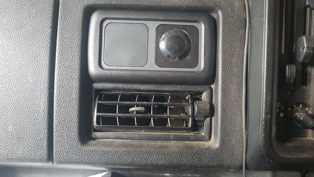

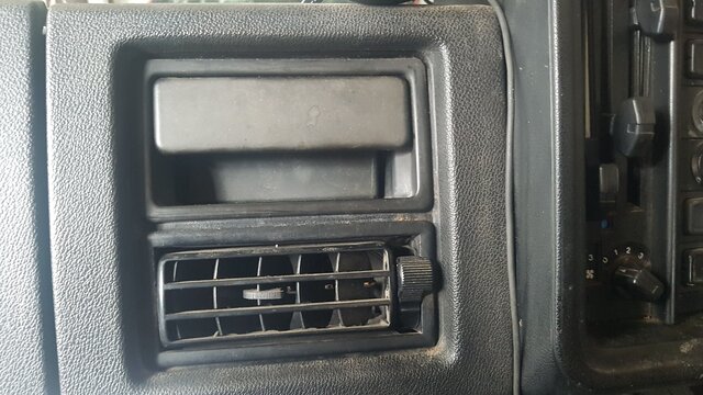

One minor annoyance with the AC was turning it on from the cab. You have the switch to start the inverter...
...but you also have to turn on the AC with a remote control. I'd mounted the 'eye' for the remote in the living accomodation, but it quickly became apparent that a) this was a PITA to trigger on the move, and b) if I'd put the 'eye' on the dash it would be perfect to access from anywhere in the rear anyway!
Problem was, there was nowhere to mount it. All my switch blanking plates were full, and there is nowhere flat on the dash to use. So I had half an idea about removing the ashtray (which I don't use), and making up something in that space.
The remote receiver is designed to fit into the CBE range of modular caravan sockets/switches, so I measured up and by some stroke of luck the space left had the perfect dimensions to accept a double frame!
I've got a blanking plate on the left, which I may fit an in/out thermometer into, or something (I dislike blanks!) But overall, pleased with the look.
