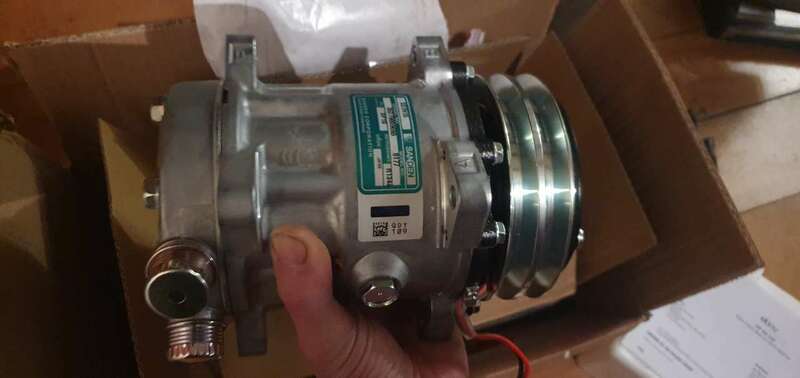

Asimo Posted August 12, 2022 Share Posted August 12, 2022 9 hours ago, mat_the_cat said: First stumbling block is compressor mounting, as the only reference I can find to an factory fitment has the compressor in place of the optional PAS pump, which I don't want to lose. I don't know whether that was simply more convenient in production to offer an either/or option, or whether there's difficulties in mounting elsewhere... Where is the compressor fitted on these engines in Volvos? They will always have had PAS as well. Link to comment Share on other sites More sharing options...
mat_the_cat Posted August 12, 2022 Author Share Posted August 12, 2022 2 hours ago, cobblers said: What about converting to electric PAS and ditching the hydraulic system? Or maybe just use a Saxo electric PAS pump mounted somewhere convenient? 1 hour ago, Asimo said: Where is the compressor fitted on these engines in Volvos? They will always have had PAS as well. Couple of good ideas there, thanks! Link to comment Share on other sites More sharing options...

mat_the_cat Posted January 18, 2023 Author Share Posted January 18, 2023 I haven't forgotten the AC install on this, I've just been thinking about it (and spending the money on Land Rover parts instead!) Pretty sure I will go down the route of fitting an electric power steering pump, and mounting the compressor in its place. It's just going to be so much easier that way, rather than trying to cram it in. So I'm on the lookout for a suitable electric pump with a pressure of 100 bar. Ideally with an M16 outlet thread, so I can just swap over the existing hose. No great rush, as I'm skint, and I've probably left it too late for this summer anyway given my work rate! But if anyone knows their pumps, any leads would be useful... Link to comment Share on other sites More sharing options...
Talbot Posted January 19, 2023 Share Posted January 19, 2023 There's a Saxo with an electric PAS pump sitting in the FOD at the moment. You're welcome to it if it will fit or can be made to fit.. Minimad5 and mat_the_cat 1 1 Link to comment Share on other sites More sharing options...
cobblers Posted January 19, 2023 Share Posted January 19, 2023 Yup, 106/saxo or merc A class are the usual suspects. The merc pump is better, the saxo ones cheaper and easier to wire up. Link to comment Share on other sites More sharing options...
mat_the_cat Posted January 19, 2023 Author Share Posted January 19, 2023 6 hours ago, Talbot said: There's a Saxo with an electric PAS pump sitting in the FOD at the moment. You're welcome to it if it will fit or can be made to fit.. Ooooh, that might be handy, thanks. Others I'd been looking at were Volvo S40 (although I think shared with many others) and Toyota MR2 Mk3. All just 3 wires to get the basic functionality, but the Toyota one seems to drop into a standby mode if you're going in a straight line. Useful to minimise electrical load. But Saxo pumps seemed to be a fairly common mod. I will check specs! Link to comment Share on other sites More sharing options...
artdjones Posted January 19, 2023 Share Posted January 19, 2023 Or you could do a similar conversion to a lot of Talbot Expresses and fit a Clip electric column. Link to comment Share on other sites More sharing options...
mat_the_cat Posted January 19, 2023 Author Share Posted January 19, 2023 I did wonder about that, but it seems simpler to fit an electric pump and just swap the hoses over. Easier to trial with temporarily, and revert to the engine-driven pump if there was a problem. Not ruled it out though, mind. Link to comment Share on other sites More sharing options...
cobblers Posted January 19, 2023 Share Posted January 19, 2023 43 minutes ago, mat_the_cat said: I did wonder about that, but it seems simpler to fit an electric pump and just swap the hoses over. Easier to trial with temporarily, and revert to the engine-driven pump if there was a problem. Not ruled it out though, mind. Everyone I know who has fitted a Corsa EPAS to some old van has complained that it made the steering terrifyingly vague. I have bolt in epas kit to go in my t25 that has been sat on a shelf for a year because I have never heard a good word about them (other than from people who wouldn't know what steering feel was if it hit them in the face), so I reckon you are definitely on the right track sticking with hydraulic PAS if you can. mat_the_cat and mk2_craig 2 Link to comment Share on other sites More sharing options...
mat_the_cat Posted January 19, 2023 Author Share Posted January 19, 2023 From my limited but growing understanding, the Corsa arrangement has 3 levels of assistance depending on vehicle speed. Obviously there's not going to be a speed signal on an old shed so I'm guessing it defaults to parking mode which must be horribly over-assisted at speed. I'm fully expecting a bit of trial and error (mostly the latter probably!) so I like the idea of just putting the PAS belt back on and swapping the hoses back - rather than sawing my steering column in two and finding out I don't like it Talbot 1 Link to comment Share on other sites More sharing options...

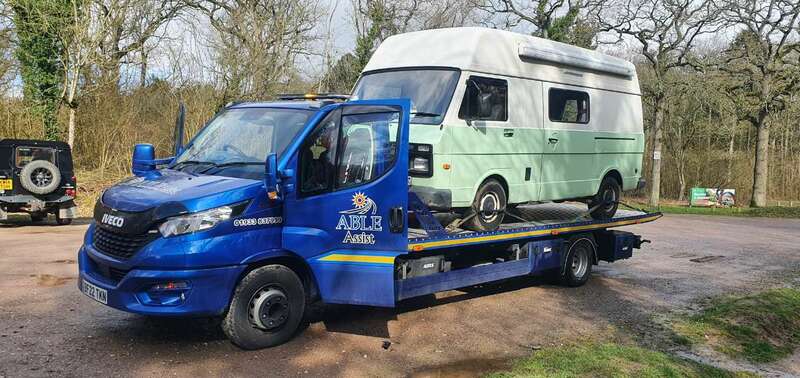

mat_the_cat Posted March 13, 2023 Author Share Posted March 13, 2023 For the first time in nearly 100,000 miles I've had to call out recovery. I'm stuck near Northampton with a failed clutch The gearbox arm is moving when I press the pedal, but it's not disengaging. Not sure what's the most likely cause at the moment. Annoyingly it's not the cable, as I carry a spare! HMC, Six-cylinder, RobT and 10 others 13 Link to comment Share on other sites More sharing options...
RobT Posted March 14, 2023 Share Posted March 14, 2023 Have you been recovered yet? Hopefully a Monday night isn't too busy and they get to you in good time. Link to comment Share on other sites More sharing options...
mat_the_cat Posted March 14, 2023 Author Share Posted March 14, 2023 Not yet...Good job I'm in a campervan, although wonder if that pushes me down the priority list somewhat. Annoyingly I've not been able to collect what I came for, so have to make the journey again anyway! Coprolalia, Dyslexic Viking, Asimo and 1 other 4 Link to comment Share on other sites More sharing options...
Back_For_More Posted March 14, 2023 Share Posted March 14, 2023 Hang on..... 12hours and not recovered yet.... WTAF! Was it a sudden cease of operation or anything noticeable beforehand? *edited for stupid remark removal* Hope you're on your way home soon fella. Good luck.... Got enough cuppas available? Crackers 1 Link to comment Share on other sites More sharing options...
mat_the_cat Posted March 14, 2023 Author Share Posted March 14, 2023 Some positivity, apart from the fact it's an Iveco. Engine management light on at less than a year old and 46k miles, but we're not too far from home now. RayMK, puddlethumper, mercedade and 3 others 6 Link to comment Share on other sites More sharing options...

mat_the_cat Posted March 14, 2023 Author Share Posted March 14, 2023 2 hours ago, Back_For_More said: Was it a sudden cease of operation or anything noticeable beforehand? Got enough cuppas available? No warning whatsoever. Which surprises me - I've always been very confident that there's very little on the van which could fail suddenly, but seems I was wrong. Fortunately OK for food and drink, just the inconvenience of it all. Back_For_More 1 Link to comment Share on other sites More sharing options...
Back_For_More Posted March 14, 2023 Share Posted March 14, 2023 I removed the comment earlier about the arm failing - the behemoth that Asimo has a pic of - just next to the push point from the slave cylinder..... Hope it isn't that bad..... But I've probably jinxed it now - sorry Link to comment Share on other sites More sharing options...
mat_the_cat Posted March 14, 2023 Author Share Posted March 14, 2023 There still feels like resistance to pedal movement, and the same at the arm itself - not floppy as I'd expect if the arm had failed. But I can't think what could have failed. New clutch on order, as whatever the fault there's no sense putting a 300k mile clutch back in. Back home now but it was touch and go at times! What a heap of shit the truck was. Iveco have been out 15 times in a year to try and solve the ghost EML, but no fault found. We had a random 'check trailer lights' warning, as well as a speed sensor fault knocking out cruise control. Then with about 20 miles to go the clutch started slipping Talbot and Dave_Q 2 Link to comment Share on other sites More sharing options...
