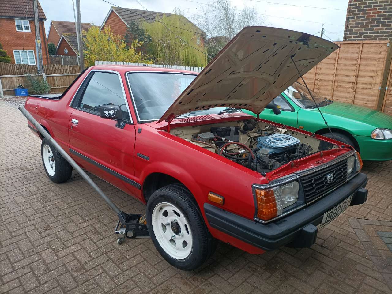

  17. Subaru Brat news. I am about to put my house up for sale and the estate agent has advised that seven cars and an 80's caravan with half a floor on the front (I don't think he clocked the Minor up the end of the garden) might put potential buyers off. So the old Subaru in the corner by the road was unearthed and moved up on the driveway. Its had a cheap car cover on it throughout the winter months for the last four years and despite internet opinion saying otherwise the paint hasn't bubbled or been abraded and allowing for it being red it hasn't particularly faded either. I have changed the tyres to 195/60's instead of previously fitted rakish 195/50 x15 tyres. I think the bigger tyre suits it and will give it longer legs too,alas my son says the opposite. And while having a dig through the shed a while back i refound the bash plate and wing undergaurds for it so spent way too long remembering how they fitted and what fixing went where. I needed a battery too so at around four pm yesterday i went on to the Tayna battery site and ordered a nice Exide jobby and it turned up at 9.30 today. Happily it's charged to the brim and not been sitting around for weeks on a cold concrete floor somewhere degrading. I can now drive it down and park it up at my vacant new abode and now just need to re-home the soggy caravan.
