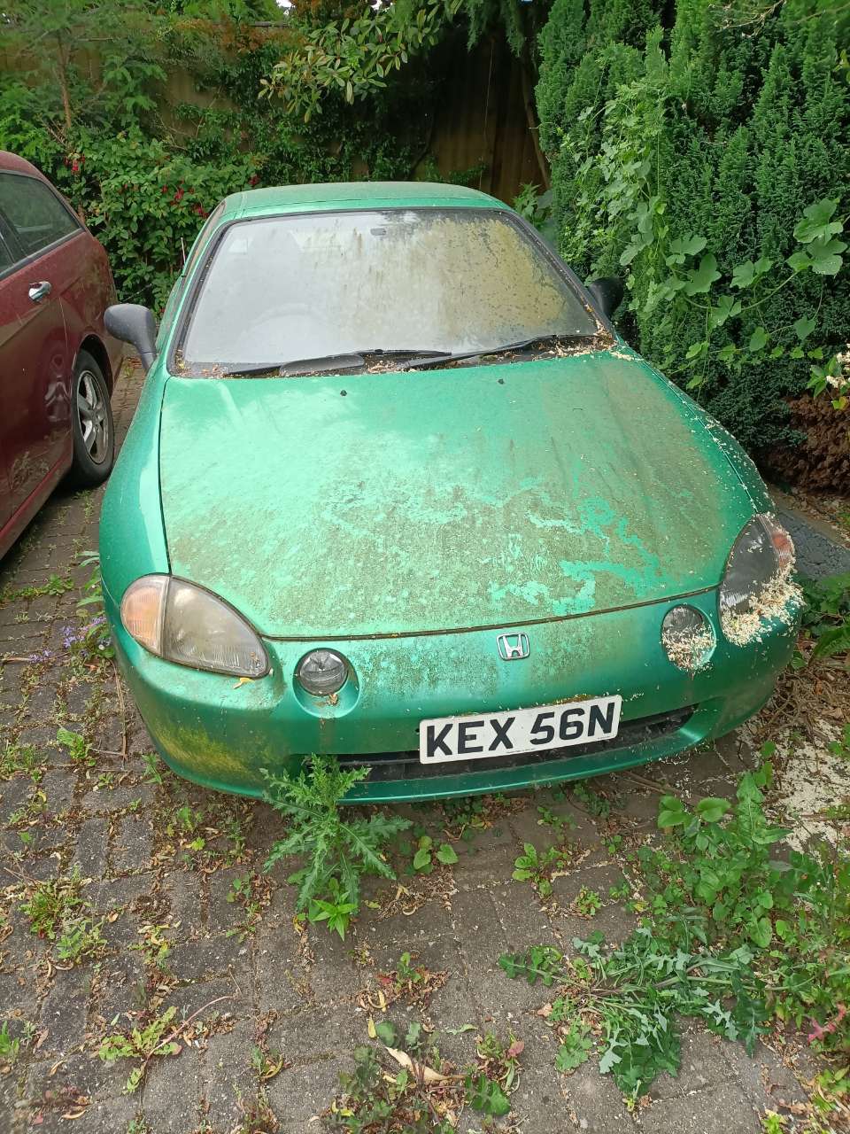

    The wifes had this old samba green CRX auto for seven years (it was a valentine's present) and in that time it's been used mostly in the summer months and sometimes it's been forgotten about for a year or two.
    It's had a really good run out this year but the MOT expired last month and it needs some suspension bushes and a tyre replacing also the laquer peel on the wings was quite impressive. But alas there's not going to be any room for it at my new house so reluctantly it has to go.
    So it's old number plate was reinstated and before I could advertise it a bloke knocked on my door and gave me £500 for it.
    Probably going to miss the thing but if we have a spare car it got to be allowed inside the M25.

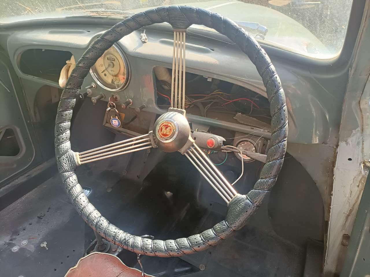

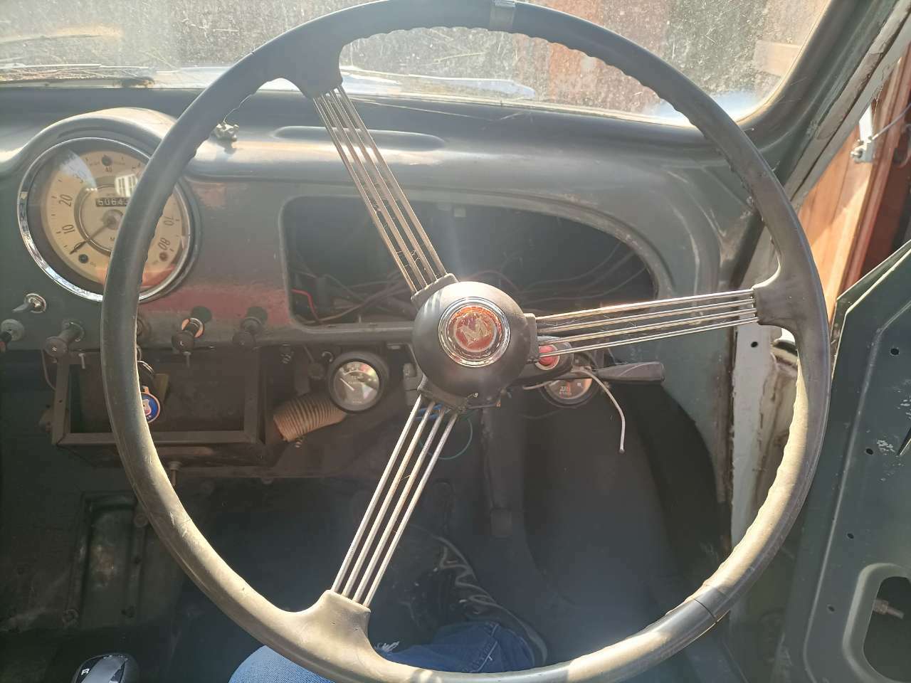

    I love an old steering wheel but the skinnyness of their rims just feels wrong after years of grabbing modern wheels so off to eBay I went.
    I bought a silicone cover that was both too thin and too baggy so I taped it on ready for fitting the ultimate old giffer accessory from the 70/80's.
    The smell alone takes me straight back to 1986 and my '72 mini 850.
    Woof.

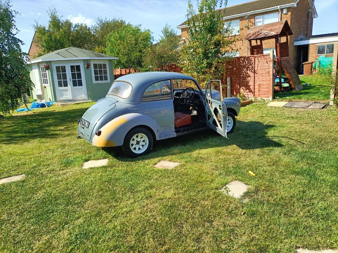

  8. A fresh can of fuel and a quick wipe of the points was all that was needed to get Boris running again and now the exhaust is properly fitted and leak free he doesn't sound anywhere as loud as I feared.
    I have started bunging the seats back in too.
    I am not worried about putting the door trims or carpet back yet as they need cleaning and the cardboard backing of the trims are distorted and flaky so can be played with over the winter.
    Now he's back on the floor I have realised I have set the n/s front suspension one spline too high.
    So the plan is still to get him mobile enough to drive a mile down the road to my new house in the next couple of weeks (if I ever bloody exchange) so realistically I now just need rear lamps and front number plate sorting.
    And this must be a sign I saw Boris's brother the other day (running on rare Princess Ann scimitar alloys).

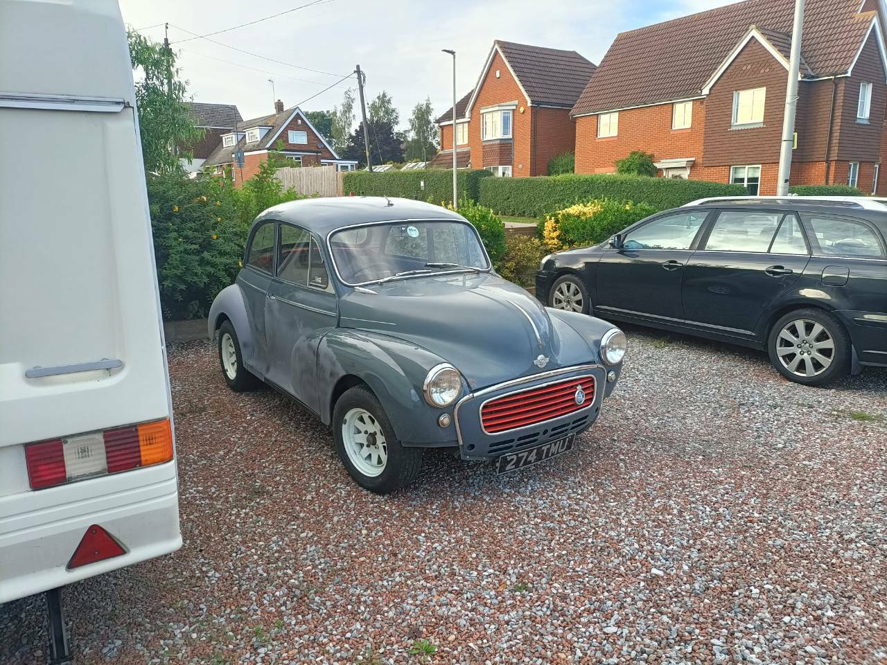

  9. So it's September and nearly three years since World of Ceri dropped this wee scabby Minor off at mine the master plan was turn him around within two years as a rot free/solid but scruffy Summer toy.
    Well as ever life and other shizzle has got in the way BUT I am getting close to getting Boris out of my back garden and charming the general public again.
    So what's been happening  ? Well the other week I tried fitting the drivers side wing that I repaired before Covid only to find it was actually miles out where it met the door and so took a bit of butchery and remodeling to get it to sit half right against the door.
    Bugger...
    Chop,cut,bend and reweld as req...
    And it now fits ok ish.
    I wasn't happy with how the clutch mechanism's mounting plate flexed so I added more metal to stiffen it up
    Much better.
    The headlights and front indicator lamps are now fitted but for some strange reason neither now work.
    Stopping water getting into the doors seemed like a good idea so I have acquired a length of a more up to date (Marina ? ) weather strip for the drop glass. I have cut it to size but am waiting for a nice hot day to bond it to the door with tiger seal.
    The drivers side rear wing has been tweaked (bent as req) and fits well enough although I bought light grey beading instead of dark grey.
    I am definitely going bumperless on the rear and ages ago picked up a tow bar to give the car a bit of protection but with no bumper it sticks out way too far so will need a bit of cut 'n' shut surgery otherwise I will be constantly tripping over the bugger.
    Rear lights are yet to be decided on I want to go with red tail and indicators lens.

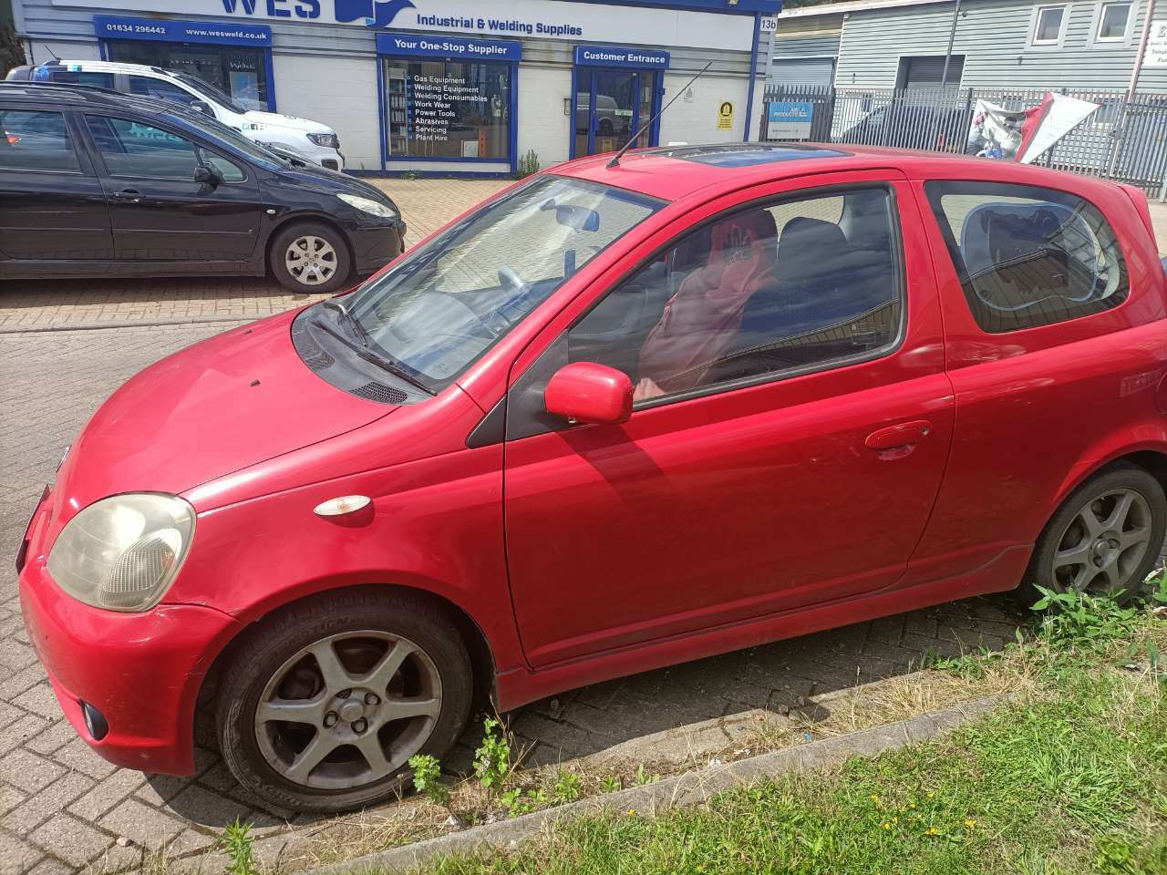

    So a cheap little 1.5 Tsport Yaris has joined the fleet but alas the drivers side rear wheel is a bit wonky donkey.
    An hour or so saw the rear beam dropped out revealing the corroded mess that used to be the beams O/S mounting/pivot point.
    N/S not too bad.
    O/S is absolutely jiggered.
    The beam needs a good clean up to see if it's had it or if it'll go again but the car did come with £40 worth of new mounts.
    It's a real shame as the car has had a recent repaint and even the AC works fine.
