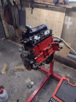

  13. Still not had the head back, but i did manage to get hold of a spare head tat had recently been rebuilt, in canve island, which isn't too far from where im working at the moment. so last weekend, with my folks away, i camped out in their garage and set to work. after a lot of swearing, putting the crank in the block the wrong way around and wondering why the main bearing caps didnt sit quite right (thankfully i hadnt tightened them down!) and general graft, the bottom end was built back up. ive opted for 1300cc pistons to raise the compression ratio a touch, but the rest of it is remaining standard. at close of play on sunday, we were at this point: just need to do the tappets, put the dissy in, and refit the flywheel, and we should be good to put it back in the car, hopefully this weekend! more updates at the weekend. Lee

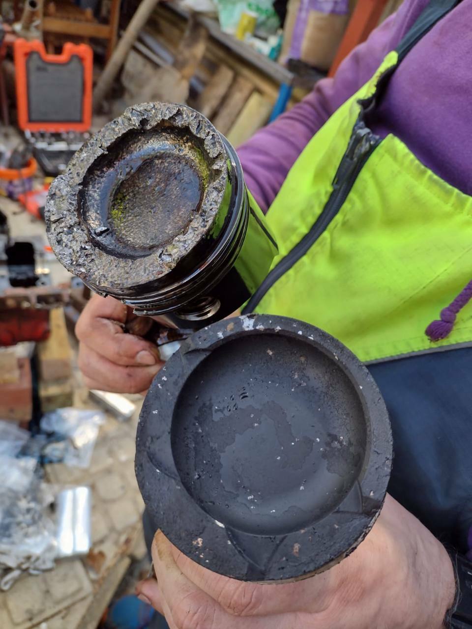

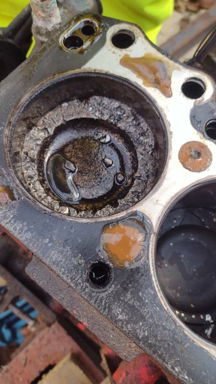

  17. Well, big end is fine.... Unfortunately, the exhaust valve seat insert has gone MIA, last seen going to pieces in cylinder #1 😱 Lots to do, but still salvageable.
