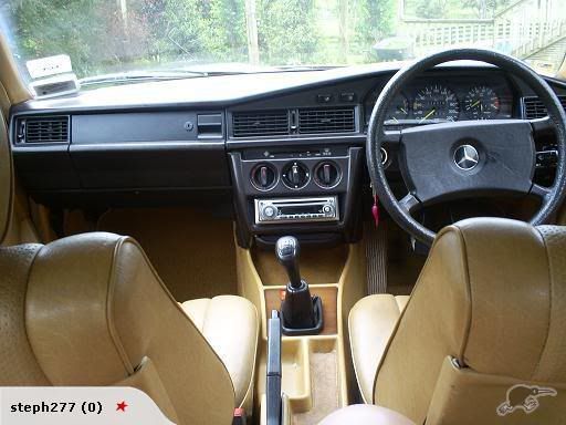

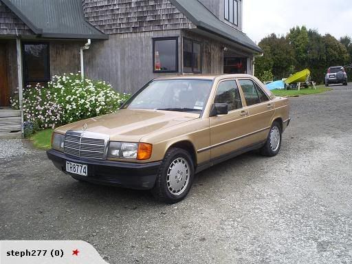

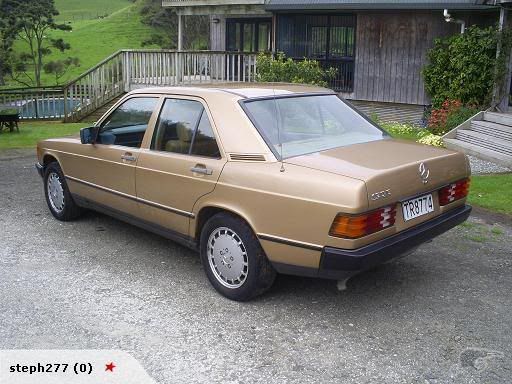

Thanks again for the tips. Some pics.
Posted ImagePosted Image
Posted Image
Looks tidy and from a good home! And the colour is almost perfect :)
