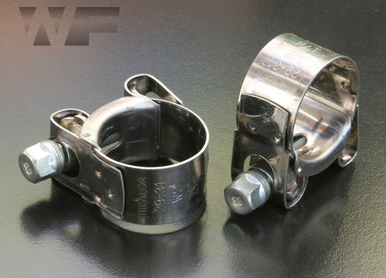

Mally Posted March 29, 2019 Share Posted March 29, 2019 The clamp the other guy used was a T bolt type, which are much stronger and more likely to work than your jubilee clip. tooSavvy 1 Link to comment Share on other sites More sharing options...
SiC Posted March 29, 2019 Author Share Posted March 29, 2019 The clamp the other guy used was a T bolt type, which are much stronger and more likely to work than your jubilee clip.I bought one of them but it was too small to fit. I plan to get a bigger one and put that on it. Link to comment Share on other sites More sharing options...
