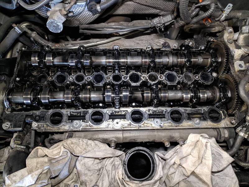

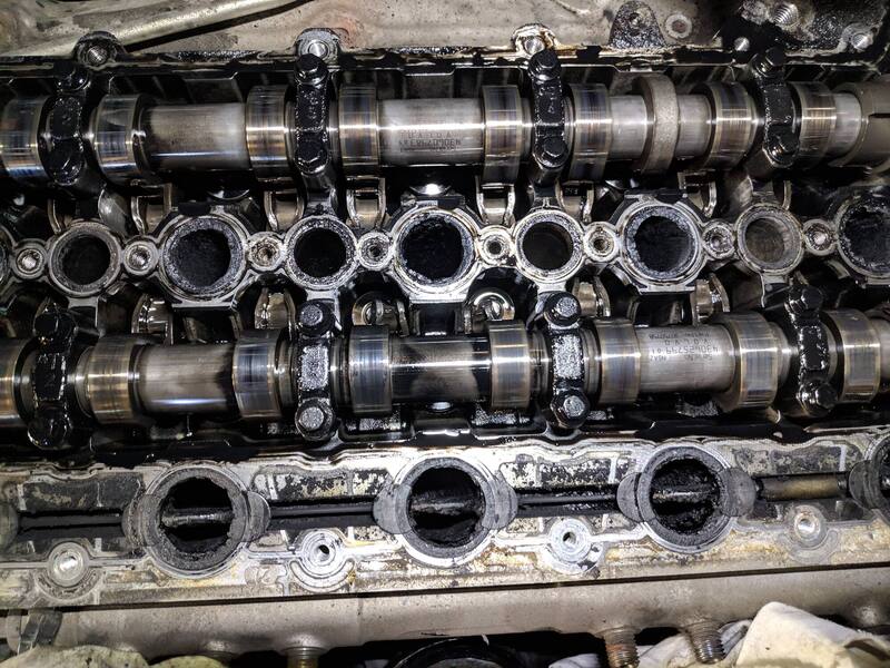

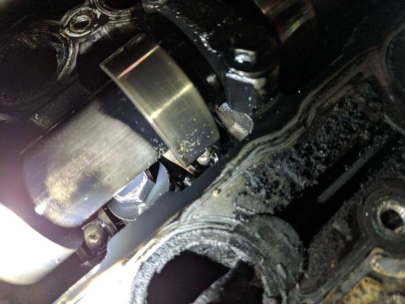

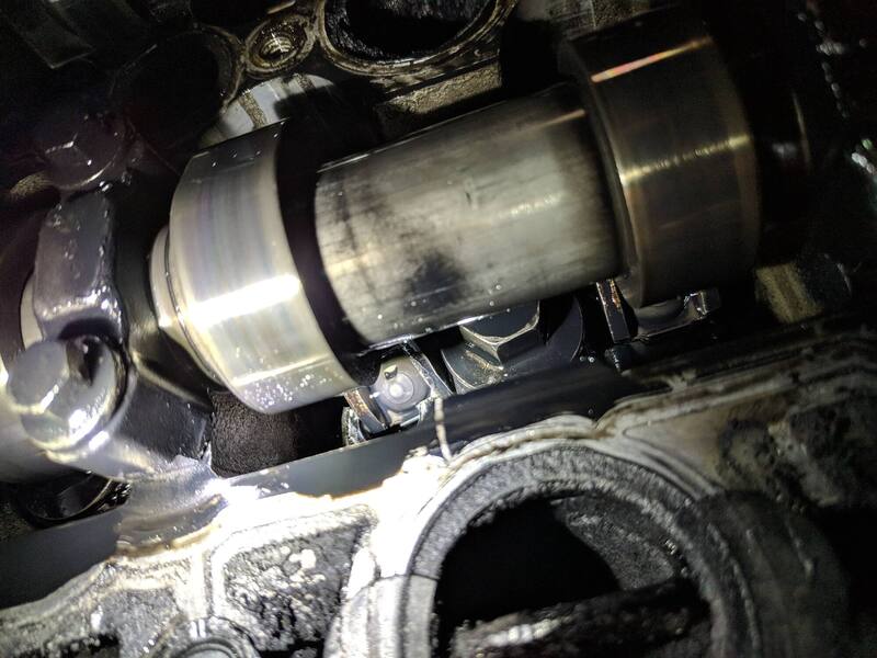

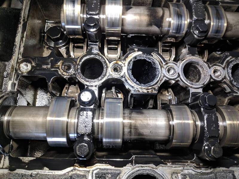

Tepper Posted July 26, 2019 Share Posted July 26, 2019 Finally I've had some time to play with this. Having tried a variety of other things, I figured it was about time to pull my finger (and the injectors) out. 3 out of 5 have come out without too much of a fight, 2 are stuck in. I have an injector puller/slide hammer thinghy on the way. While I was trying to pop the injectors out by turning the engine over, I noticed the sound of one of the cylinders was different to the other 2 with the injectors removed - rubbish video attached for your enjoyment. Listening to it, I'm thinking that could well be some kind of valve trouble, so am looking forward to getting the last 2 injectors out and hopefully finding out WTF is going on. VID_20190726_133044.mp4 trigger and Dirk Diggler 2 Link to comment Share on other sites More sharing options...
NorthernMonkey Posted July 26, 2019 Share Posted July 26, 2019 My money is still on head casting/follower or rocker damage. Had another 185bhp in the other day with exactly the same issue. Link to comment Share on other sites More sharing options...
Tepper Posted July 26, 2019 Share Posted July 26, 2019 3 hours ago, NorthernMonkey said: My money is still on head casting/follower or rocker damage. Had another 185bhp in the other day with exactly the same issue. I've got a nasty feeling you're right. On that last one, how did you get the injectors out? Did it end up getting bridged or did you fix it? Link to comment Share on other sites More sharing options...
NorthernMonkey Posted July 26, 2019 Share Posted July 26, 2019 Injectors came out ok...one was a bit sticky but it shifted with a bit of persuasion, then a recon head. Tepper 1 Link to comment Share on other sites More sharing options...
Wingz123 Posted July 26, 2019 Share Posted July 26, 2019 I've left injectors soaking in oven cleaner when trying to get out. Spray the crap out of them and let it soak in and around but I guess that is more when you have a case of black death. Patience is a thing of beauty when it comes to this.....something I lack! Hope you are well besides! I sold my XC90 in the end to a mechanic who was going to repair the alternator and give to his wife. James Tepper 1 Link to comment Share on other sites More sharing options...
Tepper Posted July 31, 2019 Share Posted July 31, 2019 On 7/26/2019 at 5:33 PM, NorthernMonkey said: My money is still on head casting/follower or rocker damage. Had another 185bhp in the other day with exactly the same issue. Bang on the money! Now to find a replacement head, someone to repair this one (apparently possible?) or just a secondhand engine. I'm amazed it didn't sound worse looking at the state of things in there! Link to comment Share on other sites More sharing options...
