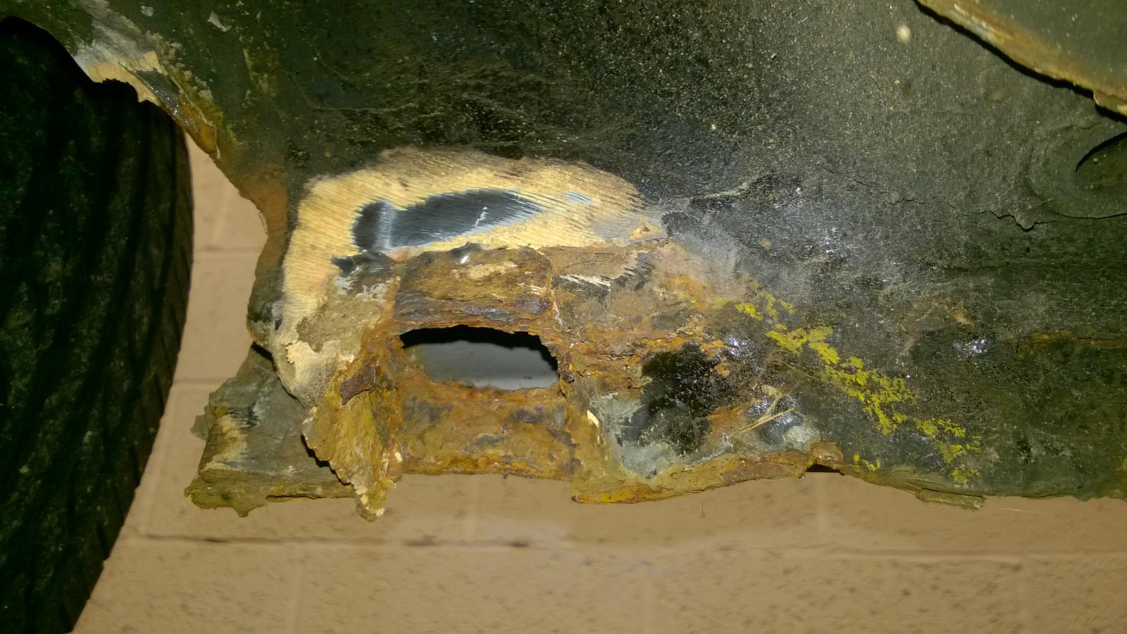

Posted 01 March 2019 - 04:11 PM
Very good day but knackered now, few pics before, I will add more info when I get home.WP_20190301_10_36_52_Pro.jpg WP_20190301_10_41_57_Pro.jpg WP_20190301_10_55_37_Pro.jpg WP_20190301_11_24_38_Pro.jpg WP_20190301_14_45_02_Pro.jpg WP_20190301_15_21_13_Pro.jpg
Soooooooo it’s been a long but very productive day. Rust was duly cleaned back, one rear corner was less bad than expected but the front floor made up for it. It’s not unexpected as it usually gets worse once you start digging about. In between making up repair pieces and hitting stuff with a hammer I did a quick oil change. The oil that came out didn’t seem too bad. I didn’t even look at the brakes or suspension apart from a liberal dose of penetrating fluid.
Then the idle........ As I need to be able to move it about a bit I decided to look at that as a matter of importance. It has about 3/4 of a tank of petrol in but when I removed a plug and cranked it over the fuel has a bit of a stale smell so may be past its best. That’s no problem though as I can suck it out and put it through the wife’s 500 to get rid of it or I will just brim the tank and go for a good run. It doesn’t like to idle, it really doesn’t like to idle, but the runs ok once above idle. So being an old fashioned sort of bloke I decided to look at a simple solution. The black plastic bits in the pics are nylon 66 shims that sit between the throttle cable and it’s stop. In the pic they are unfinished and just as they came off the lathe, a quick whip around with a knife and then a slot cut to get them on and they work a treat. There is no adjustment on the throttle body or cable but this seems to have helped enormously. It will now idle happily around 1000rpm and picks up ok. I know it can’t be that simple but for now it’s working ok. I have had a message to say Yodel have delivered the throttle nosy and it doesn’t appear to have stud marks or bits of grease on it so I may have been lucky! Here’s hoping! And next Friday will be brakes and suspension arm day........

Posted 01 March 2019 - 04:20 PM
Mate, looks like you coated the underneath in the old engine oil.
  • Tamworthbay likes this

Posted 01 March 2019 - 04:22 PM
I didn't get time to do any decent pics so that is literally after a quick spray of Schultz, it needs finishing but I ran out of time.

I managed to get a few more hours in today and it’s been good and bad. The welding is finished and seam sealed, then will paint next week and it’s all done. It’s taken about 5 hours in total. No idea how, time just seems to speed up when you are welding. The suspension arm has been changed. It fought me a bit but I think I know ‘the trick’ now. It has an inner mounting point, anti-roll bar attachment and the ball joint. At first I fitted the inner and roll bar joints and tried to manoeuvre the ball joint into place. After about half an hour of getting it sooooooooo close I decided to try the other way and it went it relatively painlessly. Then came the brakes. The second pic should give an idea of why the brakes failed. One pad is down to the metal and that side of the disc is royally shagged. The excellent news is that the sliding pins of the caliper are immaculate and sliding nicely and the piston is also very clean and went back in an absolute treat. The new disc apwas put on and I was feeling pretty smug. Then I opened the brake pads to find they are for Girling not Bendix brakes. They were from SOC on here who had both types so guess it was a simple mistake on which was which. Unfortunately that stopped play for today on the brakes :-( I had just under an hour spare so started to play with the washer pump. It was a sod to get the terminals off and they look pretty ropey. I then fired up the pump on a dc supply I have and nothing. Half an hour stripping it as far as you can and then cleaning it out saw it firing into life and spitting a load of crap over me. Success. It’s still a bit intermittent but I only put 6v through it as the dc supply doesn’t regulate amps (well not under about 20A) so it’s easy to fry stuff if you aren’t careful. Hopefully a liberal use of contact cleaner and 12v will see it running. Then it’s just the fog light and number plate light to check over and potentially this time next Friday I could be looking at booking an MoT!
WP_20190308_09_47_19_Pro.jpg WP_20190308_09_52_49_Pro.jpg WP_20190308_11_47_06_Pro.jpg
