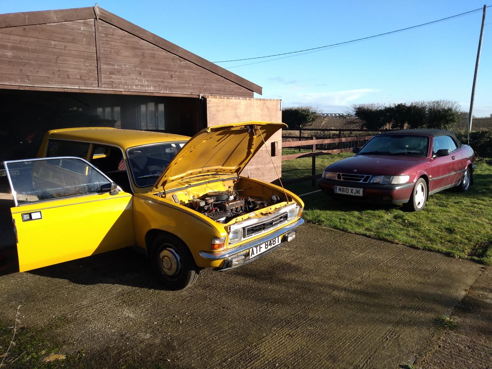

Craig the Princess Posted January 17, 2019 Author Share Posted January 17, 2019 The trip computer yesterday went up from 23.2 mpg (at a guess city driving) to 32.2 mpg when it went pop. I thought the fuel gauge would have dropped faster than it did. Today things where shunted around, the Lagoon Blue Allegro that almost killed DW has gone over to BeEP to be sold as a project to keep the fleet numbers down. That meant the Metro Mayfair could go in its place and the Saab can go on the concrete pad. To do that the yellow Allegro estate was driven out, and decided to piss petrol all over the floor. Also managed to adjust the hood clip so it didn't foul on the cover and the roof can shut (but won't latch) and mopped up the puddle in the hood recess. bolognasal spray, Dan_ZTT, Dirk Diggler and 14 others 17 Link to comment Share on other sites More sharing options...

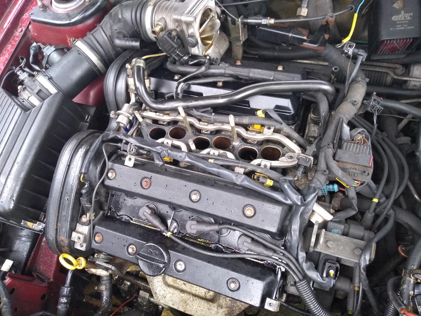

Craig the Princess Posted January 23, 2019 Author Share Posted January 23, 2019 I had a spare five minutes before work earlier. Decided to see what removing the engine cover would reveal, especially if I could see the heat exchanger. The red screws were added last time it was in Norfolk, from an Austin 1100. Of course one was seized in and needed some help. Revealed bugger all, so I gave up and had a hot bath. There doesn't seem to be a V6 manual available so I've got one for a Senator being delivered. Six-cylinder, Burnside and mrbenn 3 Link to comment Share on other sites More sharing options...

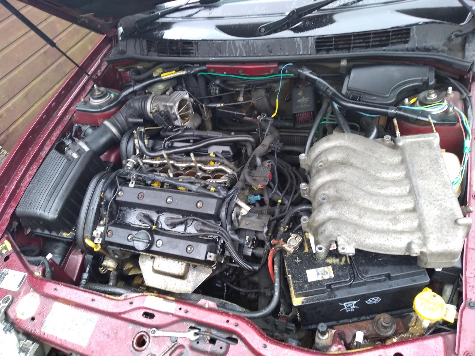

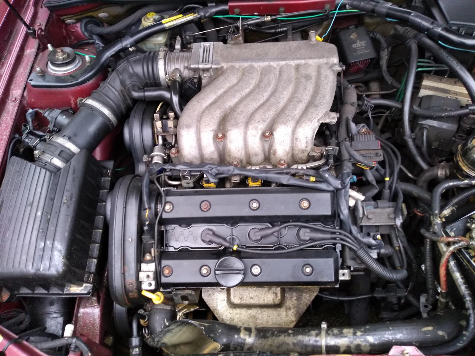

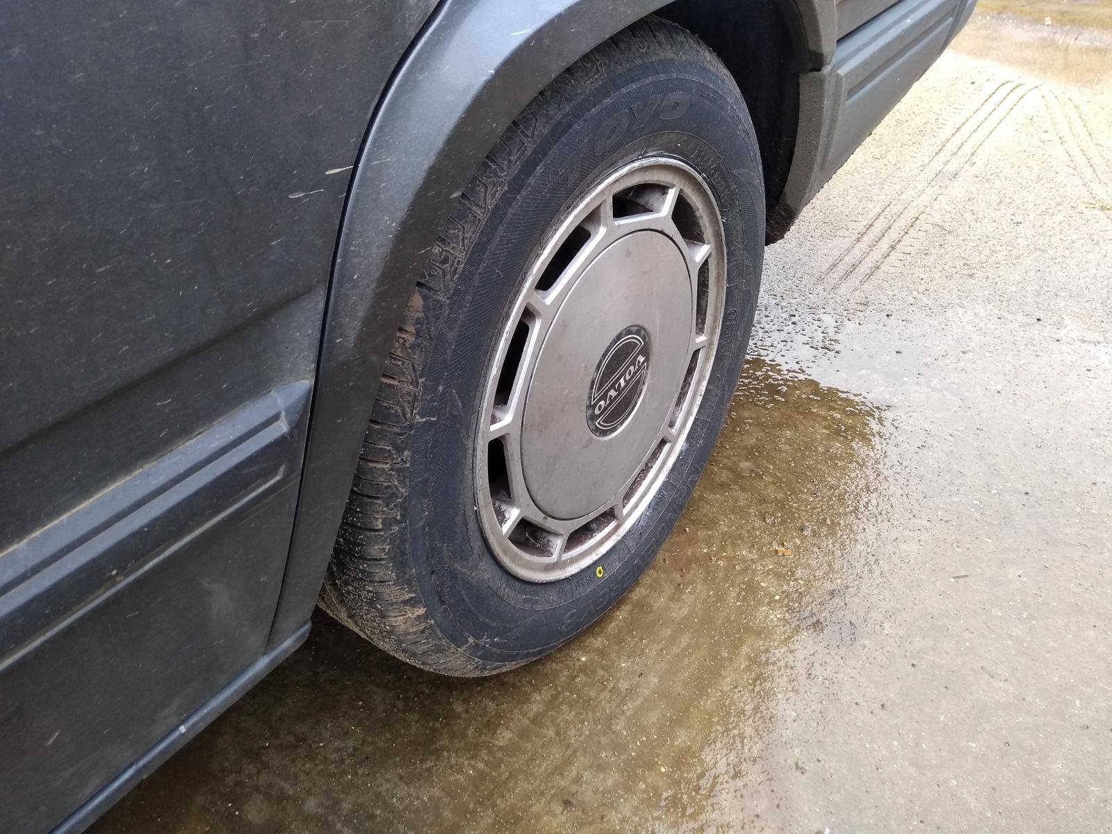

Craig the Princess Posted February 8, 2019 Author Share Posted February 8, 2019 BeEP came over yesterday and we had a game of five the heat exchanger. So removed the cast cover over the V and the inlet manifold. No idea where it is. Next stop I think is to remove and clean out the mayo from the radiator and follow the cooling pipes with more engine visible. Never known an engine to have no manuals or on line guides. There is also a plan to get round the lack of top hoses in Europe by using two E-series Allegro hoses which are dirt cheap. In other Swedish news the Volvo 940 now has the 740 wheels (big thank you to JohnF and ohdearme for getting them). They now sport new Toyo Nanoenergies all round and look a lot better than the 850 steel wheels with spacers to make them fit at the front. somewhatfoolish, Burnside, Sigmund Fraud and 4 others 7 Link to comment Share on other sites More sharing options...

omegod Posted February 8, 2019 Share Posted February 8, 2019 It's a GM lump that isn't renowned for OMGHGF, weak spot on these is the oil cooler in the V rotting through allowing oil and coolant to cometh togehter in a creamy mess This guide should show you whats possibly going on, different intake manifold due to engine orientation but you'll get the gist http://oldsite.omegaowners.com//forum/YaBB.pl?num=1221081908 BeEP and Craig the Princess 2 Link to comment Share on other sites More sharing options...
