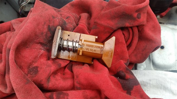

Guest Hooli Posted January 18, 2019 Share Posted January 18, 2019 Smoll preview for tomorrow. ..Two tensioners and four bolts don't look much for £103 do they? Slightly* cheaper than an engine rebuild though so worth it for piece of mind. dome, LightBulbFun, Broadsword and 3 others 6 Link to comment Share on other sites More sharing options...

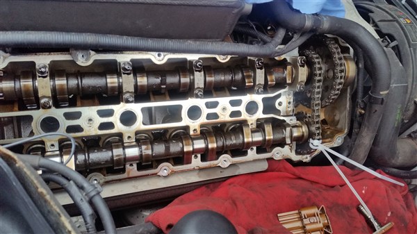

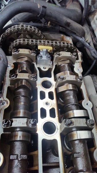

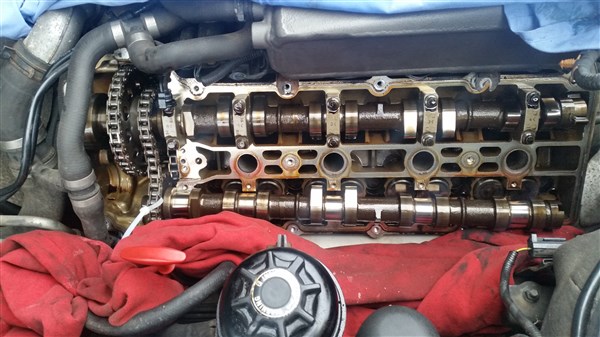

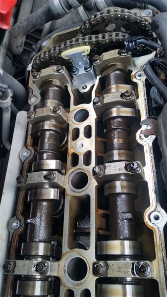

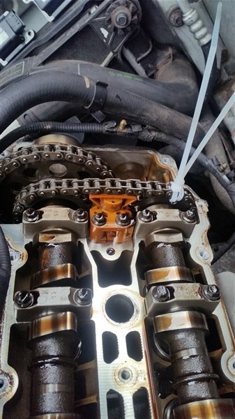

Guest Hooli Posted January 19, 2019 Share Posted January 19, 2019 Now then, I guess it's time for a write up of today's entertainment & ghetto techTM. Firstly the secondary timing chain tensioners. Rather than spend £250 or so on locking tools I used ghetto techTM as will be seen later. First things first, get the cam covers off both sides & set the engine to TDC. As there are no timing marks I just made sure the cam's were at TDC by aligning the timing flats on top of them. I didn't need to do this, but it gave me a handy visual reference that it'd all gone back together about right. I then attached the ghetto techTM timing devices, they are the white objects that looks very similar* to cable-ties. This is the RH side, you can see the timing flats up near the sprockets. The next step is to remove the cam journals on the exhaust cam. Once the cam is free to lift out (except for the sprocket) you can get the tensioner out by lifting the cam an inch or so. Leaving you with this. Then it's just a case of putting the new tensioner in, tightening the cam down again. Pulling the locking pin out of the tensioner to release it & you're left with this. The other side is of course just a repeat of the above, with the exception of noting the tensioner is sprung upwards on the LH side not downwards like the RH side. This is due to the direction the cams turn as the tensioning spring always runs on the return not the drive side of the chain. I then removed the cable-tie resembling ghetto techTM locking tools and confirmed the cams were still timed correctly together with the ghetto techTM timing checking tool. I did both sides, but I'm sure you can imagine what the other cams looked like when checked. I turned the engine over two complete revs with a spanner on the crank bolt & rechecked the cam timing was still ok. It all looked good, so I put the covers etc back on, turned the key & it fired up smooth & happy. I'd call that a result. The old tensioners looked like this, you can just see cracks appearing near the centre where oil is stuck in them so they show up as black. They've have lasted ages before failing, but it's one thing I don't need to be concerned about now. After a cuppa I used my new eazi-bleed to put about 1.5ltrs of brake fluid through the system to ensure all the old fluid got flushed out or every pipe. I've not test driven it yet to see if the brakes are better but I suspect so as the old fluid was very pale and didn't feel like brake fluid, so might have been original. yes oui si, Fat_Pirate, Shirley Knott and 20 others 23 Link to comment Share on other sites More sharing options...

richardthestag Posted January 20, 2019 Share Posted January 20, 2019 ghetto tech is for winners, makes perfect sense to me and failproof I reckon awesome Link to comment Share on other sites More sharing options...
Guest Hooli Posted January 20, 2019 Share Posted January 20, 2019 To be fully fail proof a piece of plastic or wood should be shoved in a hole for the primary chain sprocket to trap the secondary chain there. But I figured as I'd put to TDC if it did slip it'd be pretty easy to put it back right so didn't bother. As it turns out I think you'd have to be pretty hamfisted to cause that anyway.I'd rate it as quite simple job, unlike all the internet scare stories. Just work though methodically & it's a doddle. chodweaver and richardthestag 2 Link to comment Share on other sites More sharing options...
