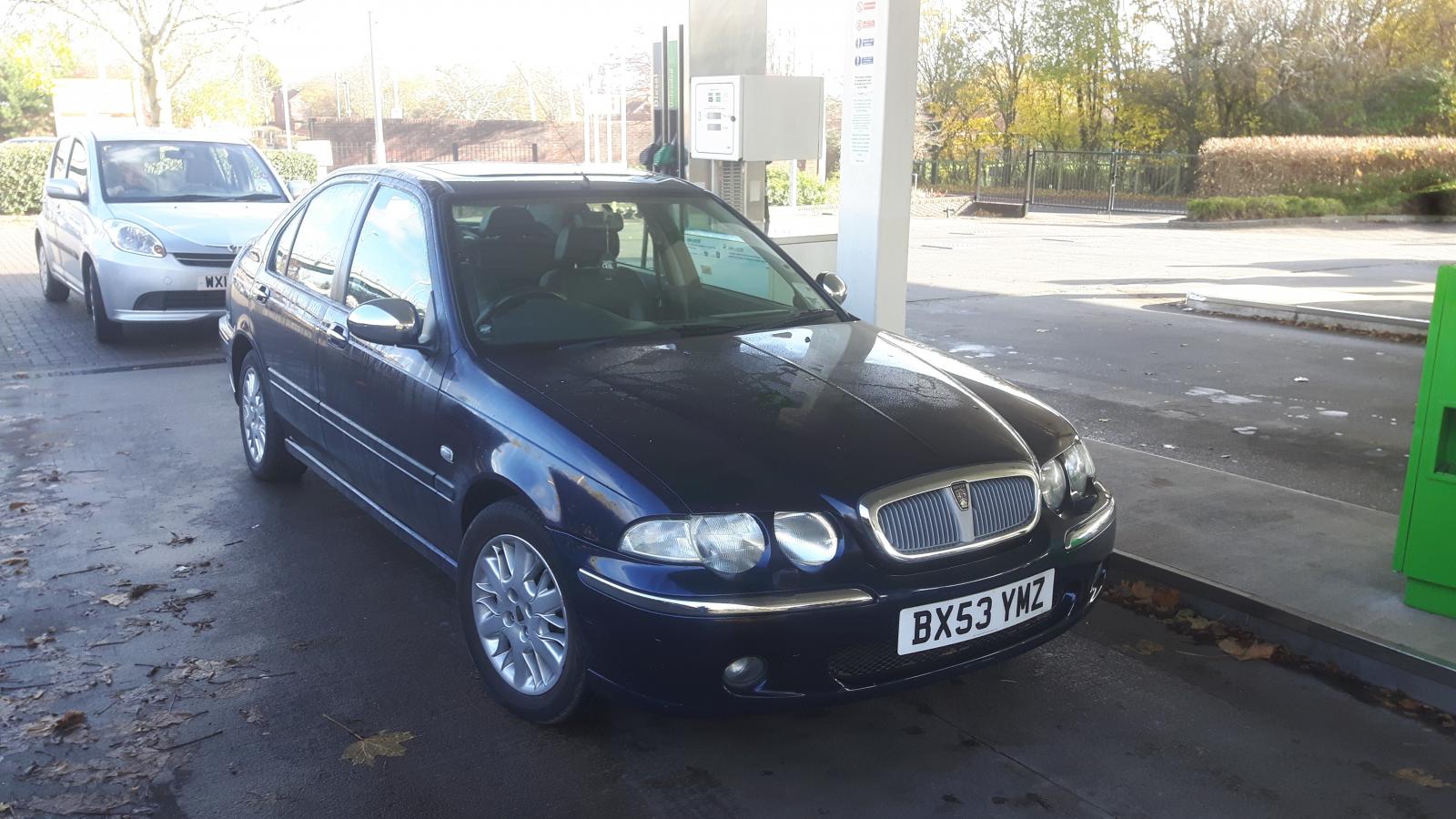

Steve79 Posted November 12, 2018 Author Share Posted November 12, 2018 I've managed to avoid both breaking down and also being murdered to bring you this diz (not pez) shot update. More pics to follow shortly dome, michael t, BeEP and 11 others 14 Link to comment Share on other sites More sharing options...

GeordieInExile Posted November 12, 2018 Share Posted November 12, 2018 Mmmmmm, very nice. What's the spec? oldcars 1 Link to comment Share on other sites More sharing options...
Steve79 Posted November 12, 2018 Author Share Posted November 12, 2018 The drive back home was interesting to say the least! It was clear that the Rover hadn't been driven in a good few months. The brake discs were rusty as you like and it smoked a little on startup. It seemed to drive round the block ok and idled cleanly so paid up and off i went. All was well for about five minutes until there was a funny burning smell! Pulling up to a set of traffic lights,i was rewarded with a cloud of acrid smoke emanating from the o/s front wheel. Hmm seized caliper then! Decision, park up and wait for the disc to cool or press on for the remaining five miles home? The latter was chosen, reasoning that the cooling breeze from driving along would suffice! Got back ok but disc was glowing cherry red. Rightly or wrongly, i lobbed four 2litre bottles of water at the offending disc to cool it down. Just been out in it and It seems to have solved the issue as the caliper is no longer binding. I wasn't expecting a lot for the derisory amount that i paid for it but have been pleasantly surprised. The difference compared with driving a modern diesel is like chalk and cheese. The L-Series feels very agricultural and sounds like an old school diesel should - clattery. You have to drive it a totally different way as you don't get that instant response like on a modern turbo diesel. I had one of these diesels many years ago and forgot how much i enjoy driving them. Only bad part of the body, been hit in the past and lamp cluster has yellow car breaker writing on it. Best part though Seems that from looking at the MOT history, the car was off the road from 2011 through to 2017 which explains the low mileage. My guess is that an old giffer died and it got left in the garage. I've got zero history with it but it looks like it has been taken care of over the years. Needs a few minor jobs doing such as aircon regas, tack the sacking headlining up, sort the saggy door trims out and try and fix the fecked Pekatron Trafficmaster clock. The engine management light is on and delphi shows the code as P0251: Fuel Pump Control Unit - Signal out of range. I've tried resetting but light comes back on almost immediately. Its doesn't seem to affect the car in any way in terms of causing any performance, emissions or economy issues. Airbag light comes on intermittently which is hopefully just the seat connector. Stank of dog as well so whole interior got the shake and vac treatment. Service bits being acquired tomorrow as oil is black as night! michael t, Aston Martin, Springer and 8 others 11 Link to comment Share on other sites More sharing options...

clayts450 Posted November 12, 2018 Share Posted November 12, 2018 L-series diesel for the win, well chodded sir. Brakes on these 45/HHRs are a known weak spot - when I bought the V6 two of the calipers were completely FUBARed and binding for England. If you feel up to it definitely worth spending some time checking over the calipers as the guide pin bolts (especially the top ones on the front) have a propensity to seize, and the piston seals usually have bloody great holes in them. Bigg Redd do repair kits. Clock - TADTS - replacing is a bit of a faff as it's centre console out I believe. Whole heap of recommendations on P0251 over at MG-R Forums - start here, I reckon : https://forums.mg-rover.org/diesel-forum-104/45-diesel-cut-out-wont-start-291277/index2.html May just be an iffy sensor if you're lucky. Vince70 1 Link to comment Share on other sites More sharing options...
