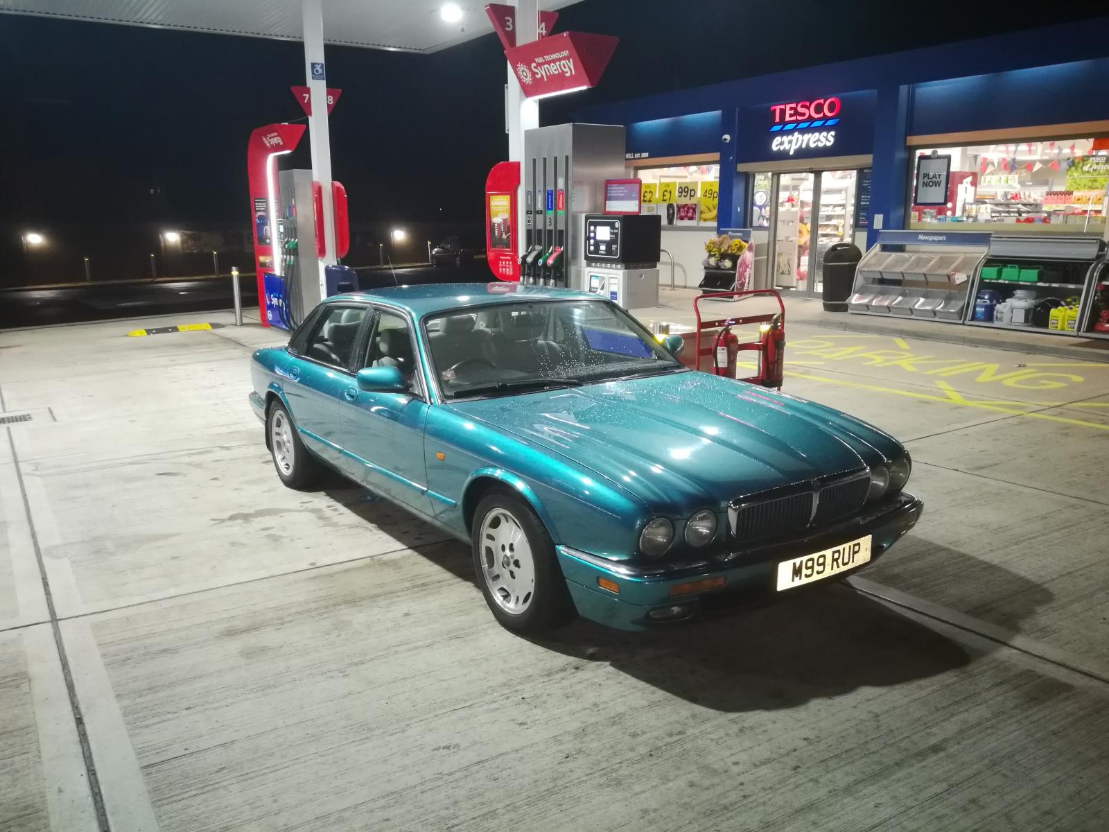

Rave Posted July 28, 2018 Author Share Posted July 28, 2018 A pez shot you say? I daresay this will become a familiar scene. I've put 10 gallons in and it reckons a range of 262 miles. That'll get me back to London at least. Better get on with it, got chatting to Tom and his lovely wife, nearly midnight now! Next stop Beaconsfield for a 2am McDs, I reckon. Tickman, DeeJay, brickwall and 33 others 36 Link to comment Share on other sites More sharing options...
Matt Posted July 28, 2018 Share Posted July 28, 2018 There are certainly far worse cars for late night wafting. Is it LWB too? Rave 1 Link to comment Share on other sites More sharing options...
Rave Posted July 29, 2018 Author Share Posted July 29, 2018 No, it's a SWB 4.0 Sport. I've made it to Beaconsfield and found I didn't really fancy a big mac meal, so I've had a free latte and a paid for chocolate muffin instead. Might make it home in an hour with a following wind I reckon. warren t claim 1 Link to comment Share on other sites More sharing options...

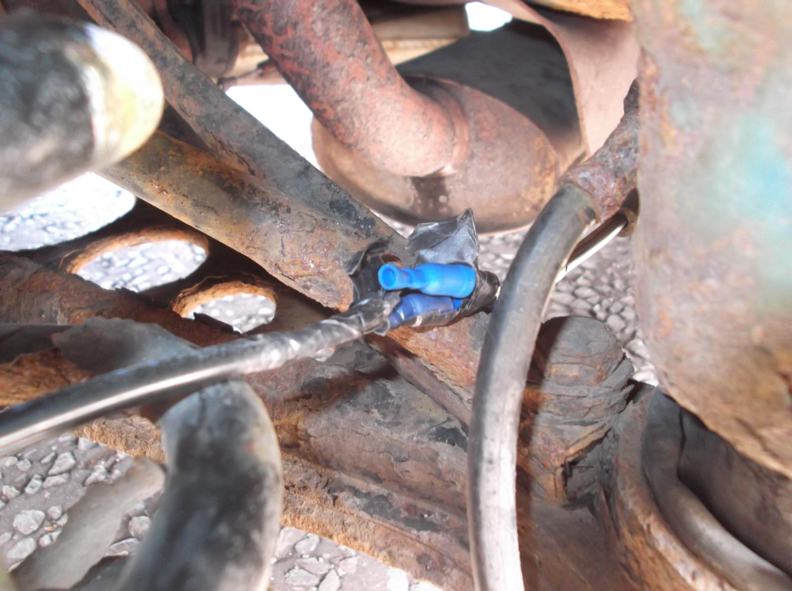

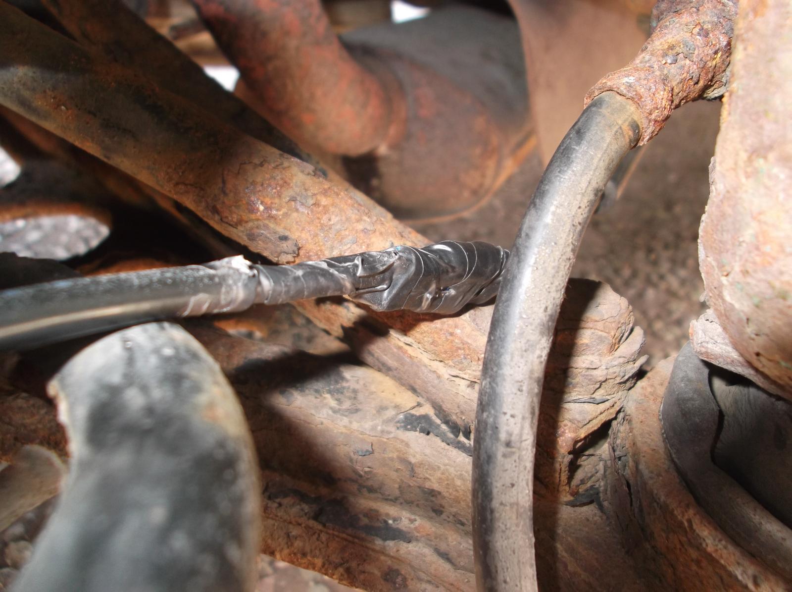

Rave Posted September 7, 2018 Author Share Posted September 7, 2018 Time for a small update, and hopefully to pick the brains of the people on here who know these cars. Basically it did me proud while my right arm wasn't working very well, got back from Yorkshire absolutely no bother. Unfortunately while taking a diversion round the crappily surfaced roads of rural Kent I hit a pothole and the exhaust volume suddenly doubled. I had no real option but to just drive it home again like that, and have done a couple of short trips in it when friends have asked for a ride in it, but it spoils the relaxed ambience somewhat. To be fair to the seller he had said that he thought the exhaust needed a fettling. Anyway today I finally parked it up on the raised kerb outside my house and crawled under for a shufty. I found that the LH intermediate pipe, the one that goes up and over the rear axle, has broken completely behind the silencer, just behind the weld where exhausts always seem to go. So fair enough, I need a new one. An ebay seller has them for £72.50 delivered, which doesn't seem hugely unreasonable, albeit rather more than the complete system I fitted to my 106 a couple of months back. Jags cost more to run than tiny diesel pugs eh, who knew? So if that's the going rate my plan was to buy it and have a go at fitting it myself; and if I fail, get the garage I use for my MOTs to stick it on. Anyone know how easy it is to get the pipe over the axle? I'm not going to be able to get the car particularly high in the air. And talking of MOTs, it's due at the end of the month, and there's one other problem to solve, which is that the ABS light is on constantly- it's on when you turn the key and never goes out. The cruise control works fine, if that's relevant. The seller reckons he had it scanned and the culprit is the OSR sensor; I stuck my own cheapo ELM327 clone on and only got a couple of fault codes for the oxygen sensors, which apparently aren't enough to stick the EML on, so I'm planning to ignore them (they might just possibly be related to the blowing exhaust anyway). So my initial plan was to pull that wheel off and see about cleaning it up. If that doesn't work how would I go about changing it? Is it likely that the problem is in fact on the ABS pump or dry joints in the ABS ECU like all the scary results a google for "X300 ABS diagnotic" throws up? Link to comment Share on other sites More sharing options...
Guest Hooli Posted September 7, 2018 Share Posted September 7, 2018 I don't think el-cheapo readers do ABS codes on most cars so no surprise you can't see it. If sensors are cheap I'd try changing it. I had to do three on my XJ40 as the wiring had cracked where they flex with the suspension. I think I was paying about £25 2nd hand off ebay. As for the exhaust, mine snapped there on the offside & I got it welded up at a local place for about £20. Lasted till after I wrote the car off into a lamp post. Rave 1 Link to comment Share on other sites More sharing options...
The Moog Posted September 7, 2018 Share Posted September 7, 2018 Unless you enjoy exhausts and know it will come apart and have somewhere decent to work I would save hassle and get the garage to do the exhaust. Nothing funnier than covered in dust on your back, with an exhaust that just won't come apart and it starts to rain. Ohdearme, Rave and D Spares & Tyres 3 Link to comment Share on other sites More sharing options...
D Spares & Tyres Posted September 7, 2018 Share Posted September 7, 2018 Personally I would stick with the seller's diagnosis, he did seem to know these cars inside out! Rave 1 Link to comment Share on other sites More sharing options...

Rave Posted September 7, 2018 Author Share Posted September 7, 2018 In a masochistic way I quite enjoy lying under cars buggering about with exhausts. Replacing the 106 one was quite a satisfying job. To a certain extent I have little to lose trying it myself, it might end up really noisy if I succeed in removing the middle silencer box but not replacing it, but the garage is only a mile or so away so I could drive there without annoying too many people. Anyway I take it nobody knows a place doing exhaust intermediate pipes for less than 70 quid then? I'll order one up tomorrow if not. There's an ebay seller, Jaguar Spares North East who is also doing a service kit with a genuine oil filter, a not-specified air filter (paper filters are much of a muchness unlike oil filters, so fair enough), and 6 Champion plugs for 38 quid. Sound reasonable? I've always been an NGK plug man in general, but Champion seem to be OEM. Oddly I've seen conflicting advice on what NGK plaugs to use anyway, most people seem to think BCPR6E but one chap reckons BKR6 is the correct (ISO) shape. Might have to do yet more tedious googling. If they are BPR6 that may even be the same as my Mondeo- I replaced all the plugs in that with Iridiums, but the Ford platinum ones I pulled out looked immaculate. So I might even be able to use those. The idle is a bit rough, so worth trying new plugs I think. Link to comment Share on other sites More sharing options...
Rave Posted September 9, 2018 Author Share Posted September 9, 2018 I decided to investigate the ABS sensor today. Jacked the car up with my trolley jack under the rear subframe mount, which seemed to work OK. First problem was getting the wheel nuts off- the handbook isn't very clear, and mentioned something about covers for them, and a special tool to remove them, but having dug the jack kit out from under the spare tyre there was no such thing. The supplied wheel brace didn't seem to go over the nuts either. In the end I decided to just risk it with a 23mm impact socket out of my Halfords kit and they came off fine, revealing that the nuts are made of (now rusty) steel with a non-rusting metal cap on them. The caps didn't seem to get damaged even though I had to heave on the breaker bar to loosen a couple of them. The locking wheel nut adaptor required a 21mm socket, however- which the wheel brace appeared to be rather too big for. Quite how I'm supposed to change the tyre if I get a flat while I'm out and about I'm not sure- I'll have to think about that. I've no particular objection to buying a spare pair of 21 and 23mm sockets and leaving them in the car, but carting about a breaker bar at all times will annoy me, even though the car is bloody heavy to start with and it will make a trivial difference to performance/ fuel consumption. I suppose if I remove the existing wheel brace that will compensate somewhat. The trials of being a bit Aspergers, eh. Anyway having parked the car a bit close to the kerb I had to lift it up a bit more to get the (bloody heavy) wheel out, then I was able to have a nosy underneath, having shoved an axle stand under the inner wishbone mounting point to catch it if it fell off the jack for some reason. I soon found the ABS sensor lead, and was rather encouraged when I found that it appeared to have been bodged already: Once I'd removed the first layer of tape and had a feel I had a pretty good idea what I was going to find when I got in there, and thus it proved: The end of the wire came out of the bullet connector very easily, and at that point my level of hope for a successful re-bodge was considerable. I thought I'd better get the multimeter on it just to be sure, though, and sadly there was no continuity at all between the inner wire and the outer shield whatever ohm rating I set it to- apparently it should be about 1.7k according to a youtube video I found. I certainly don't think it should be infinity, at any rate . I suspect there is another break in the wire further along. Sadly, the sensors for these early X300s are about 200 quid for a new part, and an initial ebay and google search didn't show any used ones for sale- in any case a used one could be hanging on by one strand as they just seem to flap around in contact with the lower arm, and more worryingly, the halfshaft, though perhaps they're meant to sit between the coils of the spring. Or perhaps they're supposed to be clipped in somehow but the mounts have rusted off, like the rear bumper mounts...I found that the bumper is attached with a spider's web of zip ties held in place with a big blob of epoxy, which is a bodge I have no intention of attempting to rectify unless I have to. So anyway, I put the wheel back on, which was a pig of a job with my not-quite-recovered-from-its-break right arm, and have come in to have a think and post this. I guess if my only option for a proper fix is to shell out 200 quid for a new sensor, then I have little to lose by seeing if I can cut the wire an inch or so back from the sensor, attaching a new length of wire using single crimps rather than bullets, maybe soldering it as well, then heatshrinking it and going mad with the electrical tape, and running the new wire all the way to the connector? Incidentally, anyone know where the connector is- is it under the rear seat, or are there wonders to be revealed if I can figure out how to remove the bulkhead panel in the boot? I haven't investigated in there so far, partly because the (defunct) CD changer is in the way. Suppose I should remove that if I'm fussing about weight, twat that I am. Edit: found this article about X300 maintenance, which I'm posting here as an aide-memoire, as much as anything: http://www.exclusively-jaguar.co.uk/facts/production-modles/x300/x300-service-guide/ Fat_Pirate 1 Link to comment Share on other sites More sharing options...
