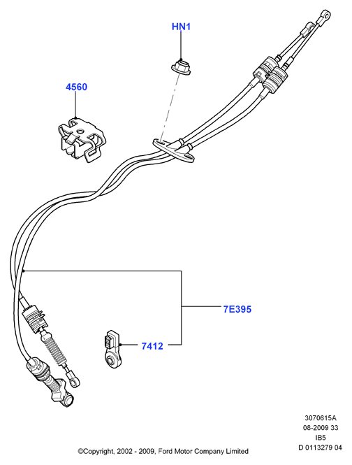

egg Posted July 19, 2018 Share Posted July 19, 2018 If I hadn't just smashed my tablet screen, I could have showed you a pic of what my manual one looked like (I took one a while back...) Looks clean in the pics. Here is the cables diagram Lankytim 1 Link to comment Share on other sites More sharing options...
Lankytim Posted July 19, 2018 Author Share Posted July 19, 2018 That pretty much what I have here, perhaps the cable is twisted and pulling itself away form the selector arm- I'll take it all off and stick it back together and see what happens. Maybe a strategically placed cable tie will cure things. Link to comment Share on other sites More sharing options...
egg Posted July 19, 2018 Share Posted July 19, 2018 HBOL says that the distance between the upper mounting clip (centre of the adjusting section) and the centre of the end fitting on the transmission should be 138mm (+/- 2) does that help any? Link to comment Share on other sites More sharing options...
Lankytim Posted July 19, 2018 Author Share Posted July 19, 2018 Yes it does, or it will do when I next get chance to have a look at it! Link to comment Share on other sites More sharing options...
dave21478 Posted July 19, 2018 Share Posted July 19, 2018 Are we talking about the cable coming down to the bottom of your pic? The lever on the gearbox needs to move straight up and down from the viewpoint of the photo but the cable is pulling and pushing at quite an angle...I know its got a ball-joint to compensate but is it in the right place? I have no idea whats further up, but it looks to me like the whole cable needs shifted an inch or two to the left at the top of the pic so the cable is straighter and working on the axis of the gearbox lever. egg 1 Link to comment Share on other sites More sharing options...
Noel Tidybeard Posted July 19, 2018 Share Posted July 19, 2018 is the starting issue something to do with the neutral position inhibitor switch not being there any more? Link to comment Share on other sites More sharing options...
egg Posted July 19, 2018 Share Posted July 19, 2018 Are we talking about the cable coming down to the bottom of your pic? The lever on the gearbox needs to move straight up and down from the viewpoint of the photo but the cable is pulling and pushing at quite an angle...I know its got a ball-joint to compensate but is it in the right place? I have no idea whats further up, but it looks to me like the whole cable needs shifted an inch or two to the left at the top of the pic so the cable is straighter and working on the axis of the gearbox lever. HBOL pic does show it at less of an angle. Link to comment Share on other sites More sharing options...
Lankytim Posted July 19, 2018 Author Share Posted July 19, 2018 I think thats the main issue, the cable needs to come straight down but it's at an angle. Noel Tidybeard, the starting issue has been cured! I think it was down to fault being detected by the semi auto ECU which automatically prevents the engine from starting. Link to comment Share on other sites More sharing options...
