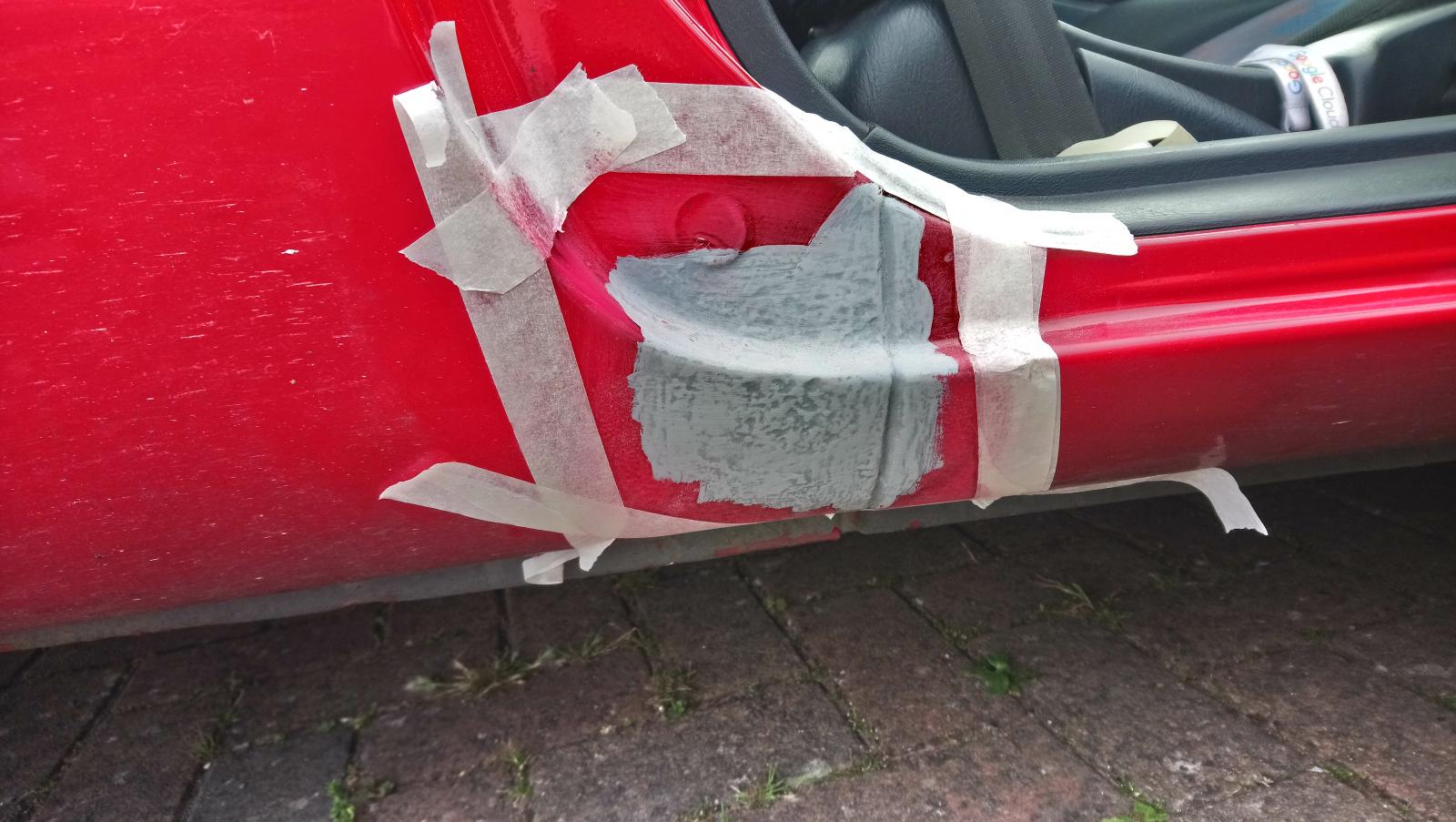

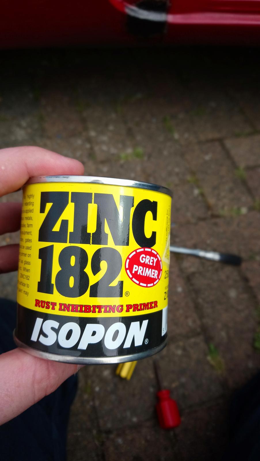

holbeck Posted June 7, 2018 Share Posted June 7, 2018 How recent is the rusty bleb on the driver side sill? I'll probably wire brush it, then whack some rust converter and primer on it this weekend and get a rattle can of toyota red to go over it with. Does anyone know if this gloop that toolstation sell actually works? The rust bleb is the same one that can be seen in red5's for sale photo's? http://autoshite.com/topic/31633-celica-18-16v-22-blah-blah/?do=findComment&comment=1481979 Link to comment Share on other sites More sharing options...

Stanky Posted June 7, 2018 Author Share Posted June 7, 2018 The rust bleb is the same one that can be seen in red5's for sale photo's? http://autoshite.com/topic/31633-celica-18-16v-22-blah-blah/?do=findComment&comment=1481979 I've found out the paint code so I'll get some rust converter and then prime, paint and lacquer it, its really odd - odd location and only surface rust by the looks of it. Still, its something to fix! Drove into work today and its a lot of fun to drive down a good road! holbeck and djim 2 Link to comment Share on other sites More sharing options...

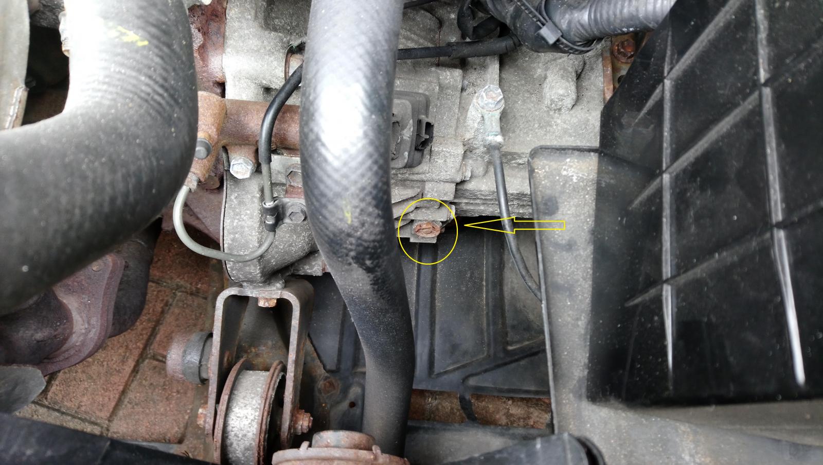

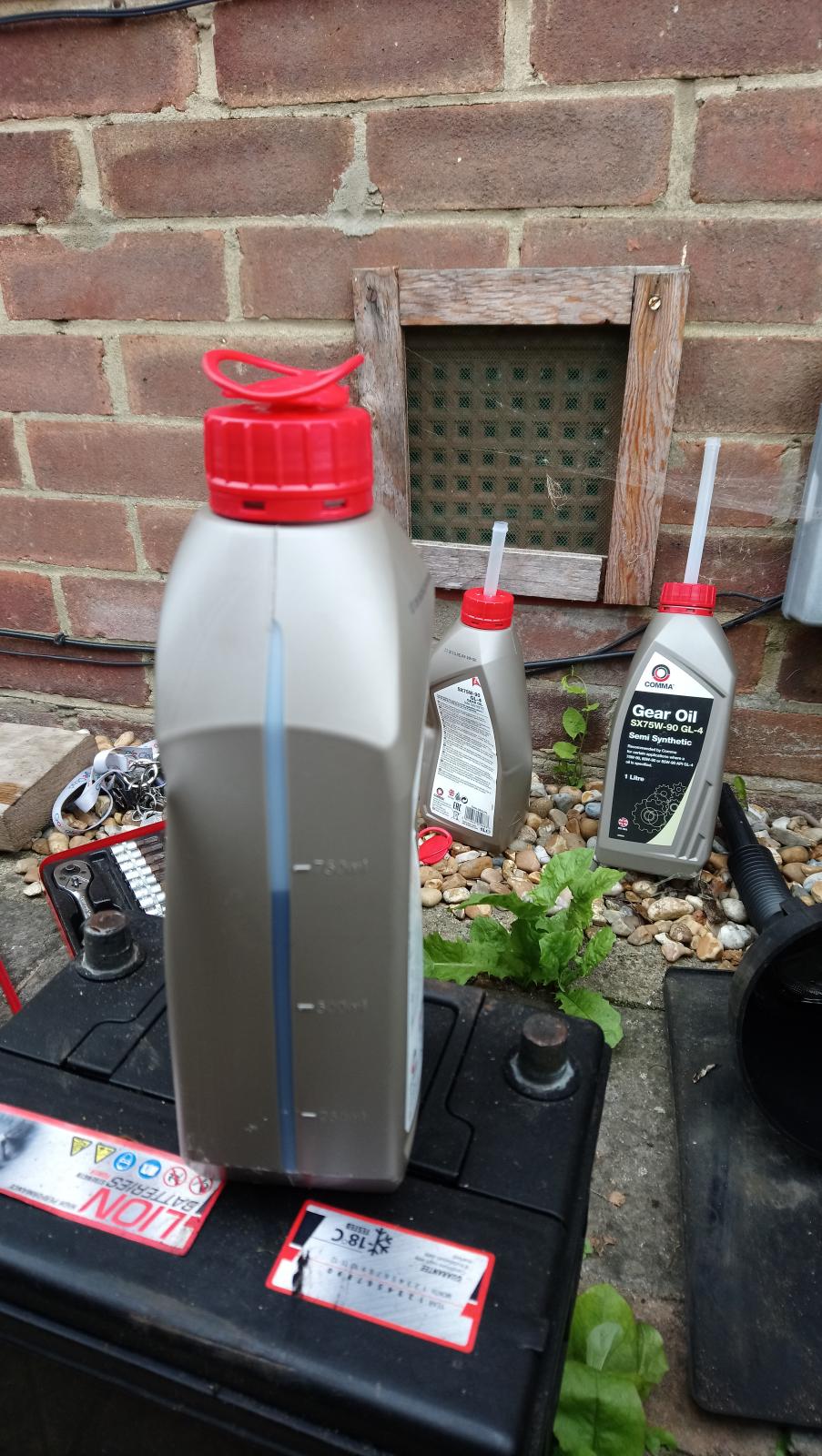

Stanky Posted June 17, 2018 Author Share Posted June 17, 2018 So, ignoring the doctors instructions I set to changing the gearbox oil in the Celica this afternoon. It was that or have a serious look at the rust bleb but since the weather looked a bit peaky I opted for the gearbox oil instead. red5 reckoned it was well overdue so I spent an amazon voucher on 3x litre bottles of Comma GL4 75w/90 gear oil which showed up last weekend. Looking up how to do it, it seemed relatively easy, jack car up, undo undertray, undo filler plug, undo drain plug, then reverse instructions. So, first up, I needed some access at the top to undo the fill plug. Its very important to do this first, because if this is stuck fast and you've already drained the old oil out you are buggered. Battery out This is the fill plug, its a 24mm hex bolt. with the battery out there is enough room to get a long 1/2" bar on it and with a heave it came undone. its a bit rusty but was less seized than the fill plug was on the Almera gearbox I did a couple of years ago. Next up, undo the passenger side wheel, jack the car up, slide the wheel under the sill with an old tyre on top as a stand. 2 of the 4 bolts I undid to remove the undertray sheared off, so I decided I'd just bend it back out the way rather than risk any more of them doing the same. This gave me enough room to get at the drain plug, this is it with a 24mm socket on it already Access isn't great TBH, if it was on a lift it'd be a lot easier, but the lower suspension arm is kind of in the way, anyway I managed to get it undone with the long bar without smashing any fingers which is what usually happens when i do things like this. The old oil drained out, it was sort of gravy coloured. It looks worse than it is in this pic as its under the car, but it was a bit grim. Its hard for me to guess if its original or not, I guess as it never gets exposed to combustion gasses it never gets really black like engine oil, but it was definitely a bit ming. So, out with the old, in with the new. I did the drain plug up and got the new oil. I carefully set up a clean funnel and spout then realised the bottles came with a natty spout thing built in The guide reckoned the box takes about 3 litres from empty, but you'll never drain all the old stuff out so 3x 1 litres should be fine. Luckily it was! I poured the first litre in the fill hole with my funnel and spout arrangement, then added another bottle by poking the built-in spot into the filler hole and squeezing the oil in. The guide said to keep squeeezing oil in until it flows back out the filler hole. seemed easy enough. It had taken 2 litres now, so i got the other bottle and squeezed some more oil in. It took about another 250ml then ran back out around the spout so I reckon its about right with 2.25L in the box plus whatever was left over. The new oil is very pale yellow colour, like vegetable oil. This was what was left over next up was to put it all back together. I did up the filler hole bolt without dropping into the skuddy old oil in the washing up bowl below, did up the filler bolt and drain bolt as tight as I could, then refitted the undertray with the two bolts that survived. It seems mostly OK like this. this was the old stuff that came out. Gearbox oil reeks. then wheel back on, and down off the jack/wheel&tyre stand and put the battery back in. I was knackered by this point, and the celica is boxed in currently so didn't take it out for a test drive. I'll probably do that tomorrow and see if the gearchange is improved. It was a bit notchy before so hopefully its made a difference. Next job will be treating the rust and repainting the sill, I've got all the bits I need, I just have to wait for a sunny day to do it. stay tuned for more repair action! Wingz123, Jim Bell, danthecapriman and 8 others 11 Link to comment Share on other sites More sharing options...
tobyd Posted June 17, 2018 Share Posted June 17, 2018 Gearbox oil is a close second behind brake fluid on the horrible car fluids scale IMO. did you trawl a magnet in the old stuff for instant win finds? Link to comment Share on other sites More sharing options...
Stanky Posted June 17, 2018 Author Share Posted June 17, 2018 Ha, I wasn't that brave! I'll assume that as its Japanese it probably doesn't do things like that. Having said that, the Almera had a magnetic drain plug so i'd be surprised if this wasn't magnetic too, and there was no 'glittering disappointment' on the drain plug on this one, unlike the Nissan. Link to comment Share on other sites More sharing options...
Wingz123 Posted June 17, 2018 Share Posted June 17, 2018 Are you going to take for a run and cycle through the P, R, N, D etc a few times then check the level again? I’ve got to do this on the Spacewagons autobox as the gear changes are a little violent and sometimes she revs up before revs die down again between gears.... Doubt the fluid has ever been done Good work Sent from my iPhone using Tapatalk Link to comment Share on other sites More sharing options...
Stanky Posted June 17, 2018 Author Share Posted June 17, 2018 This is a select-it-your-bloody-self gearbox but yes, tomorrow I plan to take it out for a run, I need to get the front wheels balanced really and am off work tomorrow so might as well do it then. If not tomorrow then the next day and see if the gearchange is improved. Autoboxes frankly scare me, and the only time I've needed ATF changed I farmed it out to a specialist to do for an altogether reasonable sum. To be fair, it did improve the smoothness of the changes dramatically and is now good for another 70k miles which will probably see the car out. This was on the Saab, details on the boring moderns section. I've ordered all the auxilliary belts from GSF and will be ordering the cambelt kit and water pump once some paypal money clears and will set about the belts with my brother (tobyd of this parish) next month. looking at access for most of them it looks like 3/10 for fun. Link to comment Share on other sites More sharing options...

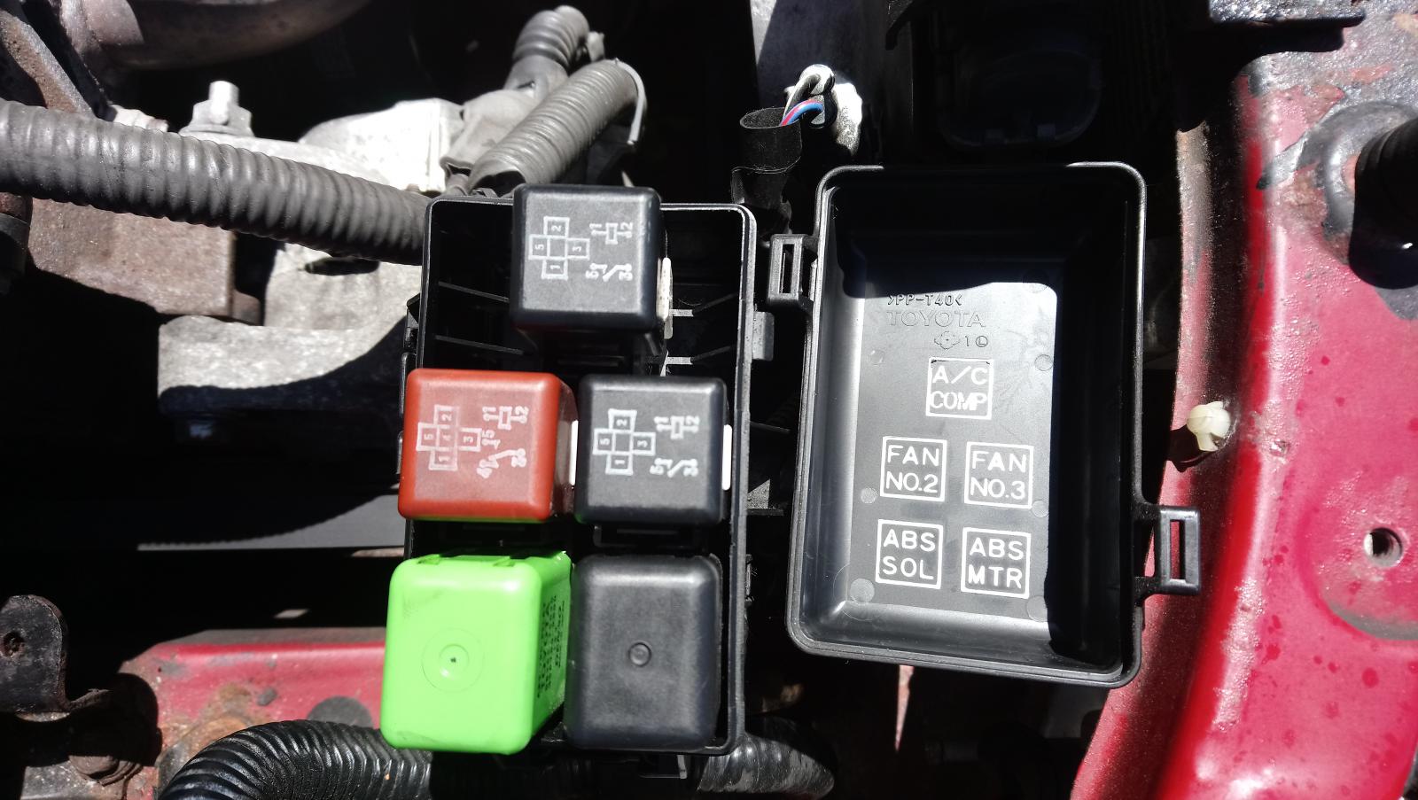

Stanky Posted June 27, 2018 Author Share Posted June 27, 2018 While buying the Celica, I knew there was an ABS issue. Today I went digging for what exactly it might be. The issue had been expertly hidden by tactical removal of the ABS light on the dash so step #1 was to reinstate this to work out whats wrong. The Celica predates OBD2 requirements in Europe as its pre-2001 so diagnostics involve small flashing lights and tactically deployed paperclips. Anyway, on with the writeup. To begin with, I had to take the instrument binnacle out to refit the ABS light bulb. Here we are at the beginning Its all held in with phillips screws, 4 removed and unplugged the headlight height adjuster and the lower bit comes off Exposing the lower screws for the upper bit of the shroud 4 more screws and the cluster lifts out. There is enough slack on the multiplugs behind to get the binnacle out behind the steering wheel, and then unplug them Flip it over and you can see the conspicuous absence of 2 dashboard warning lights This is the one we're after. I'd managed to misplace the ABS lightbulb (it subsequently turned up) so I swapped the airbag light into the ABS light slot and plugged the mutiplugs back in. I just sat the binnacle on the dash top rather than refitting it all because I knew I'd need to get it back out again. So, turn the key to position 2 and check it lights up. Ok good. well, not good, but not a surprise. Next up, deploy the shiters choice, the bent bit of wire. there is a 'diagnostics' plug in the engine bay you pop the cap open and pull out a bridging pin Then use the bent wire to bridge the slot marked E1 and the one marked TC. The bent wire I had was too big so I found an old paperclip and used that instead. It fitted perfectly. So, with the connections bridged, you then get in the drivers seat, turn the key to position #2 and watch the ABS light carefully. It lights up, stays on for ~3 seconds then goes off for a couple more seconds then you get a series of flashes which translate into codes, you look these up to work out what might be wrong. FFS really guys? Is that the best job you could do? *sigh* So, I was rewarded with: one flash - pause - one flash longer pause three flashes - pause - two flashes longer pause three flashes - pause - one flash 5 second pause repeat. So, thats ABS errors 11, 31 and 32 which according to this forum post from another forum I use translates to: 11 — Open shorted relay circuit. Check modulator wiring harness, solenoid relay, solenoid relay wiring harness and solenoid relay connector.31 — Problem in right front wheel speed sensor circuit.32 — Problem in left front wheel speed sensor circuit. that's annoying. I sort of hoped it was one sensor or something simple, sounds like its potentially several things. Oh well. So, troubleshooting. Step 1 was to check the ABS module fuse. Looks Ok to me. Curses. Alright, whats next? There is no info on whether the order the codes come out in means anything. They weren't coming out in numerical order (3-2 came before 3-1) so I decided to look at the solenoid first. My rationale was that if this was broken/malfunctioning then the 'downstream' codes may be false positives. Not sure if this is correct because electrical things frighten and confuse me in equal measures, but seemed logical at the time. So, pop open the relay box and have a look Ok well its not melted or anything visible, The wiring looks intact underneath and isn't chafed, so lets see if we can get it out to test it? Good grief, what a horrible job! You need to pop the bottom off the little house the relays live in, then lift it off its mounting bracket but there isn't enough slack cable to move it very far, so you have to slide in two blades to get the tangs on the side of the relay to unclip from the house, then wiggle it free. easy right? Ha. Because the house is smoll, and there are relays immediately below and next to the green one I needed to remove you can't get a good grip on the ABS relay to wiggle it out. I ended up resorting to VERY careful use of mole grips to grab the top of the relay and wiggle it as much as I dared. I was sure it was going to shatter and be ruined, but it eventually let go and came out And was rewarded with one ABS solenoid relay, minus the two tangs which had snapped off. Ridiculous piece of design. Now, there is nothing visually wrong with the solenoid, and I'm not sure how to test it. It has 6 pins and I have a multimeter, does anyone cleverer than me know how I can test the function of this? Or do I just go onto ebay and buy a replacement one for £8 and fit that in its place and see what happens? I suppose testing it will potentially highlight why the front circuit is sad, but the back circuit is fine? (assuming it has ABS on all 4 wheels, I think it does?) but what do i need to check? Have any of the previous custodians got any further than this, and potentially be able to rule out any other components? I've got loads of MOT left, but I take it the new rules mean I can't just forget* to replace the ABS light come MOT time and get a pass any more? It has to light up, and then go out and stay out, right? holbeck 1 Link to comment Share on other sites More sharing options...
Guest Hooli Posted June 27, 2018 Share Posted June 27, 2018 They should work like a relay as far as I know. You'd need a wiring diagram to know how to test it though, anything printed on it like relays often have? Link to comment Share on other sites More sharing options...
Stanky Posted June 27, 2018 Author Share Posted June 27, 2018 Sadly not, just the part number 88263-24030, the names Toyota and Denso 'Made in Japan' Link to comment Share on other sites More sharing options...
Stanky Posted June 27, 2018 Author Share Posted June 27, 2018 Gone mental and ordered a preloved relay from ebay for £6.14 delivered, due to land either friday or saturday so i'll put that in and repeat the process and see how we get on. It'd be nice if its that and the 'downstream' error codes are not real issues. Link to comment Share on other sites More sharing options...
Guest Hooli Posted June 27, 2018 Share Posted June 27, 2018 I guess with six pins it might switch front n rear separately so it could explain the wheel sensors issues. Link to comment Share on other sites More sharing options...

louiepj Posted June 27, 2018 Share Posted June 27, 2018 If your lucky the old relays cover is not too difficult to unseal or unclip for visual inspection for burnt points or electronics and if its switching ok. Relays should have clear covers as it's quite satisfying watching them trip in and out. Or that might just be one my perversions? mat_the_cat, Stanky and rainagain 3 Link to comment Share on other sites More sharing options...
