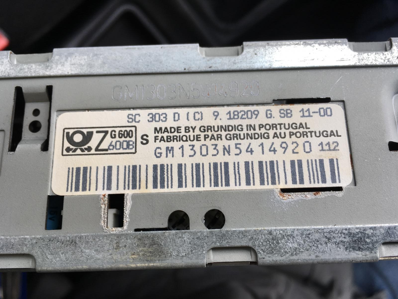

sutty2006 Posted March 2, 2018 Author Share Posted March 2, 2018 Anyone able to get radio codes? Link to comment Share on other sites More sharing options...
Scruffy Bodger Posted March 2, 2018 Share Posted March 2, 2018 Anyone able to get radio codes?Ask on this thread http://forums.moneysavingexpert.com/showthread.php?t=26827&page=3677 Link to comment Share on other sites More sharing options...
fordperv Posted March 2, 2018 Share Posted March 2, 2018 That looks much better on appropriate wheels Link to comment Share on other sites More sharing options...
tabact Posted March 2, 2018 Share Posted March 2, 2018 Posted the s/n on unlockforum.com, they came back with 'Main Dealer or a Decoding Service only for this code' Link to comment Share on other sites More sharing options...
Tickman Posted March 2, 2018 Share Posted March 2, 2018 I have had success getting codes for radios from the main dealer over the phone before. Worth a try. Link to comment Share on other sites More sharing options...
sutty2006 Posted March 2, 2018 Author Share Posted March 2, 2018 Main stealers want to charge 15 quid. Wanted to test the aerial too as it doesn’t appear to have one. The serial number is GM1303N5414920 for anyone willing to have a go Link to comment Share on other sites More sharing options...

fordperv Posted March 3, 2018 Share Posted March 3, 2018 Main stealers want to charge 15 quid. Wanted to test the aerial too as it doesn’t appear to have one. The serial number is GM1303N5414920 for anyone willing to have a go Message Joey and ask him, remember he m.o.t tests at Arnie Clarke's in hanley these days, maybe he could ask one of the lads to look it up for him Link to comment Share on other sites More sharing options...

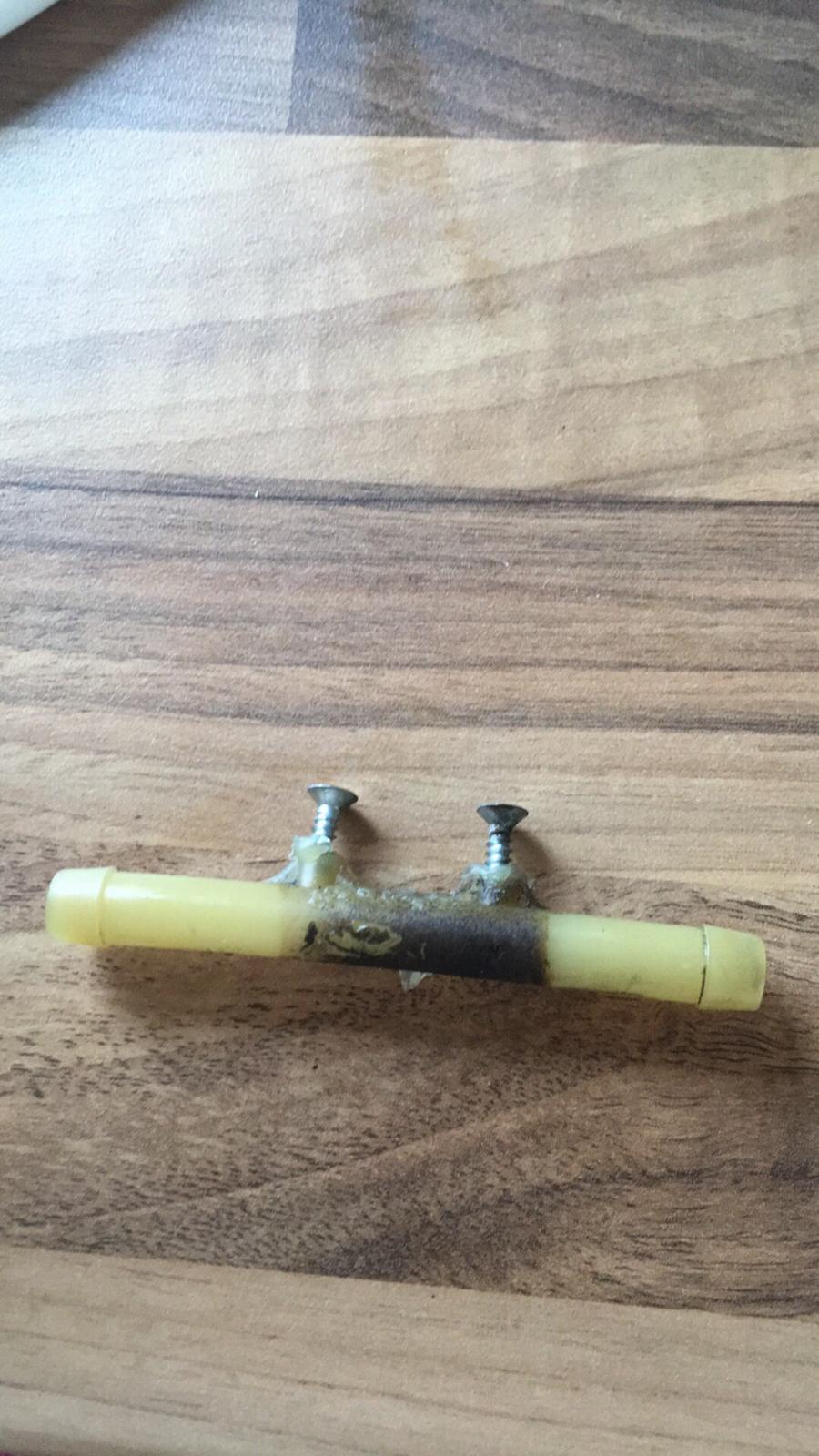

sutty2006 Posted March 8, 2018 Author Share Posted March 8, 2018 Message Joey and ask him, remember he m.o.t tests at Arnie Clarke's in hanley these days, maybe he could ask one of the lads to look it up for him £25 from Arnold Shark. Says its a factory code only. So its going in the bin, and im borrowing his Nova tape deck. lol On a more serious note, I bought said Poxhall with a diesel leak from injector 1 return pipe and blank plug. New pipes and plug supplied. Winnings. I fitted new return pipe from 1 to 2, and a new bung on the blank for number 1. Derv leak then moved to leak off pipe from 2 to 3..... ok.... no drama, replaced that pipe aswell. Now derv is leaking from pipe number 1 again. Think I may have a blockage, but as sods law aways works in my favour, its snowing outside and I cant be arsed to get mildly damp and replace all of the pipes. And its my first day off too. Typical. Link to comment Share on other sites More sharing options...
sutty2006 Posted March 8, 2018 Author Share Posted March 8, 2018 So today I’ve been buggering around with the turd of doom. It’s a great car, honest. Apart from a few minor set backs. The mild fuel leak it came with has turned into a nightmare. It appears to blow off which ever return pipe is weakest. I’ve changed them all now, so those pipes aren’t blocked. Number one return was the main culprit, now it’s number 4. I took the pressure relief valve off the filter to see if it was non operational. It appears to work.... I can only assume one of two things. There’s a trapped/kinked return pipe somewhere causing back pressure in the return line....or.... the little 7mm fuel pipes aren’t strong enough to stay in place with small cable ties. I’ve ordered new jubilee clips but they are taking a while to arrive. On another note, I wanted to diagnose why the horn doesn’t work. Removed the grill to access the horn and found this weird bagged item on the lower radiator crossmember. It had a wire running up to the alarm siren on the bulkhead. It’s now in the bin. Link to comment Share on other sites More sharing options...

Lacquer Peel Posted March 9, 2018 Share Posted March 9, 2018 Are you talking about the leak off pipes between the injectors? They should stay in place without any clips. Talbot 1 Link to comment Share on other sites More sharing options...
Talbot Posted March 9, 2018 Share Posted March 9, 2018 If there's pressure in the leak-off pipes, then there is pressure in the fuel return line. Disconnect it from the pump.. you should be able to blow down it and blow bubbles in the fuel tank. If you can't, there's your problem. The pressure in those leak-offs should be so close to atmospheric that you can't even measure it. Exiled_Tat_Gatherer and Lacquer Peel 2 Link to comment Share on other sites More sharing options...

vaughant Posted March 9, 2018 Share Posted March 9, 2018 Not knowing the set up etc on the Carlton but it seems unlikely that any dirt etc would get in to block it as there should only be filtered fuel heading back in. My guess is a crushed pipe somewhere. Link to comment Share on other sites More sharing options...

sutty2006 Posted March 10, 2018 Author Share Posted March 10, 2018 Well another day and I’m no closer to my issue. The return lines to the tank are clear. I have dropped the pipe from the pump into a jerry can and ran the engine. Fuel returns but is slow, and the return line from the injector pressurises pretty quickly. There is a regulator valve on the filter housing, I’m wondering if the spring is weak causing pressure in the filter housing to return to the injectors. The quest continues. Any more suggestions welcomed as I’m beginning to loose the will to live. Link to comment Share on other sites More sharing options...
sutty2006 Posted March 10, 2018 Author Share Posted March 10, 2018 You little bastard. So the rain homed in and play has stopped today. I’ve had the hand primer/filter housing stripped down this afternoon to no avail. Once rain came I packed up and retreated indoors. Decided to trawl the Internet for pictures of the fuel system on these engines. Took a while to find but I think the mail has been thoroughly whacked on the head. Notice article A, a frontera engine with a return T piece, which locates the leak off pipes. Mine was plumbed directly to the PRV from number 4 injector. My main return pipe has this plastic pipe but looked more like a bodge to me. That will explain a lot. Now I need to find one or make a new one. Article B, is my pipe. Which has been blocked up and was covered in silicone. Lovely Conrad D. Conelrad, Exiled_Tat_Gatherer, scdan4 and 2 others 5 Link to comment Share on other sites More sharing options...
