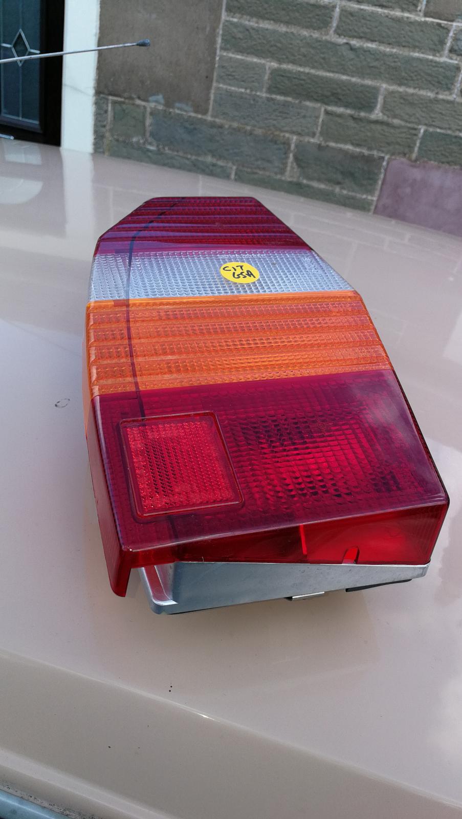

320touring Posted May 1, 2018 Author Share Posted May 1, 2018 I've just remembered that thanks are due to Chaseracer and CMS206 for the procurement and conveyance of the rear light! egg 1 Link to comment Share on other sites More sharing options...
chaseracer Posted May 1, 2018 Share Posted May 1, 2018 You're very welcome, chief. 320touring 1 Link to comment Share on other sites More sharing options...

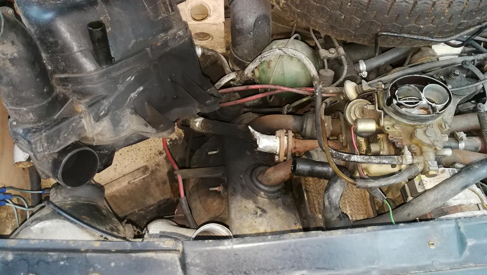

320touring Posted May 4, 2018 Author Share Posted May 4, 2018 I've decided I like this thing sufficiently enough to actually attempt to tend to its issues.. MrCitroen of this here beige has generously offered to come round tomorrow to help me rectify the exhaust blow and try to sort the low idle. I took the opportunity to do some preparatory work so as to best utilise his time (and to start to comprehend just what the little Citroen was made of..) First, Regardez le engine bay.It's a bit of a pickle - pipes, tubes and wires flutter back and forth, seemingly at random. It's certainly a lot more cluttered than the other flat 4 air-cooled engine I have any experience of - the venerable VW. Ah well, let's start at the top. The Airfilter is held on with some jubilee clips and (supposed to be) 2 8mm nuts. The clips and single nut present came off easily, revealing quite the scene. I'd say it's safe to say that at least part of the exhaust blow is caused by the pipe that's no err. This has obviously been an issue for a long time - looking at the condition of things I reckon this was done before import. In preparation for trying to get a new one fitted, I thought it best to try and remove the remnants of the old. This bottom piece had been jerryrigged to buggery with the clamp (14mm nut/bolt)Slathered with sealant. And a bit of wood inside the pipe! That done, it was time for the topside.3 11mm bolts hold the flanges together Whit a mess, and the cardboard 'gasket' was doing not a thing. I stopped to have a bowl out of the air filter - not looking the best so I shall hunt down a replacement:) Next up was the spark plugs. Tentative pulling at the HT leads resulted in them coming off cleanly - though I think they are somewhat past their prime. Access to the left bank was ok, but the right was somewhat more troublesome. A plethora of bracketry and ignition paraphernalia meant that my short extension and plug socket were exactly the wrong length. Nevertheless, persistence paid off, and I have 4 sooty plugs removed. Again, I suspect they were of the last millennium.. Cleon-Fonte, Mrs6C, coalnotdole and 3 others 6 Link to comment Share on other sites More sharing options...
forddeliveryboy Posted May 5, 2018 Share Posted May 5, 2018 Those HT leads are certainly pre c1998, if they're (red) Bougicords. Very likely originals - amazing. The exhaust balance pipe is a thing of the devil to fit especially now OE isn't easily available, likely intended to encourage a French owner who'd hung on to his G a bit long to buy a new one. Make sure both engine mounts are rock-solid before clamping up front exhaust bits. 320touring 1 Link to comment Share on other sites More sharing options...

320touring Posted May 5, 2018 Author Share Posted May 5, 2018 Fast forward to this morning, and it was time to get cracking. We had 3 main goals..1. Change the sparkplugs2. Get it idling correctly3. Sort the missing hotspot pipe. As I said yesterday, the positioning of the sparkplugs was specifically designed to invoke innovation on behalf of the owner. MrCitroen proffered an exceptional solution to the thorny problem of introducing the new sparkplugs to their respective holes. Step forth the 'angle of dangle' mod - a piece of silicone piping that makes seating the sparkplugs a doddle. With them in, we reconnected the HT leads, noting that the original Bougicords looked a bit well worn - I'm considering getting a new set, and have some secondhand known good ones present as a backup just now. Next we moved on to check the wee fuel filter in the carb - a 14mm bolt winds out to reveal a tiny little filter. This looked reasonable, so we cleaned it up and refitted. We gave the carb a dousing in cleaner, and with the car idling, you could hear it start to clear. Eventually we had it idling on all 4 after a fashion, and it was time to move onto the next piece of the puzzle. Even though the BMW e30s have distributors and rotor arms, I've never had to set the ignition timing on one. And the last time I faffed with a dizzy was likely on my parent's VW type 2 (aged about 13). Time for a crash course then. First up, we had a look at the dwell - it should be between 55-59 degrees (approx a 15thou feeler gauge). My car was showing 70 degrees. Time to remove the distributor to adjust the points then. We started by noting the position of the marks on the body. These had been made by a previous owner - we didn't know what they meant but a reference pic is always useful!. Access is bloody tight with inner wing and bulkhead restricting both backwards and sidewards movement. We took the distributor cap off firstly to increase the available space. Again, this is hardly in its first flush of youth, although the contacts looked servicable. Next up was taking the distributor out. There are two 14mm nuts that hold the body into the engine. The top one sits in a slotted hole,to allow for advancing and regarding the ignition timing (much like n alternator tensioner may work). We got the distributor off and were able to identify that we had the glory of cassette points to deal with. The small silver thumbwheel is turned (either with a screwdriver or a 3mm Allen bit) to open/close the points as required. A couple of attempts and checking got us to the magic 15 thou, and we put it back together. Getting the distributor and cap back in place was a fiddly job, so we took it in turns - working until we got grumpy then swapping! With it all back in place, we tried starting it, only to be met with no spark. Mild panic ensued with much multimeter action and a distinct lack of 12v at the coil - odd given that we hadn't touched it! Methodical retracing of steps plus some problem solving showed us the fault lay on the ballast resistor. Eventually, we got the correct combination of connections to have her burst into life! Relieved, I set to replacing the missing hotspot pipe. MrCitroen had most generously donated a spare pipe he had. Firstly, it was trial fitted to check for sealing at the top end - all looked very positive Then it was time to attend to the obvious issues with it.. there were 2 holes in it. In a harking back to the Morris Oxford, it was time to crack out the welder! Holes filled and ground down a touch, it was time to refit it (3x 11mm bolts at the top, 1x14mm nut/bolt on the clamp at the bottom.) We got the engine wholly back together and went out on a test drive. Starting was nice and positive, and the idle was much better. On the open road, it's significantly quieter, and I'm now starting to see where these boxer 4 engines get their 'turbine' reputation from - ramp up the Revs and they get really smooth:) I think there's still some tweaking to be done with timing, as there is the occasional hesitation, but it's a much nicer drive. Overall I'm very pleased! A big thanks to MrCitroen for All his help, knowledge and parts! Have a picture of my GSA and his GS Pallas side by side. Lastly, I took her out for a shakedown run and to get petrol as she has many miles to cover over the next two days.. She looks good in the sun! Tadhg Tiogar, chaseracer, Tickman and 13 others 16 Link to comment Share on other sites More sharing options...

Zelandeth Posted May 5, 2018 Share Posted May 5, 2018 Interesting, the whole balance pipe over the top setup with the exhaust is almost exactly the same as the setup in the Invacar, just that the top half of the pipe on that is part of the inlet manifold. Link to comment Share on other sites More sharing options...
320touring Posted May 5, 2018 Author Share Posted May 5, 2018 Interesting, the whole balance pipe over the top setup with the exhaust is almost exactly the same as the setup in the Invacar, just that the top half of the pipe on that is part of the inlet manifold.It's bizarre to a boy who has only ever played with VW boxers - so much complexity on these engines, but it has a starting handle and a manual choke.. Not to mention a carb. Weird! But fun to work on so far. Link to comment Share on other sites More sharing options...

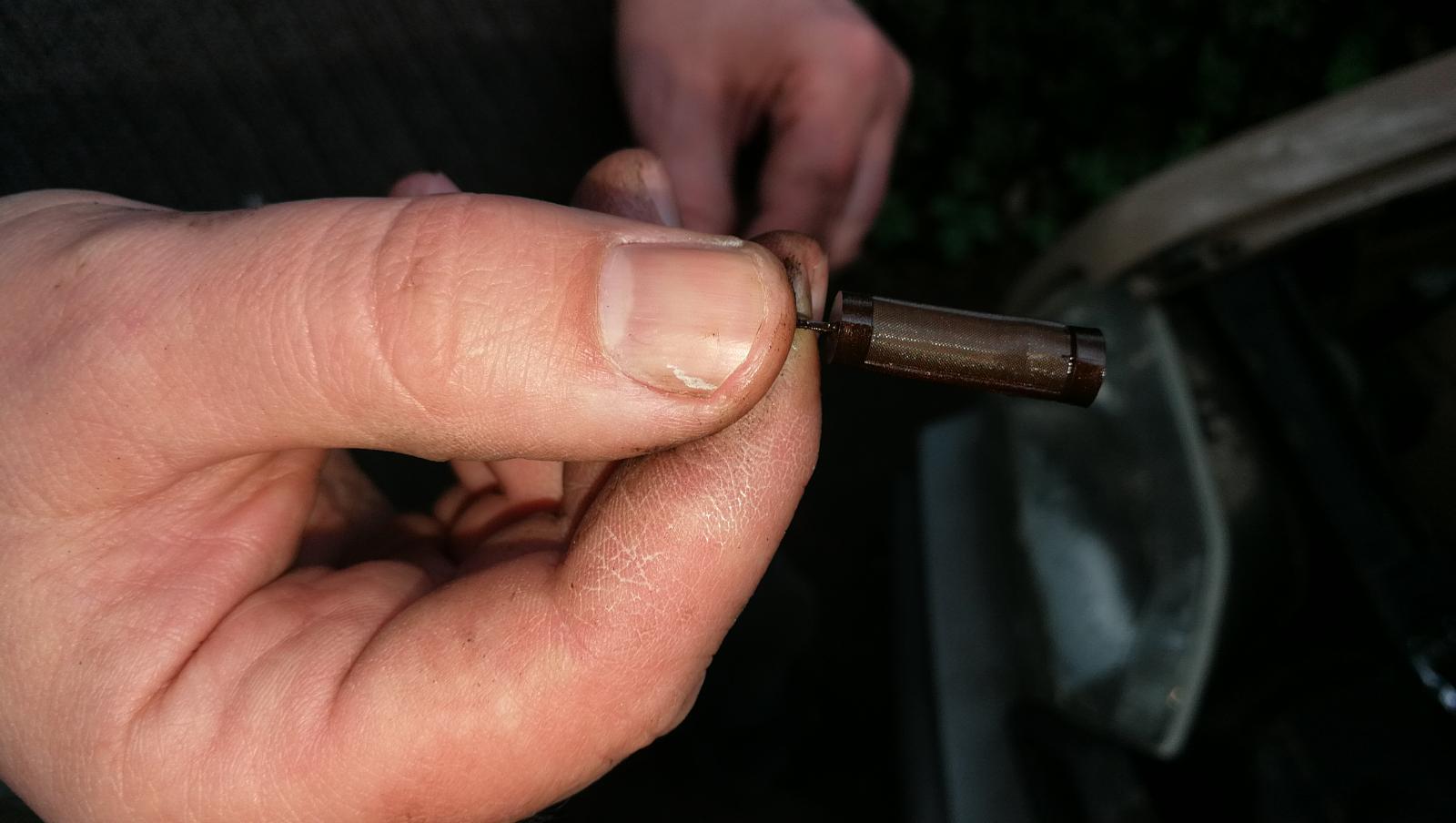

mrcitroen Posted May 6, 2018 Share Posted May 6, 2018 Yesterday was good fun. I enjoyed it. Yes, we gapped the points to the recommended .35mm set the timing to 10 deg btdc using my fancy snap on strobe and fitted new correctly gapped plugs. It did run much better after that. The points had closed up considerably. The SEV Marchal cassette points are a nightmare. To adjust them the dizzy needs to come out, but I showed Neil that you can drill a hole in the dizzy body and insert an Allen key and adjust in situ. A dwell gauge is used if going that route. Incidentally, I have the factory manual and it recommends setting the points by dwell rather than gap. I definatley think the carby needs a service kit thrown at it. I done that on my more complicated Solex and it made the world of a difference. Luckily Neil has the much nicer Webber. All good fun. The car is a wee cracker really. Most importantly it's solid in all the right bits. Cleon-Fonte, Skizzer, cort1977 and 1 other 4 Link to comment Share on other sites More sharing options...
