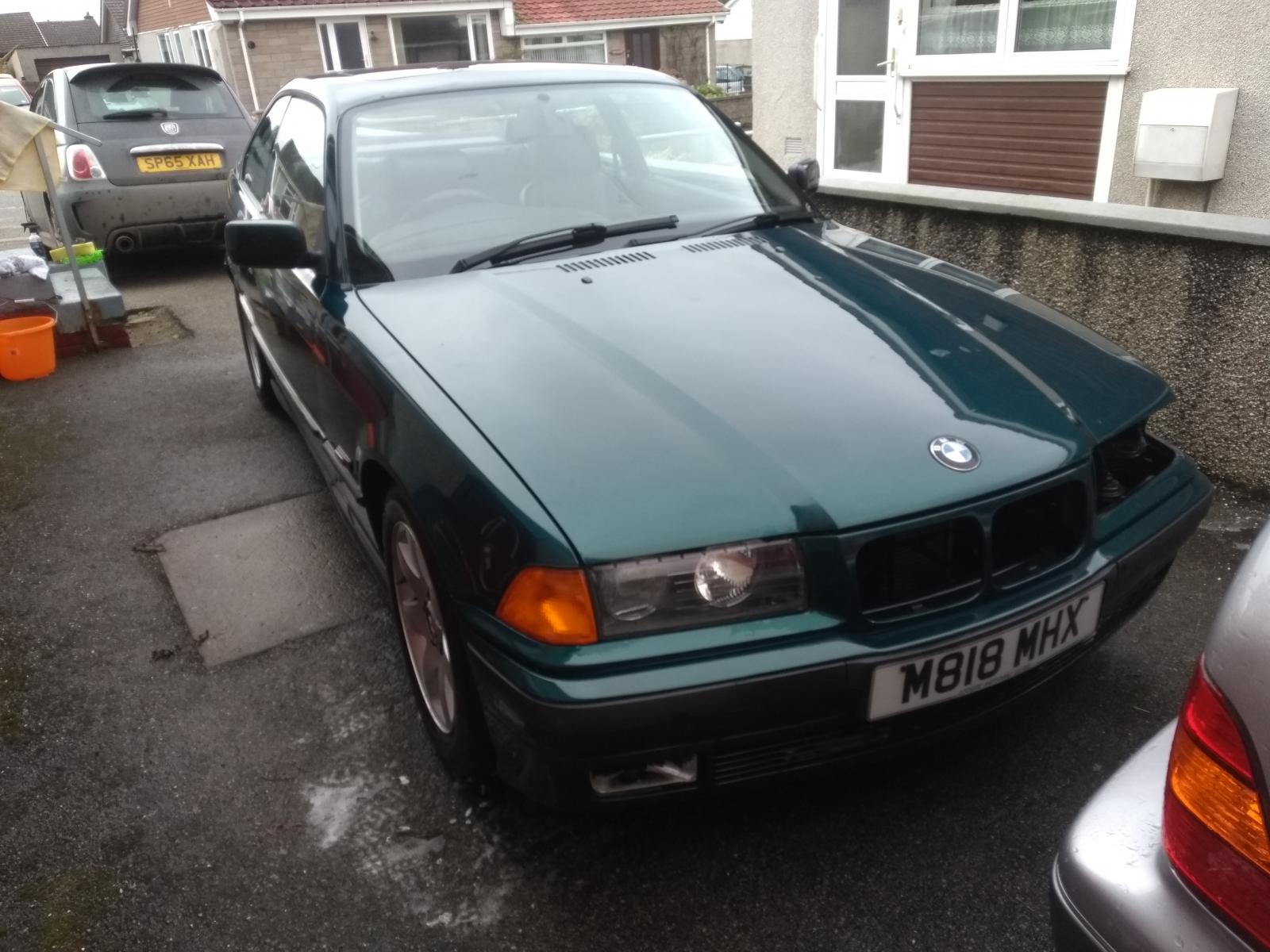

17-Coffees Posted January 28, 2018 Share Posted January 28, 2018 As Supernaut said, made a little bit of progress last night. Surprised at how clean it looks under the bonnet! Spotted a few things that will need seen to in the long run, aux belt, etc but Ifine for now. We also removed the O/S headlight to investigate for a cause of the condensation. A quick look and it seems okay. The glass section has been siliconed in place in the past it seems, that or BMW duble secure the glass with silicon and the small clips? Got the lamp unit sitting on top of my kitchen radiator to dry out anyway. That was it’s state as if 6pm last night, abandoned plans for more as was time for the pub. 320touring and Tickman 2 Link to comment Share on other sites More sharing options...

The Reverend Bluejeans Posted January 28, 2018 Share Posted January 28, 2018 Course the headlights are different, as wings and bonnet are too! Not so. Headlights are the same on all E36's except the Compact - these fit but have E39 style bulbs and bulb connectors. Some have lines across, some have 'bobbles' along the edge depending on when it was made. Changed around 1994 iirc with all cars getting the 'bobbled' lights by 1996. Compact lenses don't fit saloon/Coupe/Convertible/Touring light units, different number of clips. With E36 bonnet catches, don't fart about but go to BMW and buy two new ones and a centre cable. It will all be fucked by now. The centre cable sticks with rust and the ferrules on the catches will be broken off. You may be able to save it all but after 23 years? The catches are about 18 quid each with VAT, the cable £20. I replaced it all on my Touring, cost about £43 all in and the bonnet opens and closes like a gem. With the bonnet open you can remove that upper trim panel, undo the three torx screws per catch and a ) Spend ages removing the complete front panel b ) Just bend the front panel tabs up and slide the old catches out. I recommend this on an old shitter. 320touring, The Moog and Supernaut 3 Link to comment Share on other sites More sharing options...
320touring Posted January 28, 2018 Share Posted January 28, 2018 You learn summat(lights!) Every day. Are the indicators different ? The Reverend Bluejeans 1 Link to comment Share on other sites More sharing options...
The Reverend Bluejeans Posted January 28, 2018 Share Posted January 28, 2018 Are the indicators different ? Yes. Front grille panel is the same on all cars, just different from 1996 facelift. 320touring 1 Link to comment Share on other sites More sharing options...

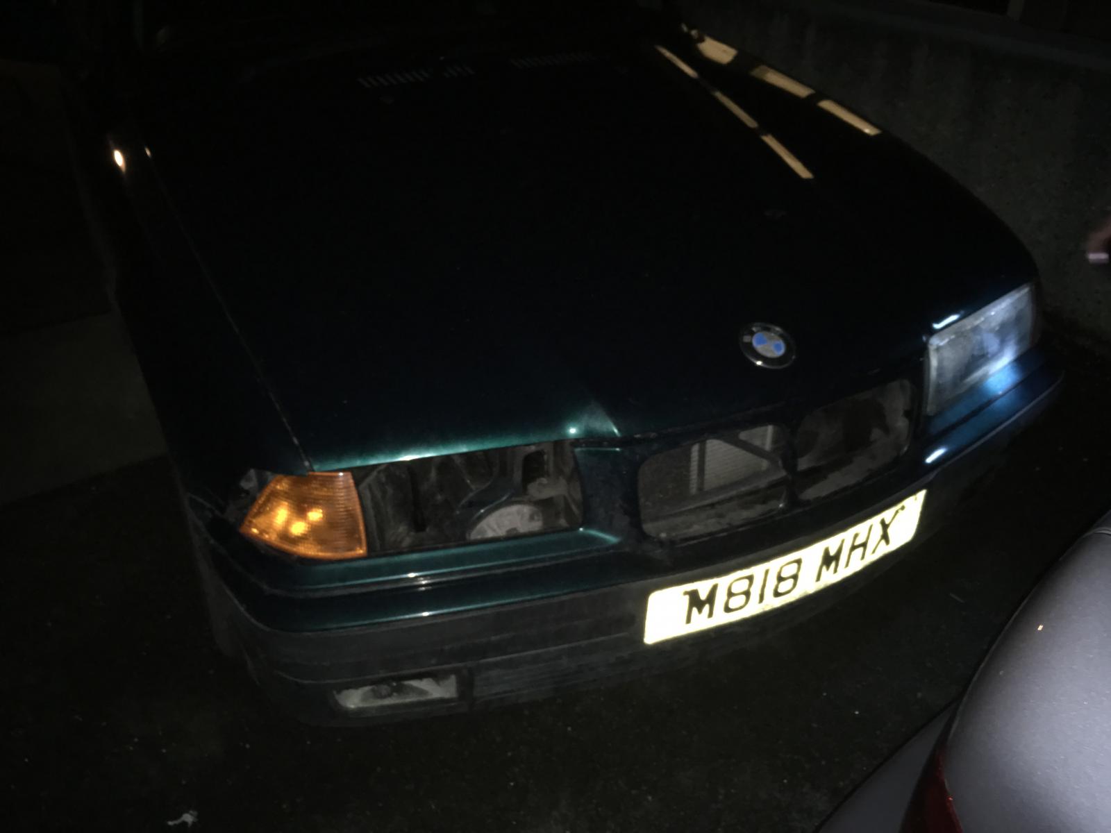

Supernaut Posted January 28, 2018 Author Share Posted January 28, 2018 Progress! As mentioned, we took out the O/S headlight and put it on a radiator overnight. After that, we took the N/S light out for the radiator treatment and set to looking at the passenger side screenwash nozzle. It seemed to be leaking from under it. We sort of fixed it, but it's still pretty piss poor. Might just swap the one off the white 316 onto it when presenting it for an MOT. Then we washed it. The grille panels are in the boot. It makes it easier to open the bonnet that way. We can just reach in with some pliers and activate the bonnet catches this way. I then decided to fit a radio that was last used in a Peugeot 306 I owned in 2010. It still works! Cassette deck hidden behind the flip-down panel! Ooooh yeah! Shoved a cassette adapter in there and blasted some Eurobeat from 17-Coffee's phone. check out the beading! It goes alright, actually. Earlier today I pulled out of a junction to join the Ellon bypass rather enthusiastically and there was some gravel on the road. This resulted in some nice sideways action. The headlights have already misted back up again though. Boo! Still need to investigate the brake judder and the electrics in the driver's door. Did you find any more cutlery under the bonnet? Alas, no. DeeJay, Lacquer Peel, Sudsprint and 4 others 7 Link to comment Share on other sites More sharing options...
