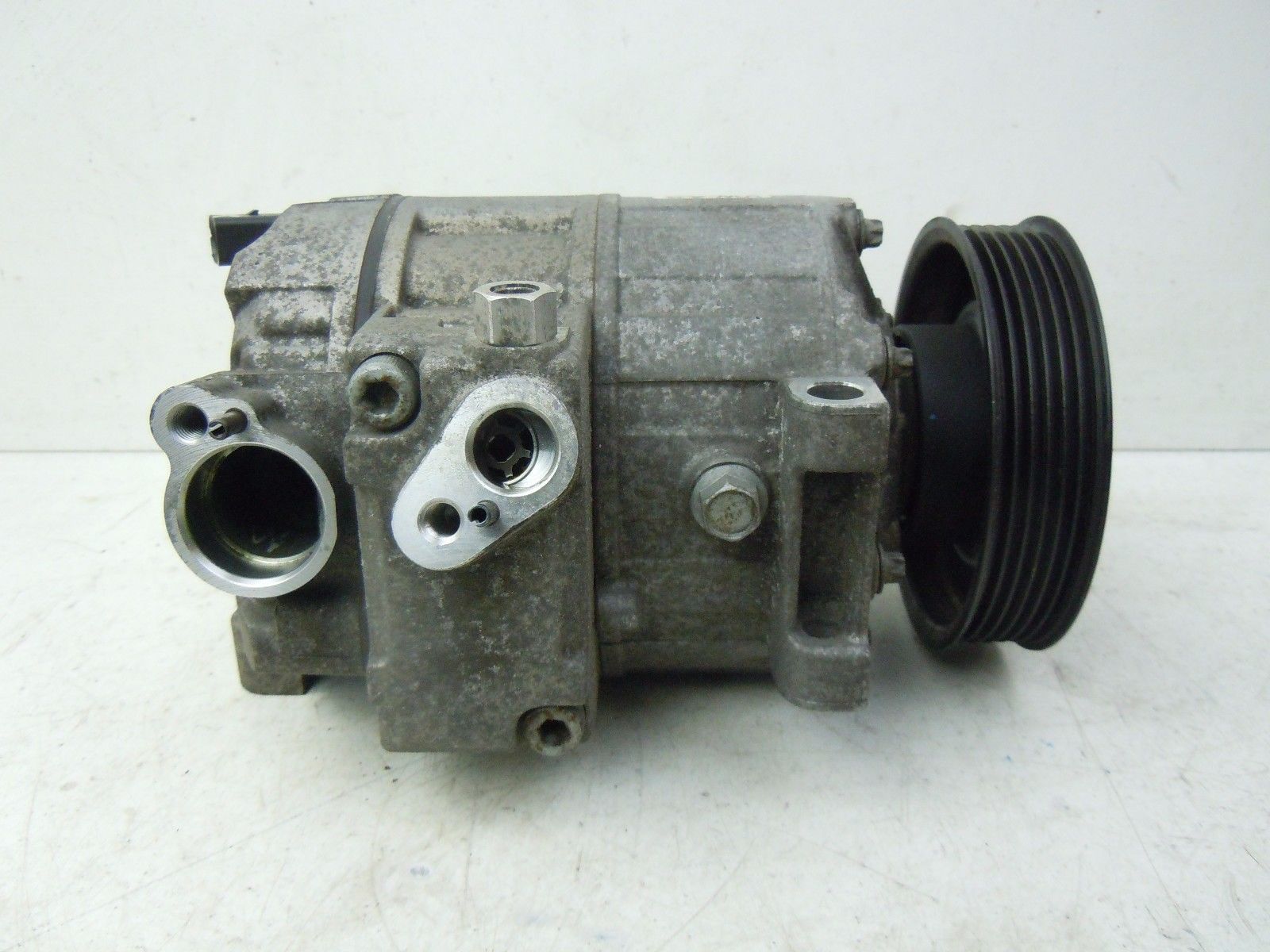

SiC Posted October 12, 2017 Share Posted October 12, 2017 It does not. The clutch merely switches it on or off. All A/C compressors have it, regardless what the internals of the compressor are like. Ok, sorry you are right. I miss read the Saab Workshop manual - which describes this engine as its shared with Saabs. Incidentally the Saab workshop manual has detailed description sections which are really excellent in describing how modern automotive systems work - not just in a basic level but also detailed technical level. Anyway the petrol engine on the Saab (which is not used on the Alfas). Anyway on the Saab engined vehicles, the compressor doesn't kick in or out with the a/c clutch. When A/C is demanded, it stays permanently on, rather than cycling the clutch to maintain pressure. I read these "clutch-less" compressors as no clutch. Where as they don't use a clutch to control themselves but still have one to physically enable or disable the system. EDIT: Scratch that, clutch-less variable deplacement compressors do exist. Used on Lexus, VAG and others - made by Denso, Valeo, Sanken, et al. Link to comment Share on other sites More sharing options...
SiC Posted October 12, 2017 Share Posted October 12, 2017 Ok, sorry you are right. I miss read the Saab Workshop manual - which describes this engine as its shared with Saabs. Incidentally the Saab workshop manual has detailed description sections which are really excellent in describing how modern automotive systems work - not just in a basic level but also detailed technical level. Anyway the petrol engine on the Saab (which is not used on the Alfas). Anyway on the Saab engined vehicles, the compressor doesn't kick in or out with the a/c clutch. When A/C is demanded, it stays permanently on, rather than cycling the clutch to maintain pressure. I read these "clutch-less" compressors as no clutch. Where as they don't use a clutch to control themselves but still have one to physically enable or disable the system. EDIT: Scratch that, clutch-less variable deplacement compressors do exist. Used on Lexus, VAG and others - made by Denso, Valeo, Sanken, et al. Notice the lack of clutch: http://www.ebay.co.uk/itm/2006-SEAT-ALTEA-1-6-PETROL-A-C-AIR-CON-COMPRESSOR-PUMP-1K0820803N-/122739287202 Link to comment Share on other sites More sharing options...
