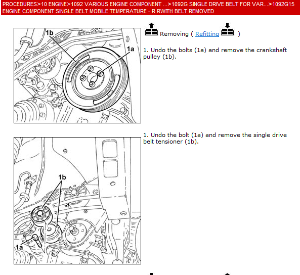

Dave_Q Posted October 9, 2017 Share Posted October 9, 2017 Assuming it's a 1.9JTD? Tensioner isn't bad, jack up, wheel off, remove some plastic, the tensioner on a 1.9 is only held on with one bolt but you will have to take the bottom pulley off (ribe bit, M8 maybe?) to get the tensioner out. I've got the 156 elearn if you want any pictures of the procedure. Link to comment Share on other sites More sharing options...

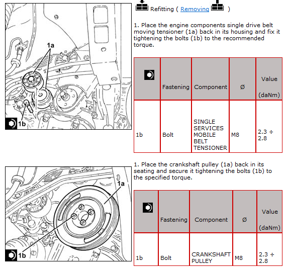

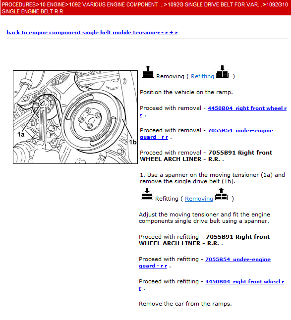

Dave_Q Posted October 9, 2017 Share Posted October 9, 2017 Here you go. There's really not a lot to it. I've spared you the bits for removing the wheel and the plastic access panel, it's a 17mm socket for the wheel bolt and phillips screws with optional "rip the fucker off because the screws have rounded off" for the access panel. The thing says to remove the undertray but I don't think you'll need to, if so it's a Torx (T30?) for some and a smallish (10mm?) socket for the rearmost ones. If you're a torque wrench user note that they give the torque values as DecaNewtonmetres, ie 2.3-2.8 daNm is 23-28 actual Nm. Only other thing to note is that the bottom pulley on my 156 took more hammering than they recommend to get it off. Lacquer Peel 1 Link to comment Share on other sites More sharing options...
