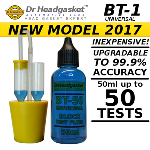

dave21478 Posted September 30, 2017 Share Posted September 30, 2017 Every shiter should have one of these..... Under a tenner and they work really well. http://www.ebay.co.uk/itm/BT-1-COMBUSTION-LEAK-TESTER-KIT-CO2-PETROL-HEAD-GASKET-TEST-FLUID-BLOCK-15D-/272706523301?epid=527962631&hash=item3f7e9350a5:g:vA8AAOSw4DJYi63f Lacquer Peel and Dead_E23 2 Link to comment Share on other sites More sharing options...
phil_lihp Posted September 30, 2017 Share Posted September 30, 2017 Looks like a great idea although it says it's not suitable for cars with expansion tanks which seems a little odd. Tempted to get one though. Link to comment Share on other sites More sharing options...
Sir Snipes Posted September 30, 2017 Share Posted September 30, 2017 Also says the presence of Antifreeze can skew the result? Link to comment Share on other sites More sharing options...
