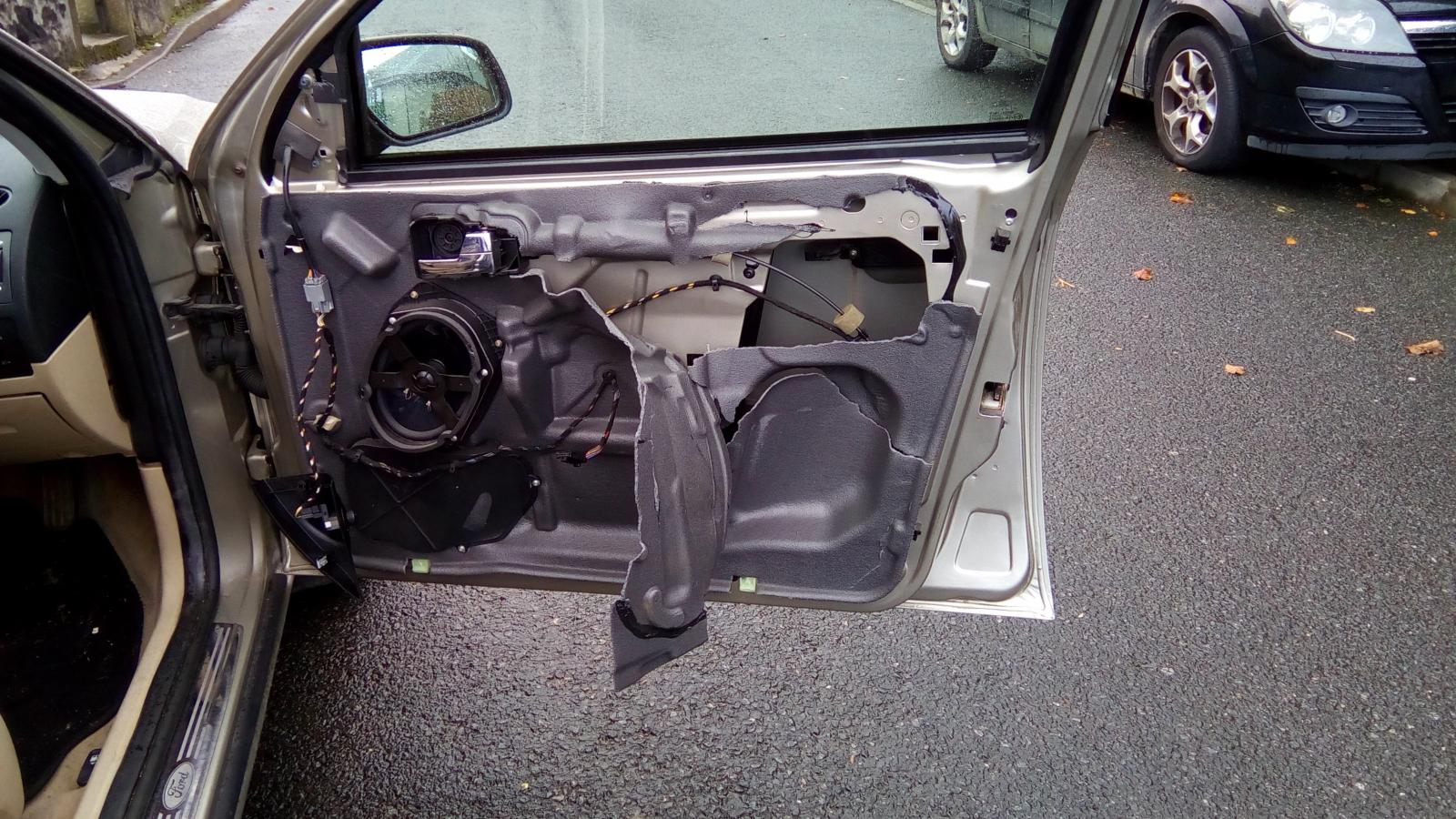

Supernaut Posted October 22, 2017 Author Share Posted October 22, 2017 Hmm. Opened the driver's window earlier, when I tried to close it, it only went so far then made some crunchy noises. Wouldn't go back either. I managed to open up the door and put the window back, but now the motor only runs a short distance in each direction then meets resistance and stops. The metal cables attached to the windows seem loose too. There are two vertical rails, one at the front of the door, one at the back. Initially the cable in the rear one was loose, but after faffing with the motor a bit, the rear one is tight and now the front one is loose. No movement from the window itself though. Help! Link to comment Share on other sites More sharing options...
Guest Hooli Posted October 22, 2017 Share Posted October 22, 2017 It's fucked mate... Without taking the whole lot out I can't offer any advice as I don't know these cars. Probably easier to replace the whole mech than try to fix it though. Link to comment Share on other sites More sharing options...
Supernaut Posted October 22, 2017 Author Share Posted October 22, 2017 Aye, I found this thread: http://www.talkford.com/community/topic/156818-how-to-fix-front-electric-window/ and this part: http://www.ebay.co.uk/itm/FOR-FORD-MONDEO-MK-III-MK3-FRONT-RIGHT-SIDE-WINDOW-REGULATOR-/221584755370?hash=item33977b0aaa:g:MucAAOSwQJ5USi4U Guess what I'll be doing next weekend. Just put a full tank in the fucker, too. Meh, it's still driveable, just can't open/close the driver's window. It's not the worst problem to have. Link to comment Share on other sites More sharing options...

Supernaut Posted October 22, 2017 Author Share Posted October 22, 2017 Well, the car is secured and weathertight for now, so my tactic is to not touch it until I'm ready to fix it. Lucky that I walk to work! My plan is to drive it out to the parents' farm next weekend and spend the day working on it in a barn. Hopefully it won't take all day (thread on TalkFord says a couple of hours) but I just hate working on cars outside in shitty weather. From what I've seen inside the door and heard from the noises it's making, it seems like the cables have snapped. According to the TalkFord thread it's a fairly common thing on Mk3 Mondeos. Link to comment Share on other sites More sharing options...
Guest Hooli Posted October 22, 2017 Share Posted October 22, 2017 Fairly typical on any cable operated door tbh. I rebuilt the mech in my goona2, hence saying it's much easier to replace the lot. Link to comment Share on other sites More sharing options...
Supernaut Posted October 22, 2017 Author Share Posted October 22, 2017 Fairly typical on any cable operated door tbh. I rebuilt the mech in my goona2, hence saying it's much easier to replace the lot. Aye, seemed to be the consensus on TalkFord too. You can get a 'rebuild kit' for under £10, which is just the cables and some little plastic wheels, but a few folk said to just fork out for the whole regulator, as swapping out the whole unit is much easier and quicker. Link to comment Share on other sites More sharing options...
Guest Hooli Posted October 22, 2017 Share Posted October 22, 2017 It took me about 30mins to reassemble the mech in the goona, on the 2nd or 3rd go... I'd stripped it down to remove the motor so I could get the window shut. Link to comment Share on other sites More sharing options...
MikeR Posted October 22, 2017 Share Posted October 22, 2017 having recently looked at the same setup in my Focus cos the window had stuck , turned out the motor , cables , wheels , guides needed some lube and exercise , I did consider going the whole new mech for the winder as opposed to a repair kit !!! as you can see the red rust of doom was avin a go !! Link to comment Share on other sites More sharing options...

Supernaut Posted October 23, 2017 Author Share Posted October 23, 2017 having recently looked at the same setup in my Focus cos the window had stuck , turned out the motor , cables , wheels , guides needed some lube and exercise , I did consider going the whole new mech for the winder as opposed to a repair kit !!! as you can see the red rust of doom was avin a go !! 20171015_163153.jpg My one is well beyond just needing lube, going by the sounds it made and the sheer amount of loose cable there was floating around inside the door! Nice old Barge though... It is indeed. I've never been a big fan of Fords before this. In fact it's my first Ford. It feels very sturdy and is a very pleasant place to be. It does *ahem* mph in silence too. Lacquer Peel 1 Link to comment Share on other sites More sharing options...
cort1977 Posted October 23, 2017 Share Posted October 23, 2017 I've used the kits on Mercedes windows, it's doable but if you can get a new complete regulator for a reasonable price it will hopefully make the job less than an hour rather than a three hour fuckabout. Link to comment Share on other sites More sharing options...
Supernaut Posted October 23, 2017 Author Share Posted October 23, 2017 Complete regulator was ordered yesterday for £25. cort1977 1 Link to comment Share on other sites More sharing options...
Supernaut Posted October 28, 2017 Author Share Posted October 28, 2017 Window regulator fitted. Easy enough to do. Spent a while afterwards faffing with it because it seemed to be struggling to close. Turns out it works far better with that little bit more voltage available when the engine is running... I also fitted my osram silver stars. I got H7s, which fit the dipped beams, the full beams use H1s, durr.The headlights come out really easily though, just pull out two little metal bars and the whole unit slides out the front. Lacquer Peel 1 Link to comment Share on other sites More sharing options...
