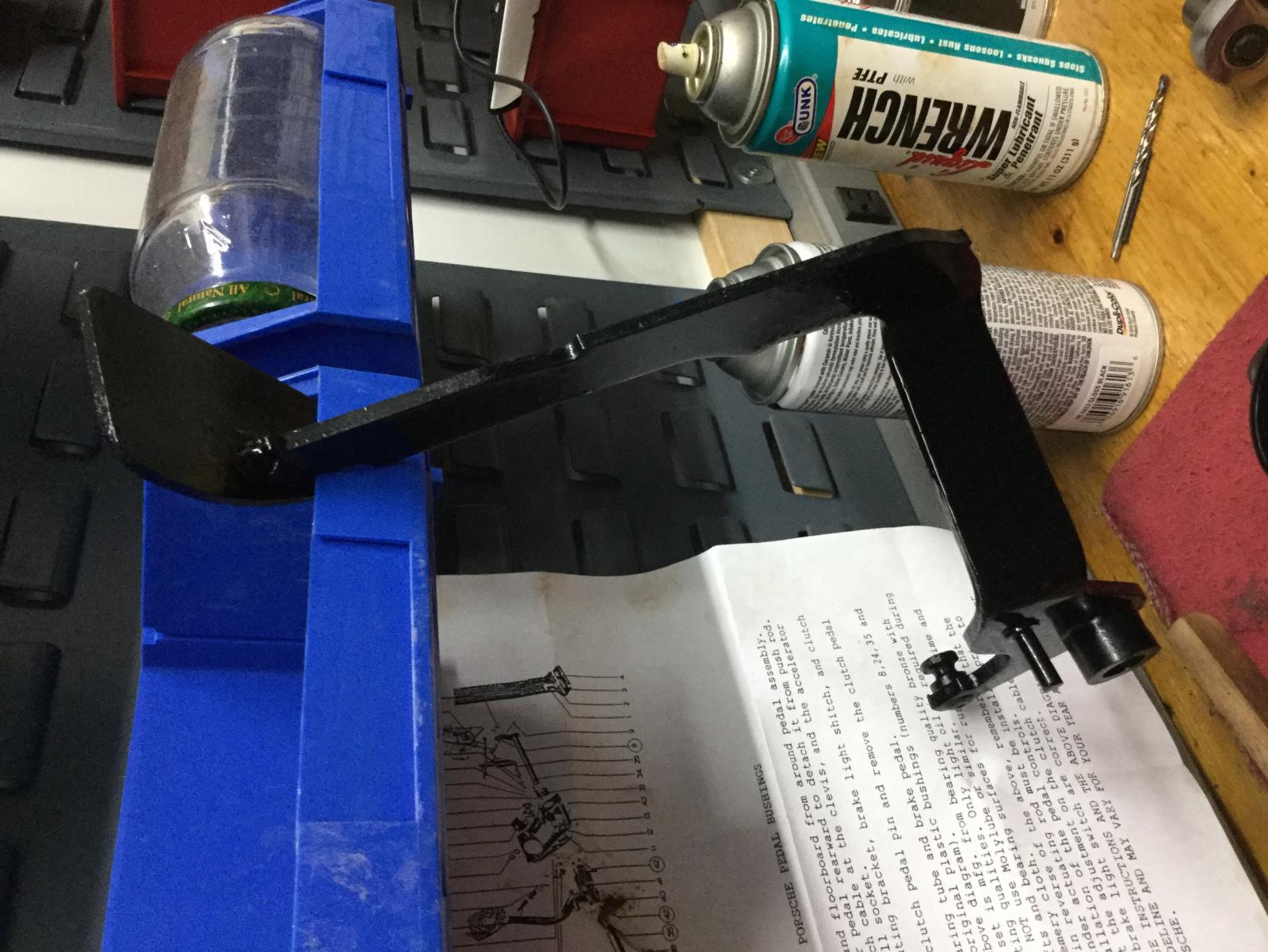

Roobarb Posted April 16, 2018 Author Share Posted April 16, 2018 Still cleaning up the foot pedals. Next I need to buy a Zinc plating kit, before final reassembly. In the meantime, I've started to work on another little problem... the key that came with the car doesn't fit a single lock. Typical estate sale nightmare sooooo I've started to remove the ignition switch to see if I'm lucky and it has the paper with the key code on it. If not, to send it away to have a key match.The steering wheel was in the way, so that came off. Removing the breakoff bolts and setting about the pinch bolt at the steering column, I took off the lower column cover and the drivers side kneepad. Seems to go on and on. Link to comment Share on other sites More sharing options...

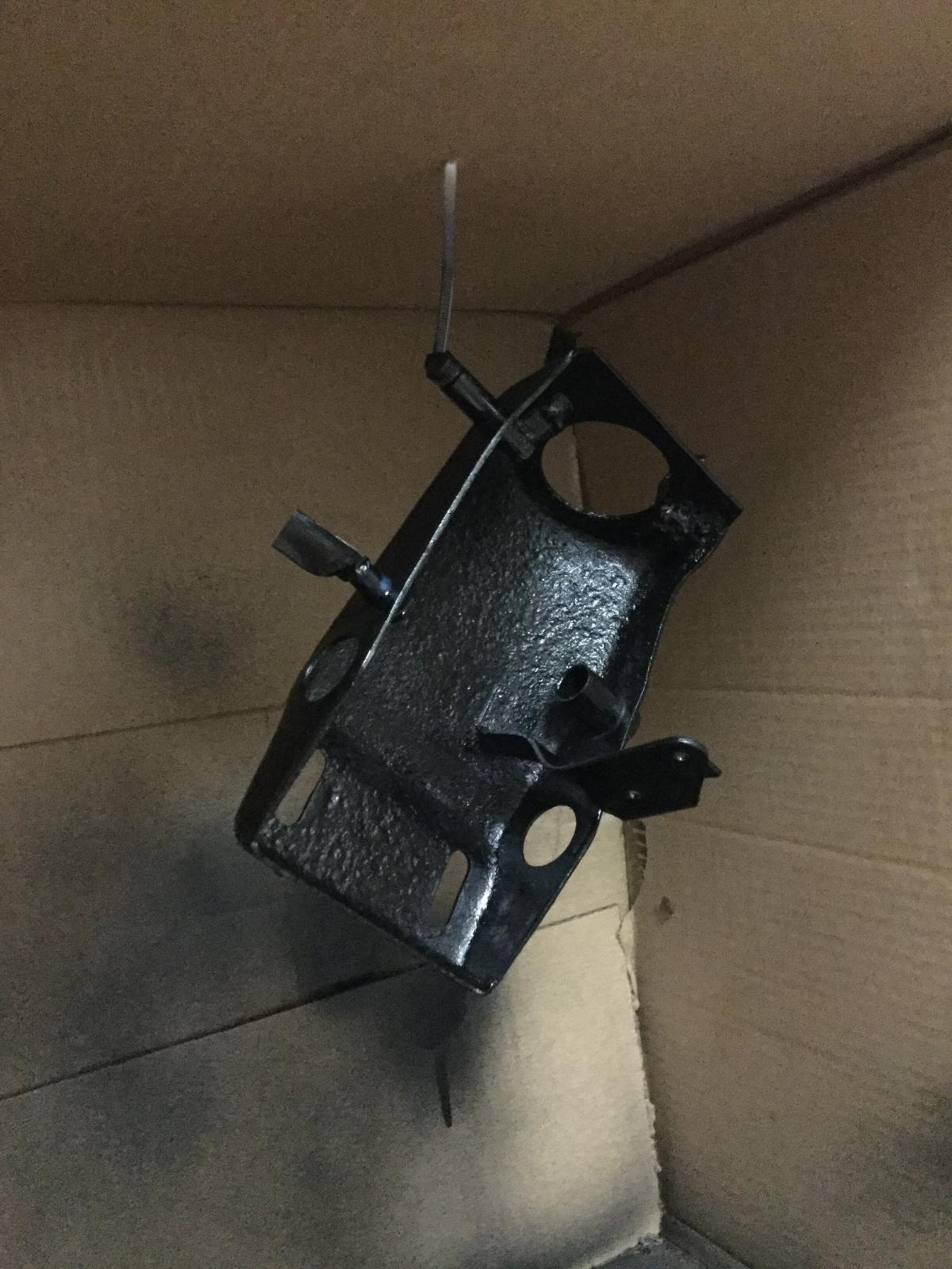

PhilA Posted April 17, 2018 Share Posted April 17, 2018 The foot pedal assembly was pretty badly corroded, so I tried something new (to me). This degreasing stuff:IMG_6387.JPGFollowed by this derusting stuff:IMG_6388.JPGWow - did that ever do the job!Sometimes I don't talk out of my ass. Phil Roobarb 1 Link to comment Share on other sites More sharing options...
Roobarb Posted April 20, 2018 Author Share Posted April 20, 2018 Very true It works like a charm. Thank You! Link to comment Share on other sites More sharing options...

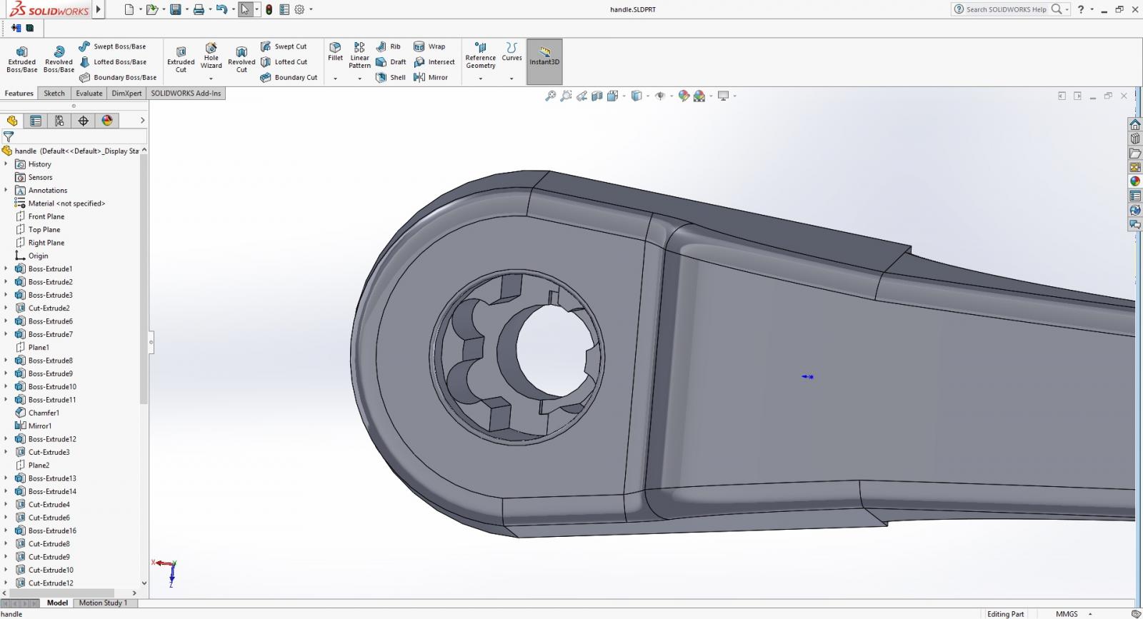

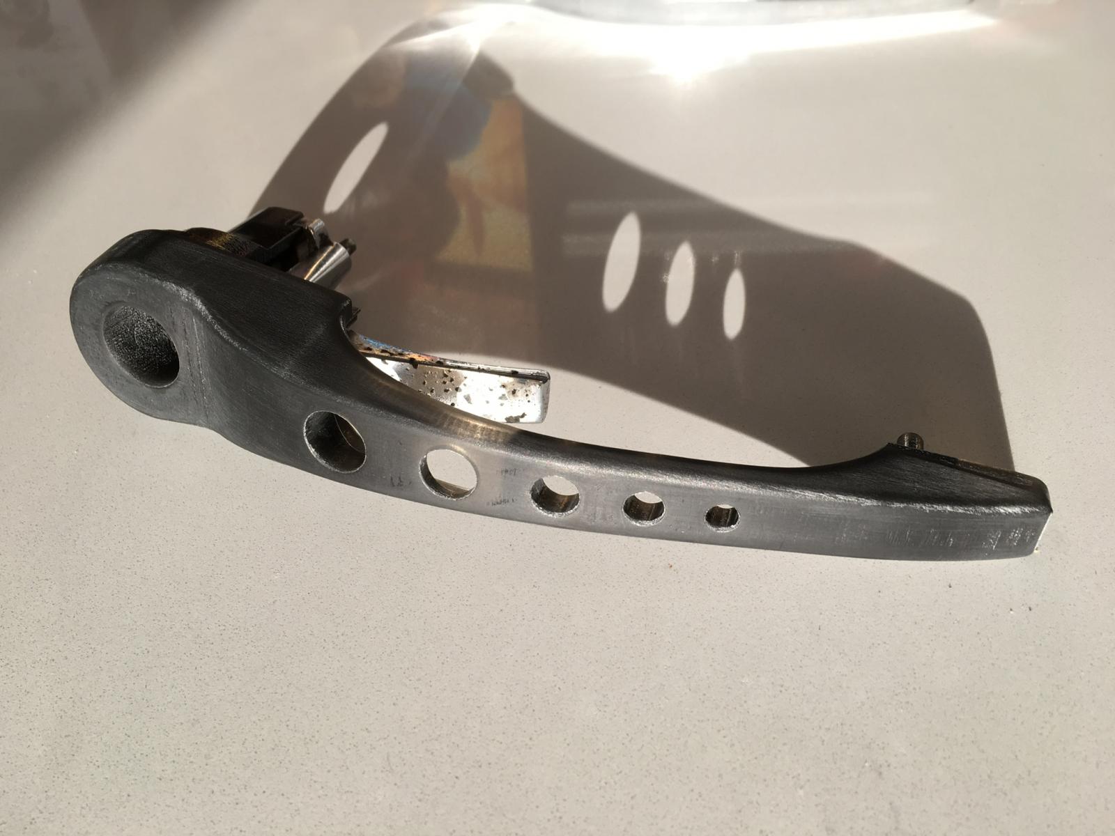

Roobarb Posted April 21, 2018 Author Share Posted April 21, 2018 SQUIRREL!!! It's normal for it to snow in Minnesota in the winter, but last weekend was a doozy.22" in two days.This is just from Saturday. So, not wanting to be in the garage for too long, I disassembled something I didn't need to (the door handle) and started drawing it in CAD. Back in the day, Porsche had this type of door handle on its RSRs for racing, but made in plastic. There was tale that there is an OEM part number for this, but they were never made available to the public. A few people have talked about grouping up to have an injection mold made, I had the idea of drawing one and then printing it. Should save at least 50lbs in weight (not!). The outside was reasonably easy to measure and draw - though I need to test print to make sure it's mostly right dimensionally, but the inside key barrel place is quite complicated, so... I cast it and then measured it. Added and a few surfaces cleaned... And a last optional addition for that extra 'Magnus W&$@ker' element (great to see a Brit abroad doing so well, but outlaw is a bit played out) that I can turn on and off as wanted. Sent it off for a test print to see how far off my measuring was.I seem to have added too much thickness to the handle. Oh well, that's why you test print I guess!Perspective in the photos makes the plastic handle look smaller. The handle parts seem to fit. And there is a HUGE weight saving... (bahahahaha!)That's a whole pound for two (possibly even more once I correct the handle thickness...)Can't wait for the snow to go so I can really get back to grips with the car. Asimo, mjrose78, vulgalour and 1 other 4 Link to comment Share on other sites More sharing options...

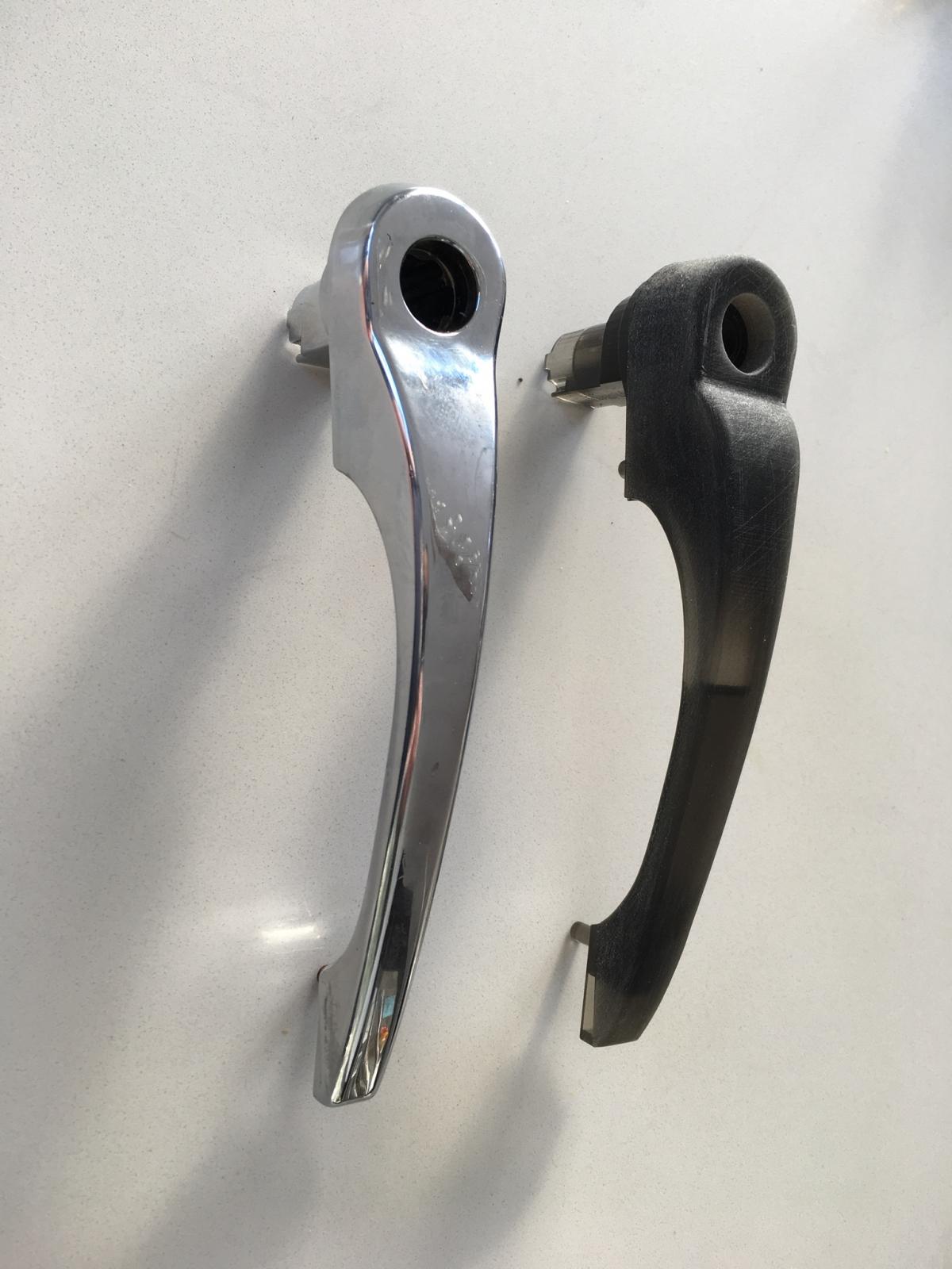

Roobarb Posted April 28, 2018 Author Share Posted April 28, 2018 And then there were three I still need to make sure the key barrel fits and buy some melt in nutcerts. Getting close now though. The handle 'head' is a little thick still. With another 2mm off that, I think I'll be happy. Don't think I'm going to print it with the holes though, as they seem to make it a little too bendy for the final product. mercedade and mat_the_cat 2 Link to comment Share on other sites More sharing options...
