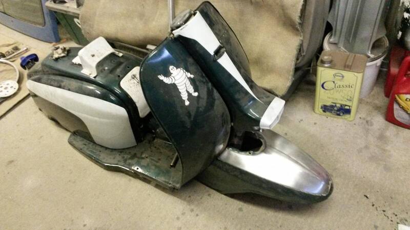

4wheeledstool Posted October 22, 2017 Author Share Posted October 22, 2017 It's amazing how little is left when you strip all the bits off one of these. Does the tubular frame provide all the structural rigidity on a scooter like this? It looks like it would bend in the middle if you picked it up too roughly!The frame tube does indeed provide all the structural rigidity - the wall thickness is about 3mm. It certainly takes a fair old collision to bend it! Link to comment Share on other sites More sharing options...

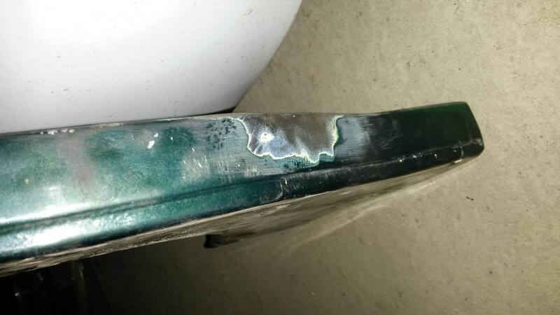

4wheeledstool Posted June 4, 2018 Author Share Posted June 4, 2018 Finally got my arse in gear and made a start on the body work today. I didn't get long on it (15 minutes!) as I had to go back in to work unexpectedly, but it was long enough to cop for a rogue wire off the wheel straight in the cobblers. Cavcraft, UltraWomble and Jim Bell 3 Link to comment Share on other sites More sharing options...

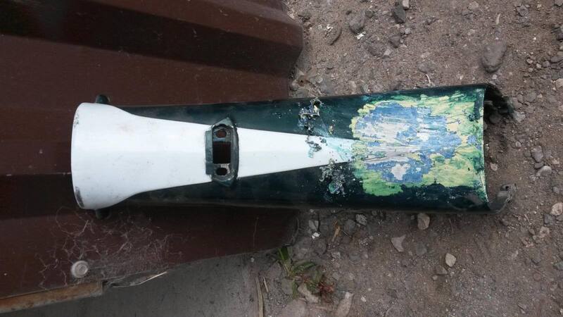

4wheeledstool Posted June 15, 2018 Author Share Posted June 15, 2018 Like a complete gonad, I deleted the "before" pictures instead of uploading them. The rear floorboards required a little welding - there was a split in the nearside one about half an inch long. Not now! I had made a semicircular cut out in the back of the offside one to facilitate the fitting of the Micron pipe many years ago. Fortunately I had kept hold of the piece, and was able to stick it back in! Need to get all the steel bits blasted now - may be a while due to an imminent week away. Cavcraft and Dick Longbridge 2 Link to comment Share on other sites More sharing options...

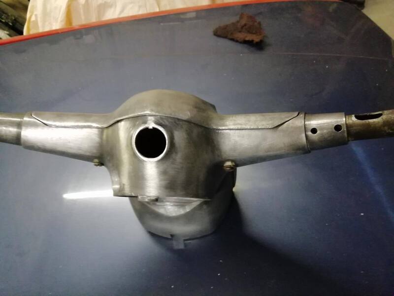

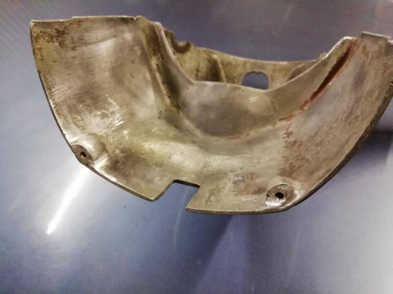

4wheeledstool Posted January 11, 2019 Author Share Posted January 11, 2019 I'd left the handlebar top and bottom with a mate so he could stick some aluminium weld on the goosed headlight rim threads back in June. I only got them back a few weeks ago, and have only just got round to drilling and tapping some new threads into the welded up lugs this afternoon. With that done, I can now get a load of parts off to a painter - there's a fair chance that this thing is gonna get done this year! (Hopefully before Summer ) yellowperil, Cavcraft, mk2_craig and 3 others 6 Link to comment Share on other sites More sharing options...

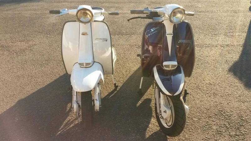

Dick Longbridge Posted January 11, 2019 Share Posted January 11, 2019 Result!Only just seen your post with the SX and TV photo. Are they also yours? Prior to buying my SX150 a decade ago, I owned (amongst other classic scooters over the years) a 1970 GP 150, which was in fantastic condition. When I was looking to buy it, I also looked at Specials and a TV 175 in Weymouth - all similar prices at the time. Since that, though, I'd say the value of the TV 175 has rocketed the most. Conversely, SX200 values seem to have levelled out a bit. Cavcraft 1 Link to comment Share on other sites More sharing options...
4wheeledstool Posted January 12, 2019 Author Share Posted January 12, 2019 The SX + TV are the same ones featured earlier in the thread - definitely still owned by myself. The last time I saw a TV200 for sale, the asking price consisted of five digits! TV175s don't seem to be all that far behind, its getting more ridiculous year on year! Dick Longbridge 1 Link to comment Share on other sites More sharing options...
Cavcraft Posted January 12, 2019 Share Posted January 12, 2019 The SX + TV are the same ones featured earlier in the thread - definitely still owned by myself. The last time I saw a TV200 for sale, the asking price consisted of five digits! TV175s don't seem to be all that far behind, its getting more ridiculous year on year! The 'common or garden' models seem to have taken a small nose dive fairly recently. They do drop in winter anyhow, but for the last few months there's been quite a few decent looking Italian Li models at a fair price. A lady at work bought a belting looking 125 with a 186 (Mugello?) kit on it for a great price. Suppose none are especially reliable (in general terms) but a mate has an Indian GP that's been horrifically bad, never seems to run right and always packing up. Dick Longbridge 1 Link to comment Share on other sites More sharing options...
Dick Longbridge Posted January 12, 2019 Share Posted January 12, 2019 The SX + TV are the same ones featured earlier in the thread - definitely still owned by myself. The last time I saw a TV200 for sale, the asking price consisted of five digits! TV175s don't seem to be all that far behind, its getting more ridiculous year on year!Damn memory - forgot what you'd previously posted! You've certainly got a half-decent pension plan sat in the form of your SX and TV 200s, if you ever needed to release the funds. It'd be a shame to sell them on after all this time though.I keep on eyeing up Spanish S2s at the moment. I've always liked the lines of the S2, although the turning mudguarf of the Spanish model trumps it for me. Not sure their values will ever shoot up like their Italian counterparts though. Link to comment Share on other sites More sharing options...
Dick Longbridge Posted January 12, 2019 Share Posted January 12, 2019 The 'common or garden' models seem to have taken a small nose dive fairly recently. They do drop in winter anyhow, but for the last few months there's been quite a few decent looking Italian Li models at a fair price. A lady at work bought a belting looking 125 with a 186 (Mugello?) kit on it for a great price. Suppose none are especially reliable (in general terms) but a mate has an Indian GP that's been horrifically bad, never seems to run right and always packing up.The 186 is likely to be the Imola kit, which is what's fitted to my SX. When I actually rode the damn thing, it was ultra reliable. I also think electronic ignition is a must-have for anyone wishing to travel more than 500 yards on a Lambretta. Cavcraft 1 Link to comment Share on other sites More sharing options...
4wheeledstool Posted January 13, 2019 Author Share Posted January 13, 2019 Repaired headlight rim threads Stripped all the paint off to check for cracks, then checked that it still fitted together nicely The white paint was an absolute knacker to remove - who'd have thought that Halfords bodge tins would be so durable! strangeangel, Cavcraft, Dick Longbridge and 1 other 4 Link to comment Share on other sites More sharing options...

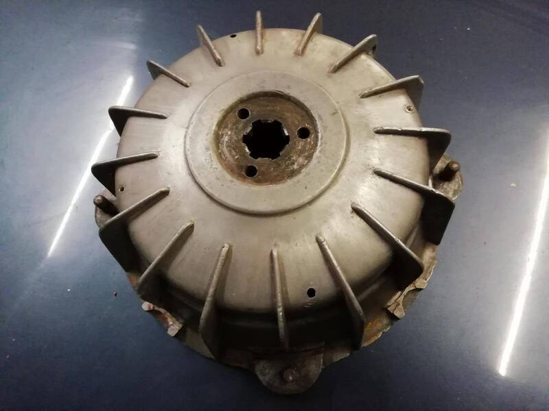

4wheeledstool Posted January 24, 2019 Author Share Posted January 24, 2019 Due to the tedium of scraping paint off aluminium hubs, I decided to try a different way with the rear one. I went out and bought a gallon of thinners, then plonked the hub in it to soak for a few hours. Pleasingly, the vast majority of the paint just rubbed off with a cloth. A few stubborn fragments still remain, but rub off reasonably easily with a red Scotch pad. Link to comment Share on other sites More sharing options...
