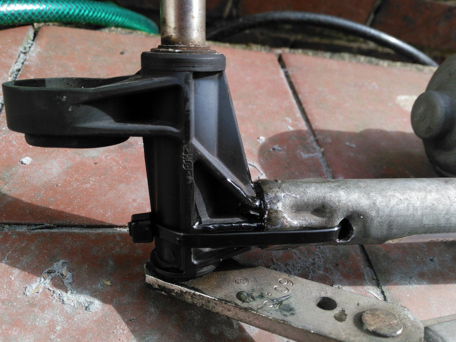

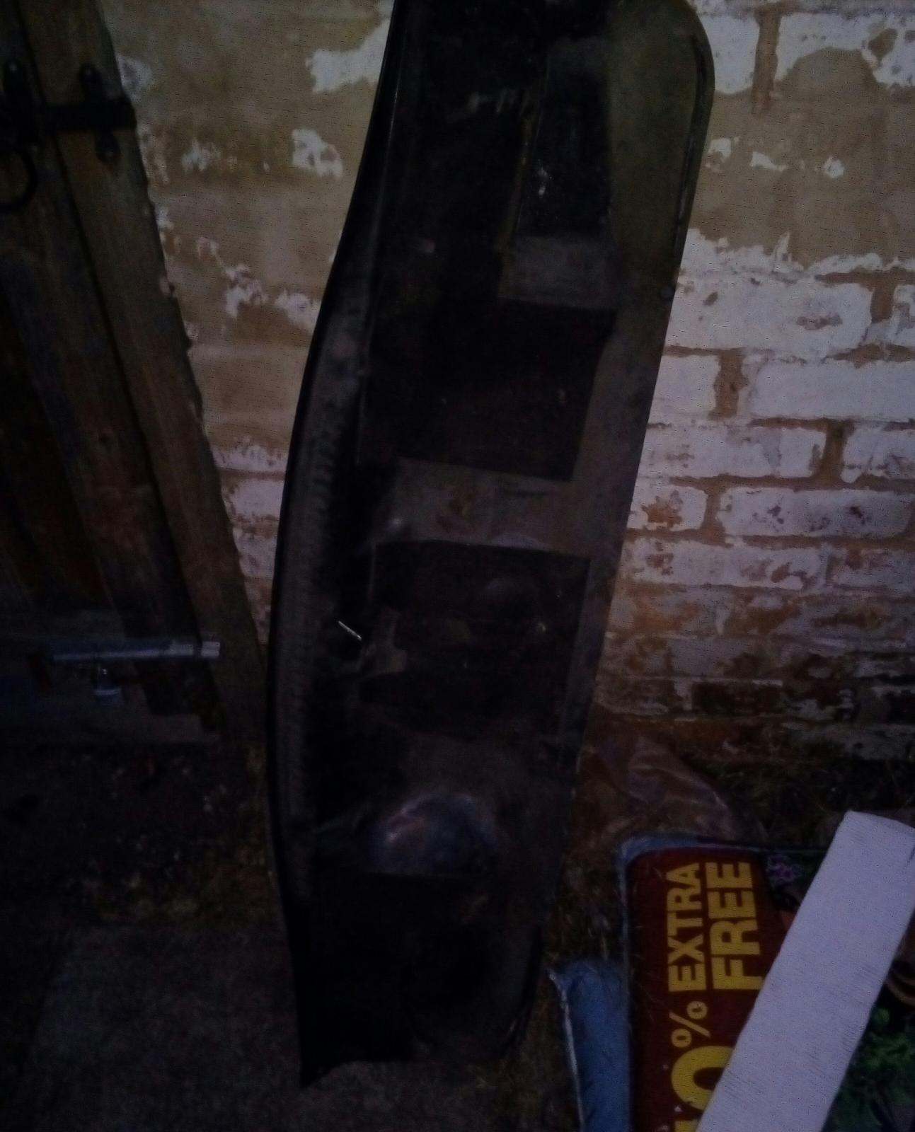

stripped fred Posted August 16, 2017 Author Share Posted August 16, 2017 Decided to try and replace the plastic bulkhead cover (or whatever it's called). This was removed to try and replace the pollen filter. You have to remove the wiper arms to allow the wiper mechanism to be moved out of the way. Still couldn't get the o/s wiper arm free. Access is limited as the plastic moulding gets in the way. Decided to use a crowbar. This resulted in snapping the support arm of the wiper mechanism. Great! It's now secured with cable ties. I started the job at 6.30pm and finished at 10pm in the dark. I did manage to change the pollen filter but it's not a lot of use as all the air from the engine comes straight through the vents which I don't think is that healthy. I seem to be going backwards at the moment. A fast depreciating car on PCP seems increasingly attractive! I've bought a used wiper mechanism off eBay for £35 so will attempt to change that when I have a fortnight spare. On a positive note I did manage to change a headlight bulb without fucking anything up... Link to comment Share on other sites More sharing options...
Dave_Q Posted August 16, 2017 Share Posted August 16, 2017 ALL MODERN WIPER LINKAGES R SHITE. I managed to break the linkage on my wife's 147 when trying to clear out the plenum drains to get to the bottom of a leak. On that the linkage is made of steel tubes with the pivot/bearing bits made of moulded plastic crimped in the end. Obviously once these get a bit old and brittle they break as soon as you breathe on them. New ones were £coinage but I bodged it up with cable ties and fibreglass. It's not pretty but it's probably stronger than the original. djimbob and stripped fred 2 Link to comment Share on other sites More sharing options...
stripped fred Posted August 17, 2017 Author Share Posted August 17, 2017 ALL MODERN WIPER LINKAGES R SHITE. I managed to break the linkage on my wife's 147 when trying to clear out the plenum drains to get to the bottom of a leak. On that the linkage is made of steel tubes with the pivot/bearing bits made of moulded plastic crimped in the end. Obviously once these get a bit old and brittle they break as soon as you breathe on them. New ones were £coinage but I bodged it up with cable ties and fibreglass. It's not pretty but it's probably stronger than the original. IMG_20170611_164303.jpg IMG_20170611_192658.jpgThanks Dave_Q. That makes me feel a bit better. I'm going to have a go at changing it when I've got some time spare and not under pressure to get it done for work the next day. Will buy one of those wiper pulleys as the wiper arm is properly seized on. Link to comment Share on other sites More sharing options...

stripped fred Posted October 9, 2017 Author Share Posted October 9, 2017 Update: As mentioned in another thread I managed to shear the supporting bolt from the wiper mechanism when trying to remove the driver side wiper. It still worked ok, until a drive down to London in the dark. That was quite scary but rain x helped. I'd already bought a replacement mechanism so I dropped it round the garage and left them to it as I was sick of messing about with it. All this was caused by me trying to replace the bloody pollen filter! I took it in for it's mot the other week. It failed. Quite a few advisories too. The drop links shows how even when I think I've fixed something, I haven't! I left the plastic covers on as I thought they were needed but I now realise they were for protection in the post. I'll do them when I get chance and also try and grease the brake pipes. It went in today to get the work done. Turns out the spring wasn't broken after all. The handbrake is loads better after they changed a caliper. I also asked them to check the auto gearbox fluid and it took a litre due to a slight leak. Will cost me £200 to get this fixed and the fluid changed. I also removed the screw from the tyre. No surprise that it now goes down after a few days so will need to get a new one sorted. Link to comment Share on other sites More sharing options...
