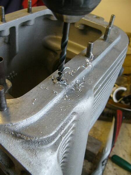

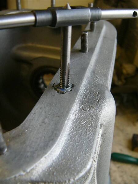

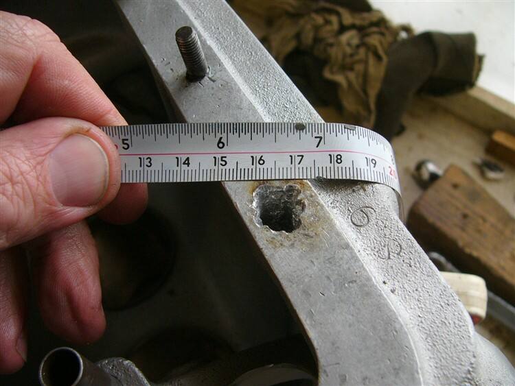

Bfg Posted April 21, 2019 Author Share Posted April 21, 2019 . ^ I totally concur. They're almost Victorian in many respects, but of course far more advanced This afternoon I popped out into the garage with just a couple of thing to try n' fix. The first was the petrol tank's balance-pipe had a leaky soldered joint, so a little petrol was still seeping out. And the second was to try and 'excite' the dynamo into working. I know how to follow the book telling me how to do this but tbh I really don't understand the engineering behind it ..so if someone else can explain that in simplistic mechanical minded terms, I'd be grateful. Anyways up, I re-soldered the fuel pipe (after taking it off the bike ! ) ..using my new Vortex blowtorch . . ^ I bought this set because it doesn't need me to find a lighter every time I want to use it and then because it comes with three nozzle sizes. My old blow-torches are fine for generally heating big things up, but are neither quite hot enough for annealing copper (head gaskets and sealing washers) nor fine enough for small soldering jobs like this fuel pipe's joint. I've read the Mapp gas is 25% hotter the propane so that should sort out my need to for cherry red copper, and then the bayonet fit choice of nozzles provide me with a very neat little flame.. Pretty cool ! ..isn't quite the right phrase to use when it comes to a blow torch, but I'm sure you get my meaning. NB. these blow torches have been criticized for the plastic of that bayonet connection breaking so after use I removed the nozzle and put it back into the plastic packaging and found a pipe cap to fit over the top of the torch head to keep crap out. It never ceases to amazing me - how having the right tool for a particular job makes things go so much easier. Fuel pipe duly re-soldered and refitted - Success at last no petrol dribbles at all. - - - Onwards and upwards ..to the dynamo - Charge ! I had one last inspection of the stator to see again if I might see any fault, I couldn't but had a twiddle with the wires anyway. And then I cleaned the armature ring (simply wiping it clean with carb-cleaner on a clean cloth) before refitting the stator to the bike. ^ Started the bike and.. low and behold it worked ! albeit at what seemed to be quite a lot of revs compared to the quite slow tick-over of these bikes. ..and with the ammeter needle bouncing back n' forth as if it were enthusiastically folk-dancing a jig ! Photo above taken while the engine was spinning away at something like double the tick-over speed. Come to think of it that's only 1200 rpm's Perhaps it worked before.. but I just needed a bit more throttle ? who knows ..and I for one don't care. All that's important is that IT WORKS ! I'm feeling well and truly chuffed. Yes OK., I'll try swapping the ammeter for another, tomorrow ..And if that doesn't help then I'll try swapping out the voltage regulator. Who knows I might finally be very close to getting a second bike roadworthy and on the market. That's it for tonight, I wish you a good'n. Bfg p.s. I wonder., Does anyone here have any experience of selling via one of the big auction houses like Bonhams ? Squirrel2 1 Link to comment Share on other sites More sharing options...

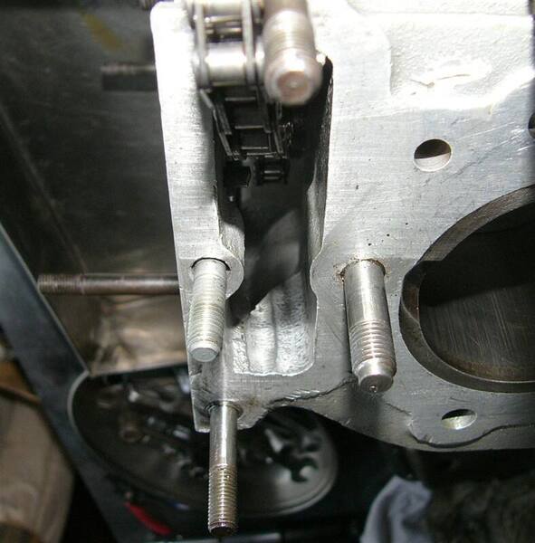

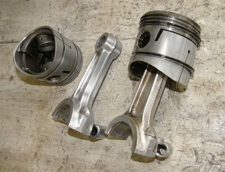

Bfg Posted May 4, 2019 Author Share Posted May 4, 2019 . Cylinder head lifted this afternoon. All looks good so far ..save the piston being seized in the bore. It a bit sooty in the combustion chamber but that's to be expected after having filled each cyclinder with pentrating oil and having run it (just for a few minutes) last time thing locked up. I can't see the piston or the cylinder bore until the former is removed ..which means dropping the sump and again trying to turn the crank with timber levers. There's no point in my releasing the big end cap yet because if I do that then I have no means to move the piston save a wooden block and a big hammer ..and even then it would go downwards and I need it to come up and out of the cylinder bore.. I drained the oil overnight, so now it's now time to get back to the garage and low tackle it ;) - - - RayMK 1 Link to comment Share on other sites More sharing options...

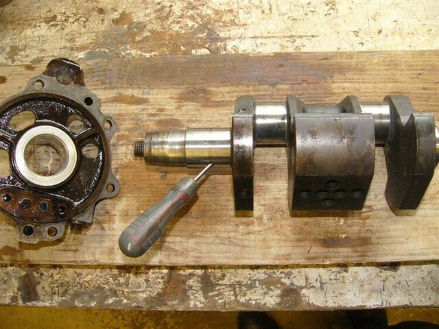

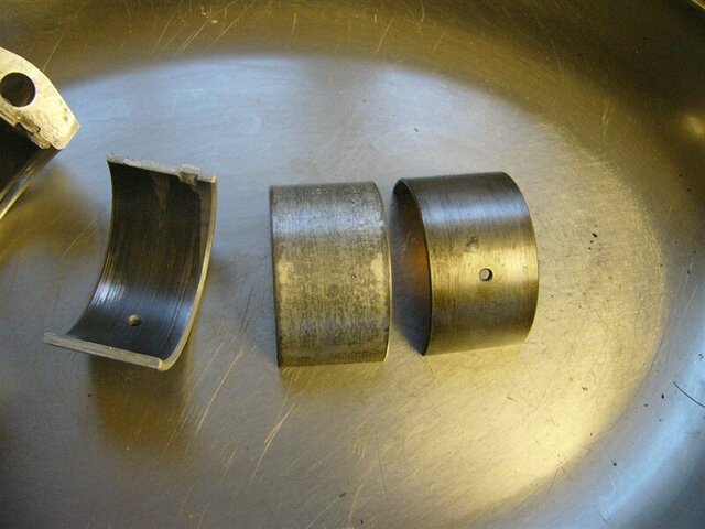

Bfg Posted May 4, 2019 Author Share Posted May 4, 2019 . Well. . . The good news is - the piston was not seized in the bore :) . . . But . . , the bad news is that the forward big end shells were seized onto the crank :( . . . ^ they are meant to be white metal bearing surfaces. On the right hand pair of big end shells the white metal has totally worn away to reveal the copper plating underneath. Thankfully, no damage was done to the crank's journals (..bearing surface). The oil way through the crankshaft itself is clear. Even so the rear bearing (left) doesn't look brilliant either. However, the small oil feed hole in the one shell (middle in the photo above) is hard blocked with the white metal (or whatever is now used to coat the bearing face of the shell). These holes don't lead anywhere so I don't know how significant that is. I did wonder if the holes were the right size (aftermarket shells or whatever ?) so I went out to the shed where I have all sorts of used Sunbeam junk ..and found another set of shells with the same size (if not slightly smaller) holes. These are Vandervell shells and I assume them to be correct. As it happens they were also badly worn. But perhaps more interesting is that I'd marked one, in felt pen, with the letters KTO ..this bike's registration number.. Huh ! ? .. I remember correcting the wrongly assembled rocker shaft, which was starving the camshaft of oil ..and I remember checking the big ends, dropping the caps to check these shells and then making sure the bolts were correctly torqued and the split pins were new and correct, but I had long since forgotten that I had changed the shells too.. Only now do I recall using good but used or perhaps new-old-stock shells I'd bought from a former Sunbeam expert. I know I wouldn't have put junk ones in. But being second hand does account for the discolouration of the back face of the above shell. So the question I'm faced with is : why is this engine knocking out its shells ? The shells I put in were the same +0.030" as previously fitted. And if they had been too tight then the crank would not have swung. So the shell's size is right, the oil is correct and a good brand name, and the crank is a centrifugal gallery type which I can feel is clear and cavernous. There's plenty of oil getting up to the camshaft.. So it seems as if I'm going to have to pull the engine out of the bike and to totally dismantle it - to check the oil way which feeds the crankshaft.. What a pisser ! The oil feed to the crank is from the rear main-bearing (fed by the mechanical pump). This has a gallery around it with take-off drillings to the camshaft, to the cam-chain idle wheel, to the oil pressure relief valve, and to the crankshaft. Somehow it seems as if that drilling leading to the crank has got partially blocked (don't look at me - I did not rebuild this engine!). Some oil is getting through, and that first feeds the rear big end shell, what's left over goes to the forward big end shell. Oil lubricates the big ends as it squeezes out of its bearings and (thanks to centrifugal force of the crank spinning) is then flung off to splash coat the pistons' gudgeon pins and cylinder bores. Monday's mission impossible is to identify and eliminate the culprit blockage. Have a good weekend, Bfg :( stonedagain, Scruffy Bodger and captain_70s 3 Link to comment Share on other sites More sharing options...

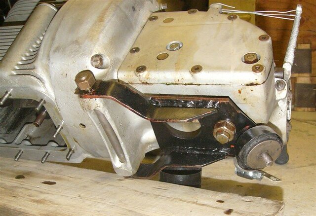

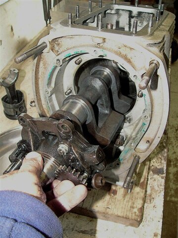

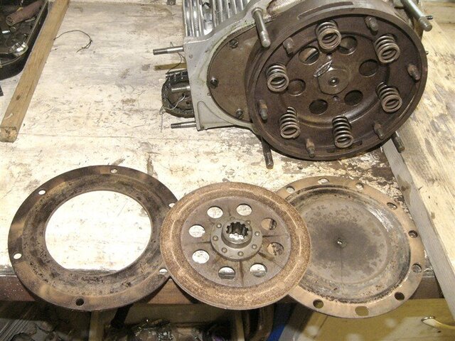

Bfg Posted May 7, 2019 Author Share Posted May 7, 2019 . Good morning, and what a beautiful day it is too. Below is just a quick pictorial update to what I was doing yesterday . . Electrical boxes moved out of the way, cables and wires disconnected as was the drive shaft, then I lifted the engine out. In this state, without the cylinder head and all the ancillaries or oil I can manage this by hand, without block and tackle. The early (1946 - 1949) Sunbeam is a near extinct beast now, and almost every component was altered for subsequent production of the S7-deluxe and S8 bikes (1949 - 1956). While I have this bike's engine out I've taken the opportunity to photograph dozens of these differences for record. The four bolt gearbox casing, its drain plug, and the rear engine mount bracket, seen above are just some of these. In due course I'll publish these on my own Sunbeam R and R website (there's a link to that in my signature) as a reference for others who might be restoring these bikes. I then proceeded to split the engine from the gearbox. The in-series ('S' : series type Sunbeams) twin cylinders, dry clutch, gearbox and shaft drive is pretty apparent from the above photo. And again the vented louvred cover on the bell housing, and also the clutch-enclosing flywheel assembly are unique to this model. The latter is to prevent oil from leaking onto the clutch. It's just so common-sense to do this when you think about it, but where else have you seen the idea.? Unlike a car's clutch - the Sunbeam's pressure plate (lower right) sits against the clutch springs. The friction plate is centralised to slide on a spline on the gearbox input shaft, and the backing plate (lower left) is then bolted to the shouldered studs on the flywheel. A central pushrod, activated via a lever at the back of the gearbox (see previous photo), operates against the pressure plate to compress the springs, thereby releasing the compressive grip on the friction plate. And yes., the pushrod does go right the way through the gearbox's main shaft. I'll not bore you with photos of the pistons being removed, pulling the flywheel off, or the engine's rear cover, but jump forward to a photo of these bike's timing gear This is as dismantled. I haven't cleaned anything yet. The end of the crankshaft is the light coloured gear in the middle. To the left (which is at the bottom of the engine) is the geared oil pump with a pressure relief valve next to it. The overhead camshaft timing gear has spokes (..lightening holes) on these early bikes. Later types didn't have those holes and were twice as heavy. The cam-chain and sprocket can be seen under it. The bolted oil-stained casting is the main-bearing carrier. It is drilled to route oil from the oil pump into a gallery around the main bearing, and from there to pressure feed oil to the crankshaft, the timing gear's spindle, and to the drilling up through the crankcase for the valve gear. All oil ways are internal on this engine. Oil-return is gravity to the wet sump with its pan style gauze filter. The main bearing carrier and crankshaft being withdrawn. And just as I suspected - the drilling which feeds oil from the rear main bearing into the crankshaft was blocked hard and solid. It is truly amazing that this engine ran for more than just a few minutes. The fact that I've ridden it a few miles and presumably so did the previous owner who rebuilt it .. is a credit to the robustness of its 1940's design. I had to drill the crud out of the hole ..the blockage was hard and about an inch long, so not just a bit of paper towel or whatever lost inside during the rebuild. The crankshaft itself is in part hollow, insomuch as there is a large diameter gallery, running forward to back, inside the big ends. The (above) drilling leads oil into this chamber, which in turn feeds the big end shells and splash lubricates the bottom of the pistons and the bores. At the other end (the front) of the gallery there's a big screw plug, to close it off. It is part hidden by the front main bearing, but with that removed the chamber can be cleaned out. That has happened on this engine, but the engine rebuilder couldn't have thoroughly checked the oil feed drilling. It's a simple error to make, but the real mistake was in not checking it was clear after the main chamber had been cleared out. A good mechanic is not only conscientious in his working standards, but also double checks things as he or she goes. Parts cleaner now flushing through the cavities. Clearly there is now no restriction to flow. Now all I have to do is to clean everything up, assess the damage and rectify it, and of course put it all back together again. Tbh though - I am feeling really very glad, relieved, and grateful to He above. The damage from this blockage might so easily have been much worse, and perhaps even have written the engine off ..and the bike too if it had locked solid when under load riding at speed (these bikes do 80+ mph). Furthermore the likelihood of finding a replacement engine does not bear thinking about, neither does the cost I might have incurred. phew ! Bfg. RayMK, stonedagain, grizgut and 4 others 7 Link to comment Share on other sites More sharing options...

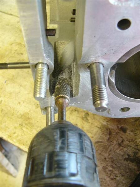

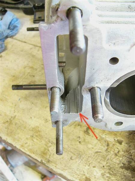

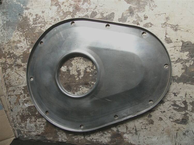

Bfg Posted May 23, 2019 Author Share Posted May 23, 2019 . .. it's been a couple of weeks since an update, so a quick pictorial for you . . ^ just a little tidying up. The con rods on these engines are forged aluminium. It's not a performance engine so I don't worry about lightening things. All I do is to clean up the original rough cut edges where the flash had been removed ..to lessening the hard edges where stress might start a crack from. The pistons with a split skirt are non standard - but they fit and the bike was running well before it was starved of oil by the blockage, so they can go back in. ^ a little more clearance. The block is laid on its side on the bench and this slot at the back of the engine is where the cam-chain runs. Inevitably at some time the chain has been slack and flapped around a bit. This cuts grooves (see arrow) which then leaves hard edges. Again I don't like epicenters for stress cracks to develop so I cut the aluminium crankcase back for a little more clearance. (Below) ^ it doesn't need to be smoothed out and polished. I just cut back to as deep as the chain had worn. No more, no less. This is one of the sump studs, which I had helicoiled a few weeks ago, but clearly it had pulled out when I tightened the sump nut. This was a bit of a surprise because it's only a 1/4" stud that goes in there and the gasket I made is cork, so it was not very tight. Anyway it needed doing. ^ This is what I found.. I didn't drill it out like this. Clearly it had been a problem for someone beforehand and they had drilled a very rough hole and filled it. I don't know what it was but possibly epoxy filler paste. What do you do with a hole like that ! ? ^ Well I had recently bought a new blowtorch and some HS2000 rods, which are in effect a low melting point aluminium alloy. I melted this into the hole to fill it up. Not totally successful as you can see, because the blowtorch couldn't get the surrounding aluminium hot enough for the filler alloy to flow fully into every crevise (..after all this crank case is designed as a heat sink to dissipate heat !). Never-the-less what is in there appeared to be tight. ^ I proceeded with drilling a hole for the stud, using the cast aluminium sump itself as a pattern ^ well it might not have been a pretty repair but drilling this alloy is just like drilling other aluminium. And the 'fill' stayed in place so it can't be too weak. ^ Tapping the fill with 1/4" Whitworth for the stud also went fine. ^ well that seems to have worked. I added a few drops of wicking lock thread around the 'fill' just to make sure, and when that was well dry - I filled the rough hole edge with Araldite epoxy so the gasket will have a flat to seal against. It certainly seems as strong as any other stud now, and at the end of the day will only be torqued to 6 to 8 ft-lb. That'll be all for today but I do have a few other tasks done to share. Bfg RayMK, Mally, captain_70s and 2 others 5 Link to comment Share on other sites More sharing options...
