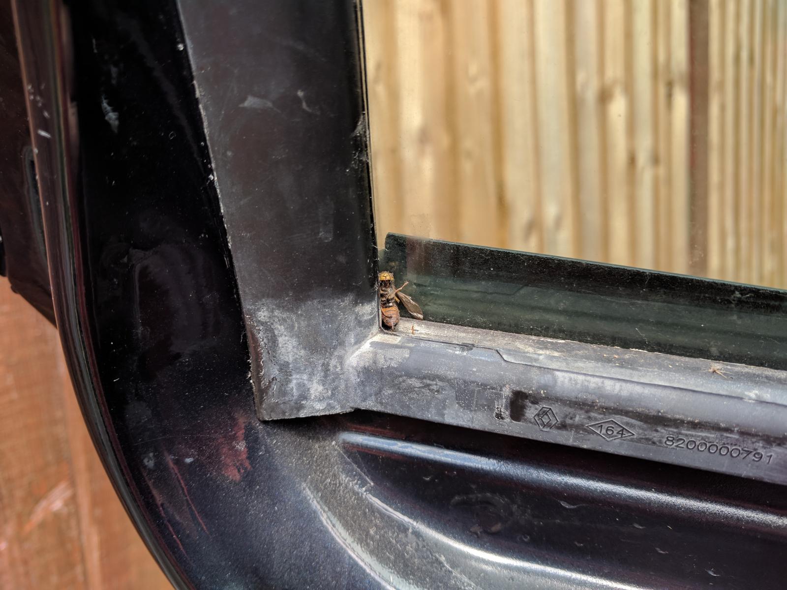

beko1987 Posted July 9, 2017 Author Share Posted July 9, 2017 So, window. I didn't want to write off a day playing with the kids by starting something I couldn't finish so I u clipped the glass and slid it up. I then cable tied it to the middle bracket, and cable tied around the left bracket under the glass to hold it up, then wedged several cable tie tails around the frame. I found a crispy wasp And that this door is not original to the car Couldn't be bothered taking the wheel off again to try the caliper without the spring, ill order a new second hand one tomorrow for £20. I went for a 20 mile drive, mainly to check I'd not buggared anything up with the egr or swapping the wheels. It seems a bit nipper, but speed was hampered by horse boxes. I briefly got to 75 and theres little wheel shake to note! I tried hammering the handbrake lever out of the old caliper I kept from last time and there was no budging it, so I'm not going to try and repair the drivers side one,not when their £20 delivered from renparts. Interestingly though, after my drive the handbrake noise went on for longer. I only went around the block yesterday, when the new caliper is fitted I'm tempted to just leave it, drive to work (25 miles) the put the hbrake on. Sod it, do or die. Link to comment Share on other sites More sharing options...
Hendry Posted July 9, 2017 Share Posted July 9, 2017 Im shocked somebody actually went and bought a brand new genuine Renault door for a 7 year old (at the time) Laguna given the amount of them in breakers they couldve just gone and got one off of!! Top bodging btw!! I just couldnt do that, the pedant in me would have to have it fixed and working like its supposed to. I envy people who just can let stuff like that go without getting bothered about it! beko1987 1 Link to comment Share on other sites More sharing options...
beko1987 Posted July 9, 2017 Author Share Posted July 9, 2017 One day I might tinker, but since I've bought it only one person has sat there... I only opened it usually when I dropped all the windows on a hot day before getting in, letting the air con get cold then doing them up again! I'm not spending money on a part that could fail again at a moments notice. Drivers window I would, but that's because I smoke Link to comment Share on other sites More sharing options...
beko1987 Posted July 9, 2017 Author Share Posted July 9, 2017 And same about the door! It can't have been much damage as the shuts etc aren't bent. Wonder how much that cost! Link to comment Share on other sites More sharing options...
Hendry Posted July 9, 2017 Share Posted July 9, 2017 And same about the door! It can't have been much damage as the shuts etc aren't bent. Wonder how much that cost! Mustve been an insurance job for sure, I dont think anyone wouldve forked out that kinda money themselves. beko1987 1 Link to comment Share on other sites More sharing options...
