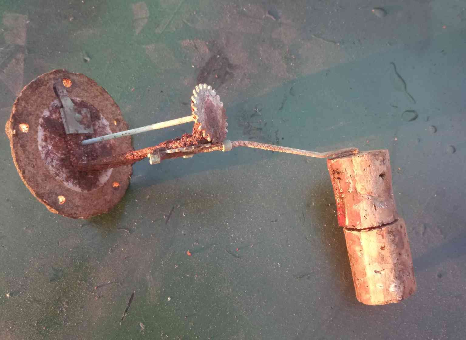

Joey spud Posted August 12, 2018 Share Posted August 12, 2018 Using a fish tank level sensor on a fuel tank is pure genius. AMC Rebel, Mally and alf892 3 Link to comment Share on other sites More sharing options...
cros Posted August 12, 2018 Author Share Posted August 12, 2018 Using a fish tank level sensor on a fuel tank is pure genius.Its pure stinginess really. There is a plastic sensor made for landrovers which works well and costs around £20. I should have used this but I suffer from an old persons desease, I still think that this is a weeks wages. Happily I am fully adjusted to beer costing £3.60 a pint. It was 26p when I worked in a bar (Tartan bitter), but it tastes far better now which is something to be cheerful about. Banger Kenny, Sigmund Fraud, Skizzer and 3 others 6 Link to comment Share on other sites More sharing options...
mercrocker Posted August 12, 2018 Share Posted August 12, 2018 If the third float sender I am about to try on my Cowley (along with another fuel gauge already trialled) doesn't work I might have to give the fish tank thing a go myself....Bloody good idea. Watney's Starlight was 28p when I first started work in a Shell garage. Used to get a 50p tip every Friday from a local factory manager whose Citroen CX came in for oil check and tank fillage so that was the first two pints of the weekend nearly covered! On thread - looking forward to the resplendent black and green Beddy, such a period colour scheme that.... cros 1 Link to comment Share on other sites More sharing options...

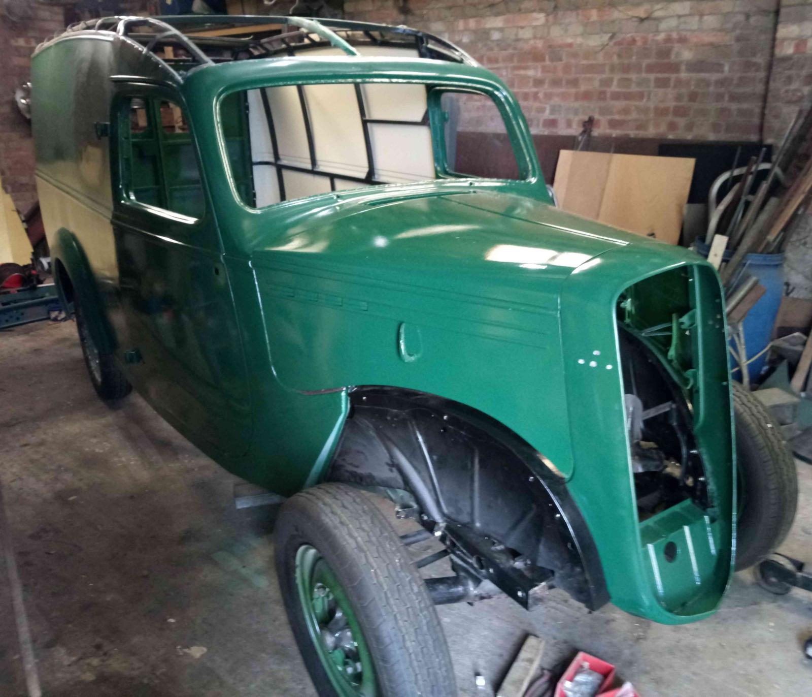

cros Posted August 12, 2018 Author Share Posted August 12, 2018 I feel I have to own up to a painty cock up. I originally did it in a "Mid Brunswick Green" which looked OK when I ordered it from how the colour appeared on my phone. Thats probably as big a sin as the people who buy a house on 'homes under the hammer" having never previously viewed it. I went ahead and sprayed it on, knowing it was too light for what I wanted, and then had to re-do it in a darker shade. (Wheel rims are still in the lighter green) I believe its less time consuming to settle on a colour before you start spraying, but there you are, I've been in the Autoshite confession booth and feel much better now. Skizzer, Sigmund Fraud and mercrocker 3 Link to comment Share on other sites More sharing options...

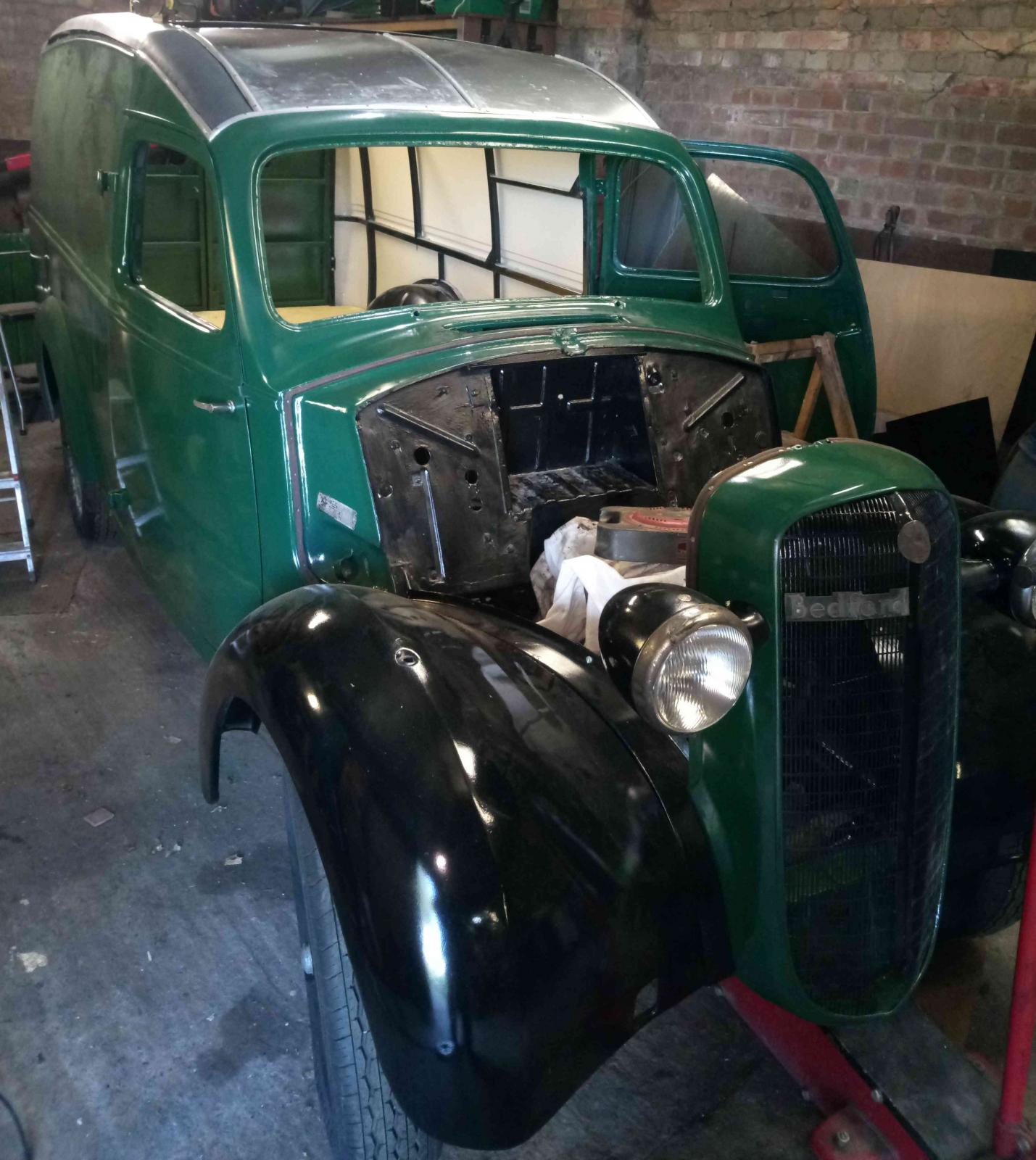

cros Posted October 20, 2018 Author Share Posted October 20, 2018 A bit more bashing has been carried out and I've also fitted the headlamps to make the van look more complete as enthusiasm was flagging. The old lamps were tarnished so these are Indian made and come in a box of 5 for £30 including postage. I didnt want that many but maybe thats just a years supply... Originally the roof was canvas on a bed of thin wooden lathes held together with tacks. I'm doing the curved sides in steel and the top in aluminium. It would be a insult to proper panel beaters to regard my methods as good practice, but at least it'll stop anyone with a penknife getting in the through the roof. The panels were curved a bit at a time over a lump of old propshaft clamped in the vice. It looks crude, but I draped a bit of rag over it before making the bend- I'm not a fucking savage. Fine tuning was done on a bit of tree.Ive also started on the brakes, the master cylinder has new seals and is in place. The clutch on these is cable operated, but its not the modern type of cable with an inner and outer, just a length of cable. This means there must be a strut to prevent the engine and gearbox being hauled backwards each time the pedal is depressed. I might make some changes here.... binhoker668, Jim Bell, Tickman and 14 others 17 Link to comment Share on other sites More sharing options...
cros Posted November 8, 2018 Author Share Posted November 8, 2018 The roof is finally done. It doesn't look great because I'm a messy bugger and have managed to get black gloop everywhere- face looks like a Dalmation. Problem (excuse) was that the main part had to be screwed down in one go having been previously drilled and tapped. In the frenzy of putting in a billion screws before it set some sealant must of oozed out... I collected a drop-glass and inner windscreen surround on Saturday from the Vauxhall spares man. They added a couple of inches width to the bodies of their post war cars, so like the early Morris Minors I'll have to have a plate over the gap. No matter, I'm glad to find the part as its an awkward shape to replicate. alf892, D Spares & Tyres, Mally and 16 others 19 Link to comment Share on other sites More sharing options...
