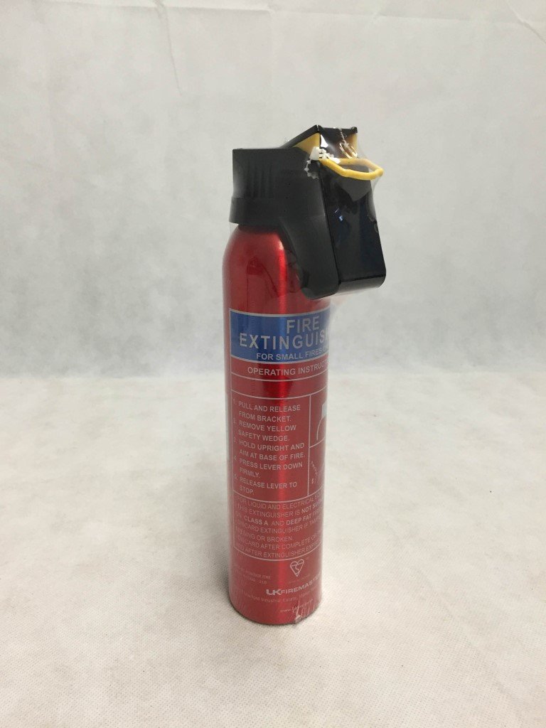

overrun Posted February 23, 2017 Share Posted February 23, 2017 Eddie Honda 1 Link to comment Share on other sites More sharing options...

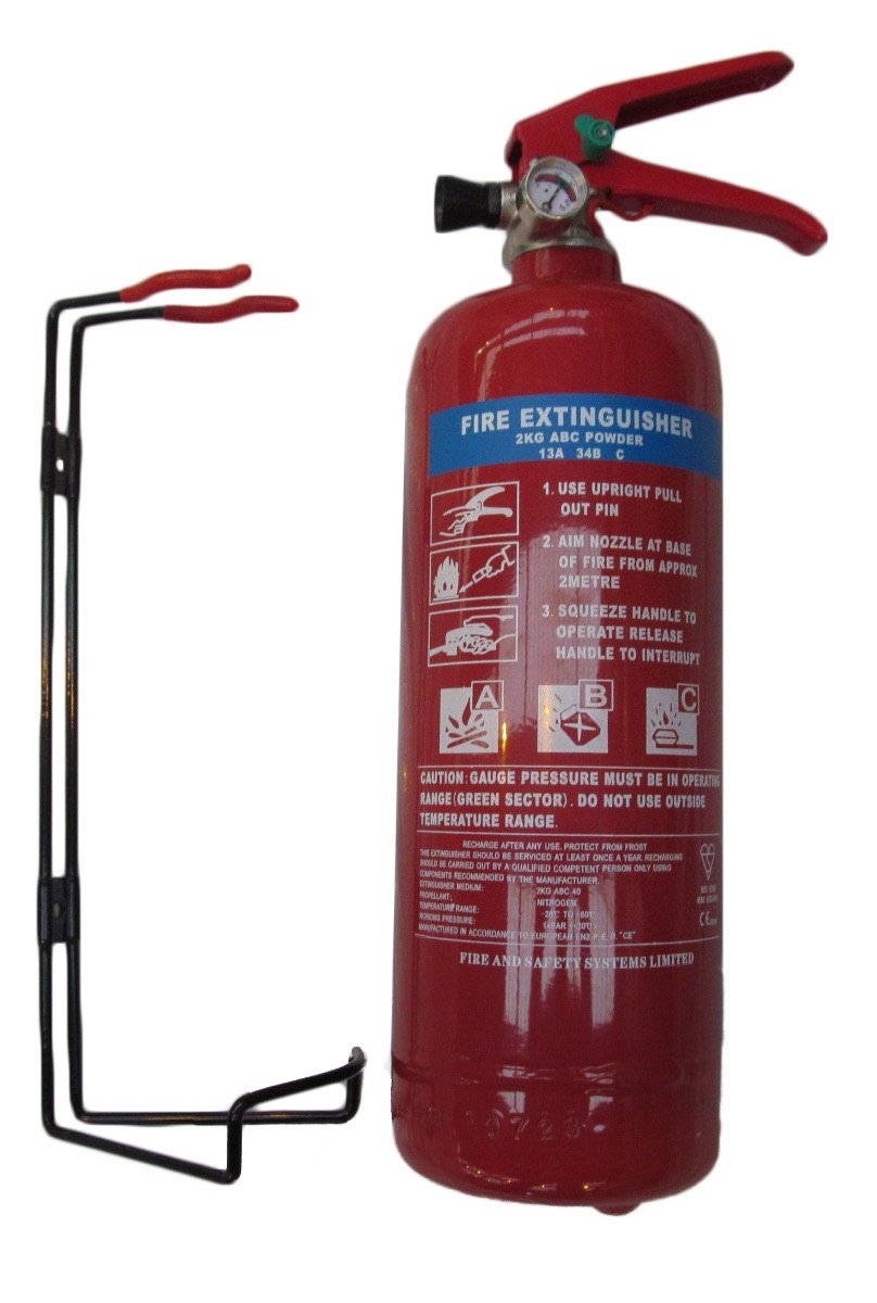

inconsistant Posted February 24, 2017 Author Share Posted February 24, 2017 Still looking for recommendations. What about this 2kg powder one for the kitchen and maybe another for upstairs or the shed as seems a good price (£16 inc delivery): https://www.amazon.co.uk/Powder-Extinguisher-OFFICE-Fully-Certified/dp/B008D3M0B8/ref=sr_1_9?ie=UTF8&qid=1487937448&sr=8-9&keywords=car+fire+extinguisher And this £9 600g powder one for the car: https://www.amazon.co.uk/d/Fire-Safety/Eurax-NEX01201-Fire-extinguisher-600/B007T74X78/ref=sr_1_14?ie=UTF8&qid=1487937820&sr=8-14&keywords=car+fire+extinguisher Yes/no? Bigger/smaller? Cheaper/ more expensive? Powder or not powder? Sorry to keep asking, I want to get these while it's on my mind, otherwise I'll end up putting it off and intending to do it but not actually doing it, Squire_Dawson 1 Link to comment Share on other sites More sharing options...
Squire_Dawson Posted February 24, 2017 Share Posted February 24, 2017 Would keep the top one in the car and the other in the kitchen plus fire-blanket. Link to comment Share on other sites More sharing options...
