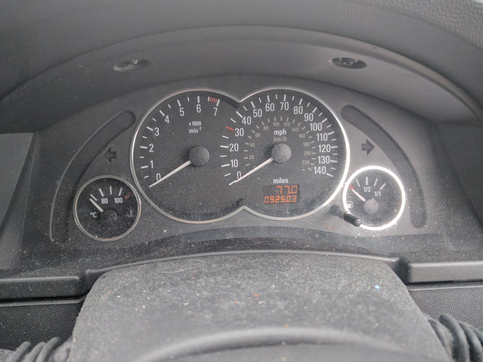

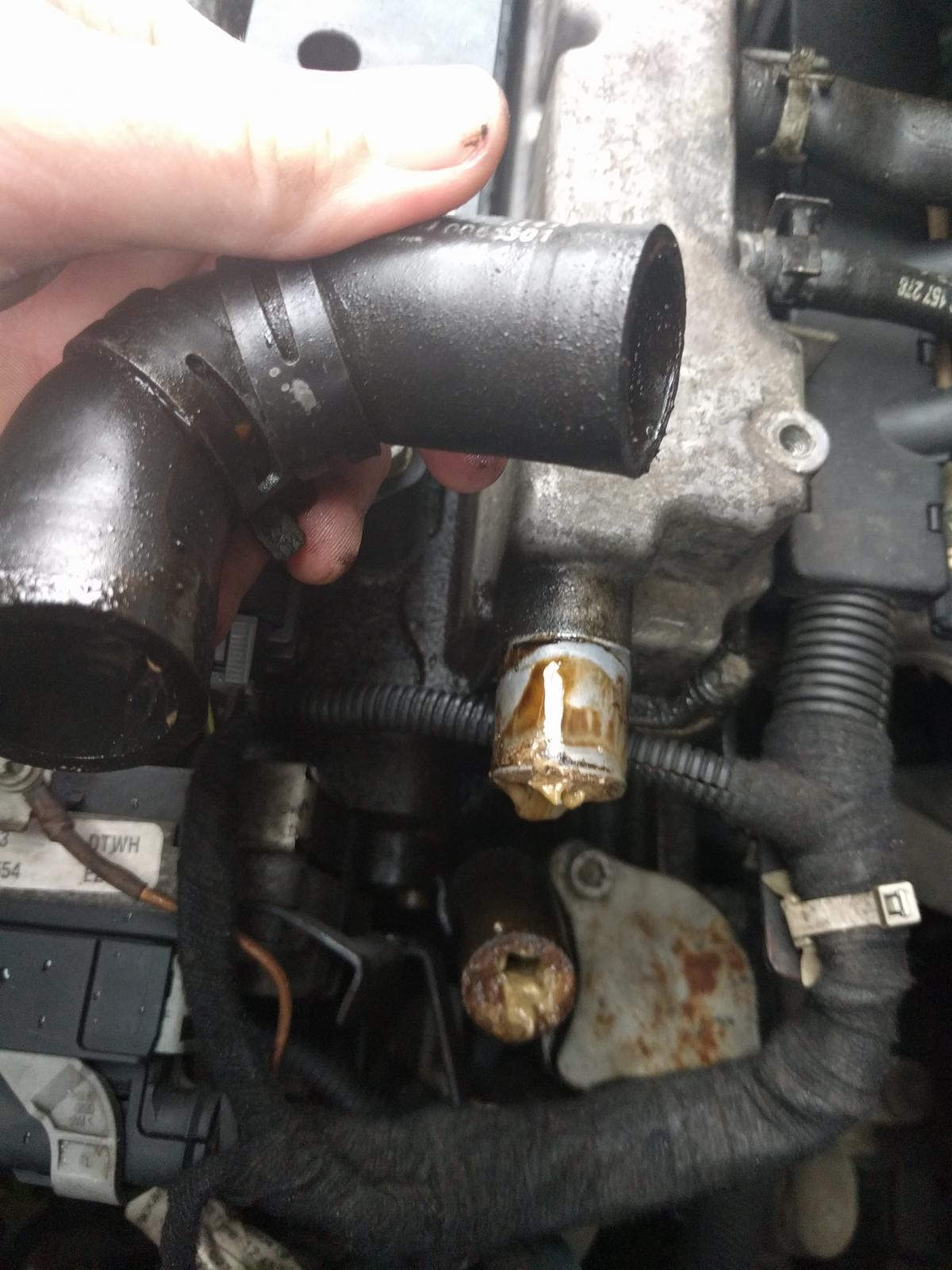

beko1987 Posted February 9, 2017 Author Share Posted February 9, 2017 Cambelt changed on the 25th June 2015 at 84kish miles! http://autoshite.com/topic/20858-meriva-a-z16xe-cambelt-change-success/page-3 Oddly the temp gague worked back then apparently, so maybe the £cheap ECP thermostat is gubbed and the heater matrix needs a flush. Or it just runs cold. Forgot another thing, air con re-gassed on the hottest day of the year in 2015, so it's ice, ice cold! Link to comment Share on other sites More sharing options...
Cavcraft Posted February 9, 2017 Share Posted February 9, 2017 My money's on the 'stat, Beko, quite common on these. beko1987 1 Link to comment Share on other sites More sharing options...
beko1987 Posted February 9, 2017 Author Share Posted February 9, 2017 I reckon you should drive your Zafira down, purplebargeken trains it over and you drive the meriva home and ken drives the Zafira home... Then I go to the pub eddyramrod, Cavcraft and Dave_Q 3 Link to comment Share on other sites More sharing options...
SiC Posted February 9, 2017 Share Posted February 9, 2017 Probably the stat, I changed one on our Z16XE in an Astra G. Mega easy job on them. Couple of bolts on top of the engine, new gasket and new housing. Reassemble, add coolant, burp and done. Temperature sensors are known to fail too. I bought a cheap one off eBay to replace the one on the Astra as a precautionary measure for it to fail soon after. Ended up buying a genuine replacement from Vauxhall. Still have the original working one somewhere (probably should have put it back on after the cheap aftermarket broke). GLWTS. Link to comment Share on other sites More sharing options...
Kiltox Posted February 9, 2017 Share Posted February 9, 2017 Easy job on these too - I did one on a Corsa C which probably actually had other issues beko1987 1 Link to comment Share on other sites More sharing options...

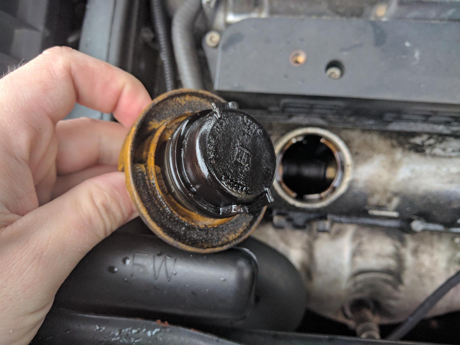

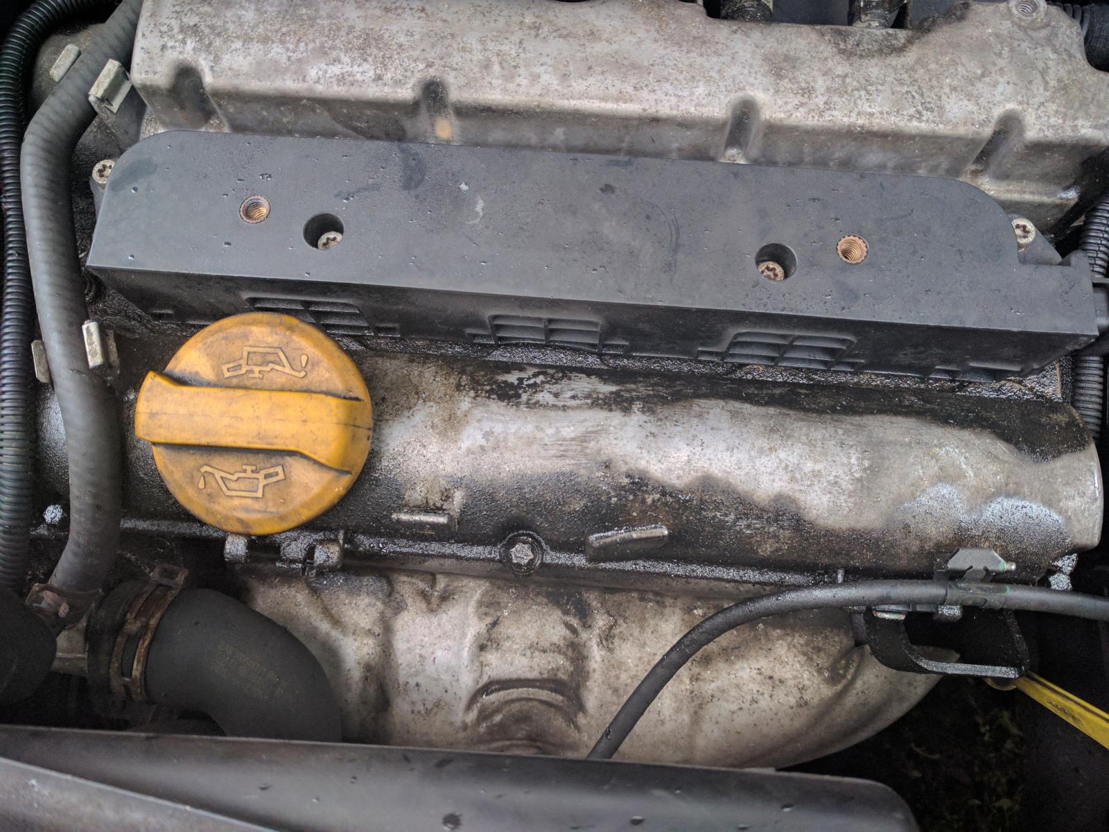

sierraman Posted February 10, 2017 Share Posted February 10, 2017 The gunging up of the breathers on these is quite common, chances are the stat is fine, you get it when they have short runs. Had this recently on a Corsa, it's not something serious as it looks. Link to comment Share on other sites More sharing options...
