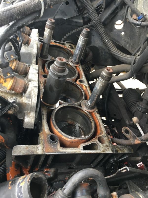

Captain Furious Posted March 22, 2017 Author Share Posted March 22, 2017 I haven't had the rocker cover off and the oil filler cap is remote on these so I can't see into it either, but the mayo came back with a vengeance even without the engine going through a cool down / warm up cycle, so condensation is out! It's never overheated yet, but I reckon it's only a matter of time and I'd sooner tackle it before it does. Could you expand on dealing with the cylinder liners? I've done head gaskets before but not on engines with cylinder liners, and cursory googling so far is throwing up worrying story's about having to replace wet liner seals etc Link to comment Share on other sites More sharing options...
RayMK Posted March 22, 2017 Share Posted March 22, 2017 As your engine has not overheated, it would be reasonable to assume that the liner seals are ok. This assumption will be reinforced if examination of the head gasket and the mating faces shows a leak path and/or corrosion. Liners are supposed to stand slightly proud of the block in order to achieve a good seal on the head gasket while maintaining the required liner clamp down force. Measure the liner step (the dimension of 'proudness.') for each one and compare the figure with manufacturer's recommendations. If the liner(s) have sunk below the block face, new seals will be required and that can be a bit of a game in a higher mileage engine (limescale and other crud). It is important to put clamps across the liners as soon as the head has been removed, otherwise there is a risk of them moving if, for instance, the crank has to be turned for some reason. Link to comment Share on other sites More sharing options...
Captain Furious Posted March 22, 2017 Author Share Posted March 22, 2017 Great info, thanks..I would have probably gone in like a trained ape and torn the head off with carefree abandon. Now I sort of get the principle behind them and can take the appropriate precautions. (I do have a HBOL so will do some revision from that as well as online) Assuming worst case and they needed to be replaced, that's presumably a sump off and disconnect the conrods job? Link to comment Share on other sites More sharing options...
RayMK Posted March 22, 2017 Share Posted March 22, 2017 Yes, quite major . I have not dismantled a 205 engine and am far from being an expert on them. I have, however, dismantled Reliant 600 and 700cc ohv engines which share the typical wet liner layout. Pulling the liners out is difficult and really needs the pistons out of the way. Putting new liner seals in, together with new liners or cleaned up originals if the bores are ok, is a bit easier once the block has been cleaned. I think I would go for a 2nd hand engine from a crashed Gti (obviously rear ended preferable) or one which has been scrapped because of a failed rear beam and/or corrosion (rare), rather than fiddle with the liners on a high mileage engine. Captain Furious 1 Link to comment Share on other sites More sharing options...

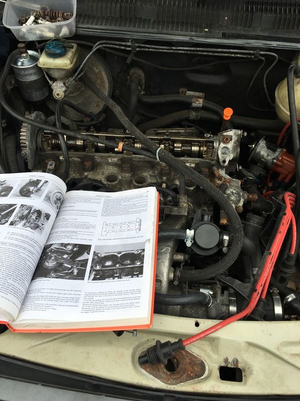

Captain Furious Posted April 21, 2017 Author Share Posted April 21, 2017 So, I finally managed to snap out of my recent funk long enough to get round to this, last week I ordered the necessary quality* parts from ECP with their special Easter discount. Head gasket set, water pump, timing belt kit, oil, antifreeze, filter and camshaft seal. Still need to source some head bolts as ECP don't list them. New parts arrived - excitement Upon checking in the box, it appears that the "head gasket set" comes with all gaskets except........a head gasket. So a phone call to ECP where the claimed, incredibly, that this is correct and the actual head gasket is separate. I felt I was having my pants pulled down, but since ordering it I'd kinda decided I wanted a genuine gasket anyway, so one is on order from the local Peugeot dealer Without further ado, guided by HBOL, we set about ripping its head off. Everything went reasonably smoothly (so I'm told, I actually ducked a lot of the work because I went to get my hair cut and had to wait for DHL to come) I got there for the actual head removal. I think we managed this without disturbing the wet liners and secured them in place with some big washers/sockets/headbolts The head itself and gasket didn't show the obvious signs I was sort of hoping for, but there was signs of leakage in the centre water jacket holes and piston number 3 had water in it. The head looks as though it's possibly been overheated at some stage, but not while we've had it. So that's where it's at, head has been dropped off at a local engineering shop for a skim and pressure test, then we'll remove the valves, lap them in, replace stem seals, Reassembly is reversal of removal etc etc probably next Thursday/Friday Kinda felt good to do some old fashioned mechanicing again Coprolalia, paulplom, paulscavalier and 4 others 7 Link to comment Share on other sites More sharing options...

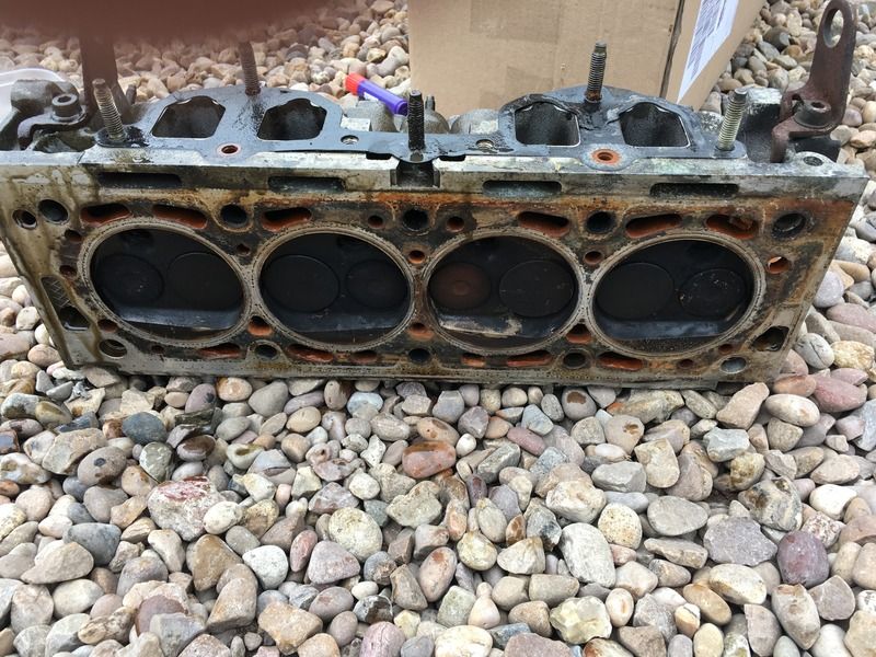

Captain Furious Posted April 28, 2017 Author Share Posted April 28, 2017 Well, I was planning to do a super interesting* update including step by step pics of head being skimmed, valves reground, re-assembly with new timing belt, water pump, gaskets etc All of these activities took place, and we got it running again today, the net result is that It still misfires and hesitates at 3500rpm and I'm starting to lose the will to throw any more money after it The head gasket was definitely gone, no doubt about that, and I think it is now OK, the header tank no longer pressurises excessively, still signs of mayo in the filler cap but I don't think we've got all the moisture out of it from before, the oil in the sump is staying clean. Time will tell So I dunno what next, adjusting the ignition timing made a difference in that it would pull to the redline once it got past the 3500rpm stuttering, but no adjustment that has hitherto been tried has got rid of the 3500rpm issue. So I'm thinking it might be an internal issue with the distributor advance mechanism/spring/whatever But I've thought it's been a lot of things and been wrong every time, so fuck knows. It's getting towards 'show season' when my other cars need attention, all of which I love more than this ungrateful heap of shit, and money is a finite resource. Coprolalia 1 Link to comment Share on other sites More sharing options...
