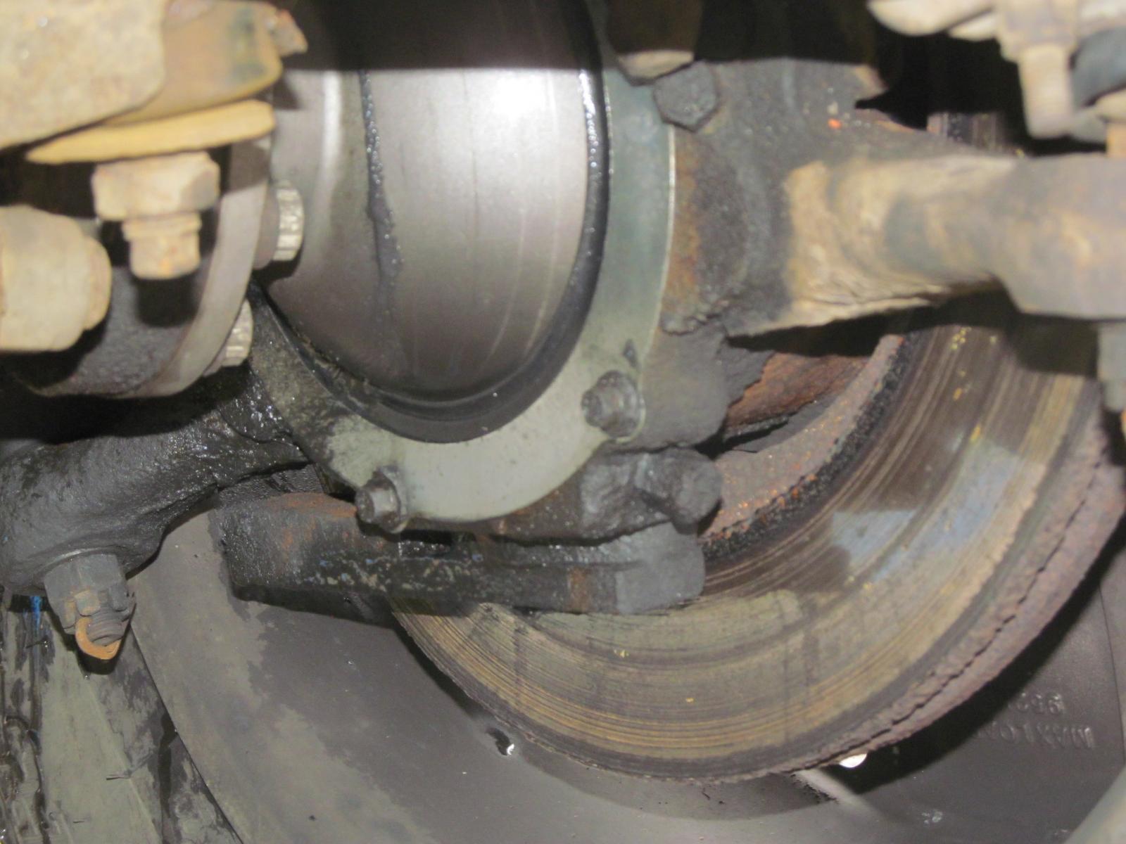

AMC Rebel Posted March 19, 2017 Author Share Posted March 19, 2017 New shaft ordered, along with various bushes and the disc backplates. Had a look underneath this even and was somewhat peeved to find oil is pissing out of the newly fitted (with new seals) swivels - I've never seen any that didn't do this - but I have never owned one of these before - do they all do it? Link to comment Share on other sites More sharing options...

AMC Rebel Posted March 20, 2017 Author Share Posted March 20, 2017 I will take a pic of the swivels if it ever stops raining here. Hopefully taking it back in later for further attention. Link to comment Share on other sites More sharing options...
AMC Rebel Posted March 20, 2017 Author Share Posted March 20, 2017 Link to comment Share on other sites More sharing options...
John F Posted March 20, 2017 Share Posted March 20, 2017 Those swivels look absolutely fine to me. I didn't replace mine until they were pitted & leaking like a sieve. EDIT: Ah... they're supposed to be new. Then there's a chance they didn't support the swivel when bolting up the kingpin, this can crush the seal & cause leaks. Link to comment Share on other sites More sharing options...
