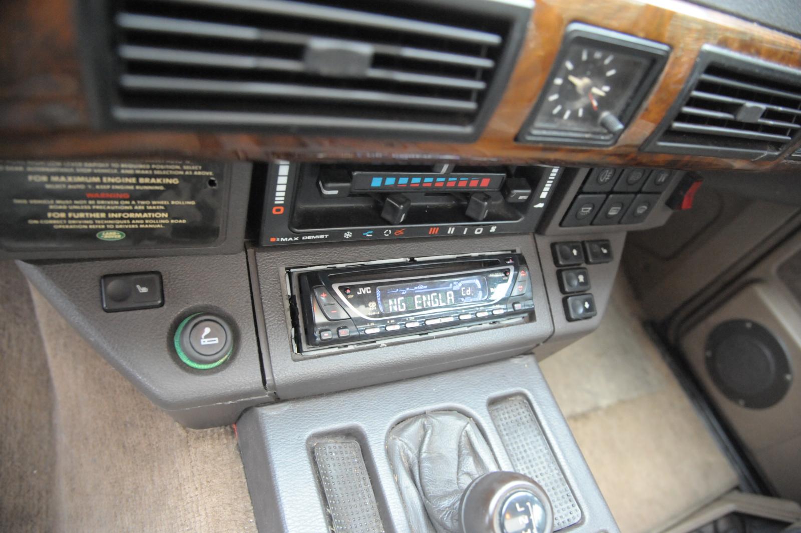

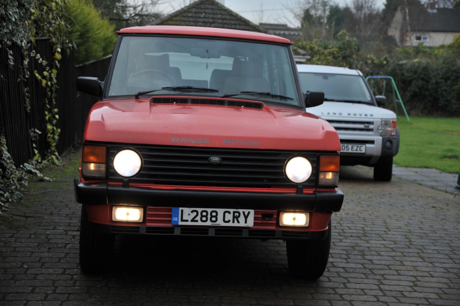

AMC Rebel Posted January 8, 2017 Share Posted January 8, 2017 A few pictures taken today - Dab Radio supports CD text shocker Real wood Both these speakers work -as do the ones in the other door At the helm - cruise control buttons on the steering wheel! All the Metro - style switchgear works (except cruise) and lights up at night, some green, some not. No idea what the red rocker switch does - suspect nothing.The group of 4 3 below is for the air suspension - which is no longer fitted. (4th switch is for the heated seat on this side which also no longer works). Evidence of possibly more than one high-powered exec's phone gubbins. michael1703, doug, dieselassist and 11 others 14 Link to comment Share on other sites More sharing options...
RoadworkUK Posted January 8, 2017 Share Posted January 8, 2017 Absolutely love it. Always liked the SD1-style re-positionable RHD/LHD cluster. And the sheer choice of directions you can have the interior air blowing in. AMC Rebel 1 Link to comment Share on other sites More sharing options...

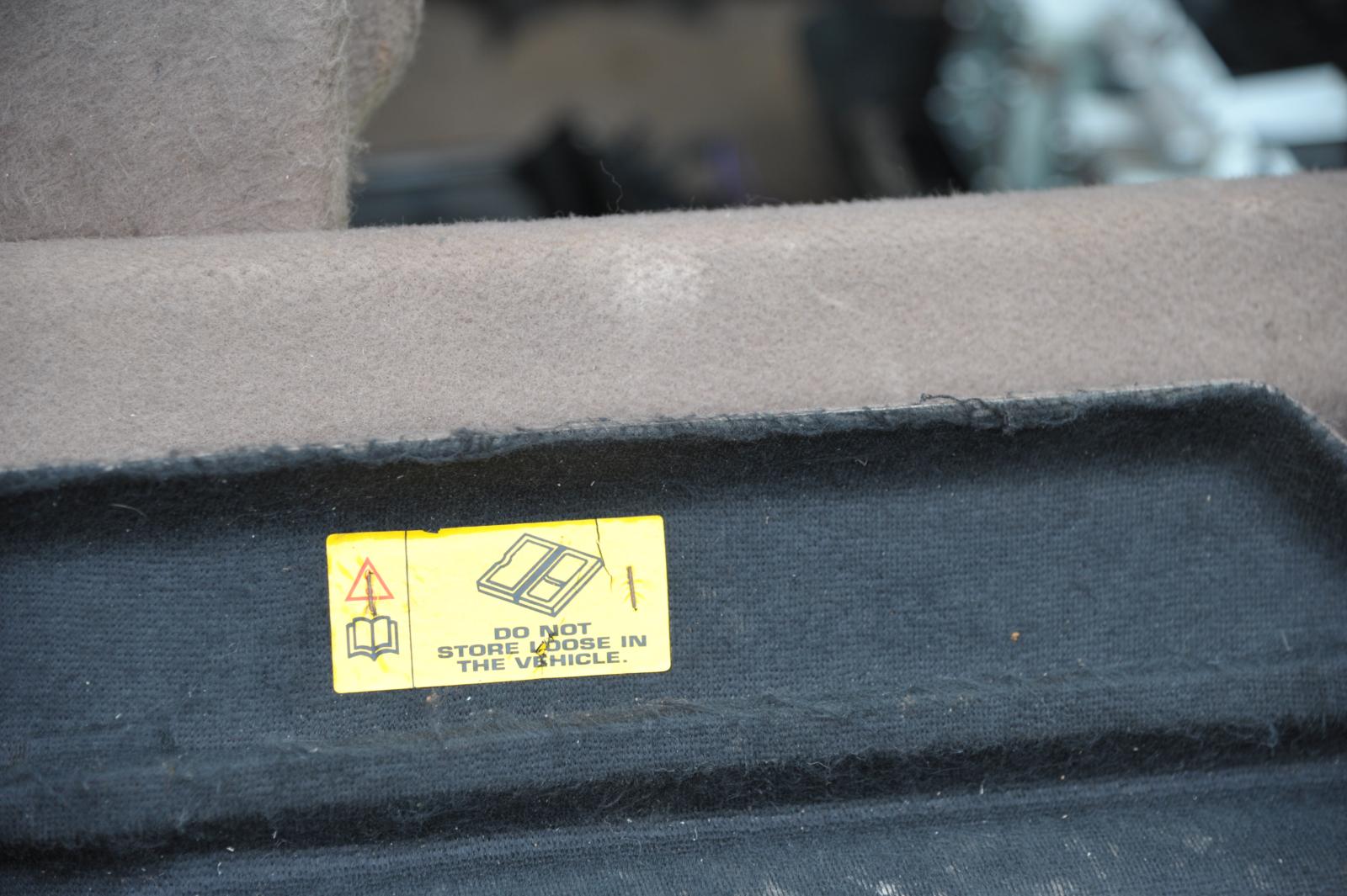

AMC Rebel Posted January 8, 2017 Author Share Posted January 8, 2017 Dead advanced Computer Alarm - so watch out LR instructions on how not to bust parcel shelf - privatewire, Uncle Jimmy, Junkman and 3 others 6 Link to comment Share on other sites More sharing options...
AMC Rebel Posted January 8, 2017 Author Share Posted January 8, 2017 Absolutely love it. Always liked the SD1-style re-positionable RHD/LHD cluster. And the sheer choice of directions you can have the interior air blowing in. Indeed - when new this even had Aircon. Link to comment Share on other sites More sharing options...

AMC Rebel Posted January 8, 2017 Author Share Posted January 8, 2017 Probably everyone except me already knew this, but it was green at some point (possibly originally) - I mean I knew the paint wasn't original, I mean I'm not stupid...oh hang on- Jim Bell and Junkman 2 Link to comment Share on other sites More sharing options...
AMC Rebel Posted January 8, 2017 Author Share Posted January 8, 2017 That looks very bonny. Well bought indeed. I am very pleased - the more so that my family (who don't know what it is really) have questioned the reasoning and wisdom. Junkman, Jim Bell and brickwall 3 Link to comment Share on other sites More sharing options...

For Fiats Sake Posted January 8, 2017 Share Posted January 8, 2017 Is it just me or are the ranger over letters abit squashed together? Lovely buy though! brickwall 1 Link to comment Share on other sites More sharing options...
AMC Rebel Posted January 8, 2017 Author Share Posted January 8, 2017 Is it just me or are the ranger over letters abit squashed together? Lovely buy though! No, not just you, it's been mentioned on other threads. Presumably done when the paint was done. For Fiats Sake 1 Link to comment Share on other sites More sharing options...

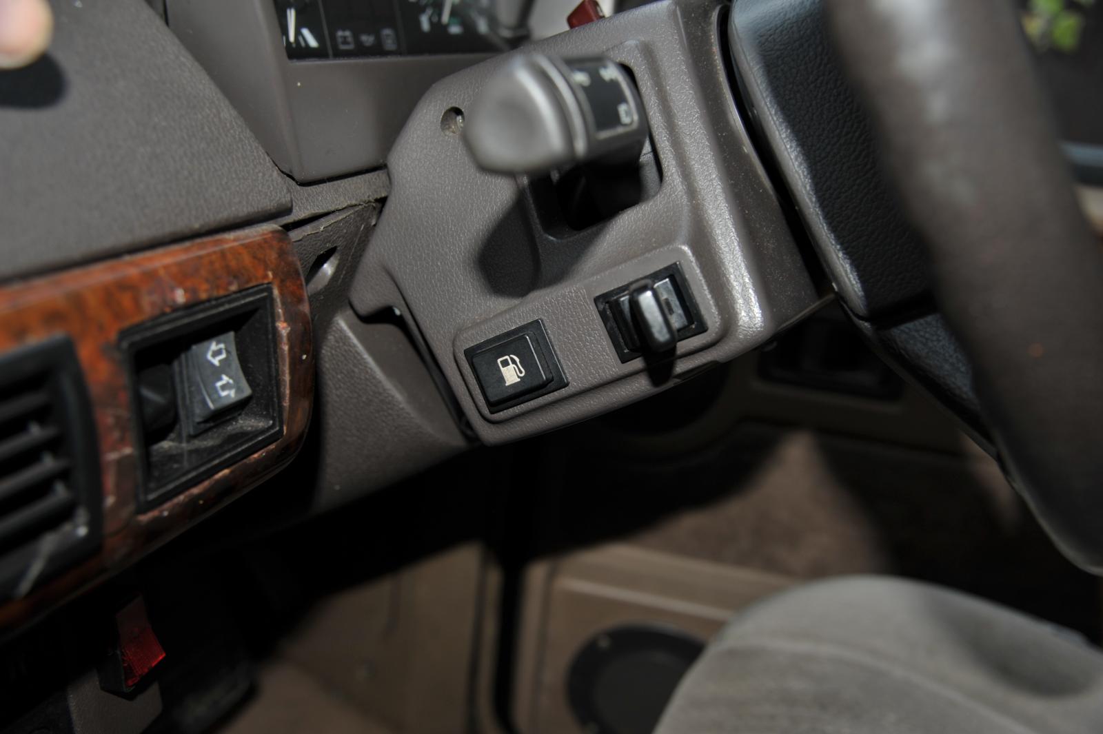

AMC Rebel Posted January 8, 2017 Author Share Posted January 8, 2017 Trick fuel filler door release privatewire 1 Link to comment Share on other sites More sharing options...

Ghosty Posted January 10, 2017 Share Posted January 10, 2017 No, not just you, it's been mentioned on other threads. Presumably done when the paint was done. The green oval badge is in the wrong place too, it looks a bit weird in the middle, being so small. AMC Rebel 1 Link to comment Share on other sites More sharing options...
AMC Rebel Posted January 10, 2017 Author Share Posted January 10, 2017 The green oval badge is in the wrong place too, it looks a bit weird in the middle, being so small.ooooh yes - hadn't noticed that. Link to comment Share on other sites More sharing options...

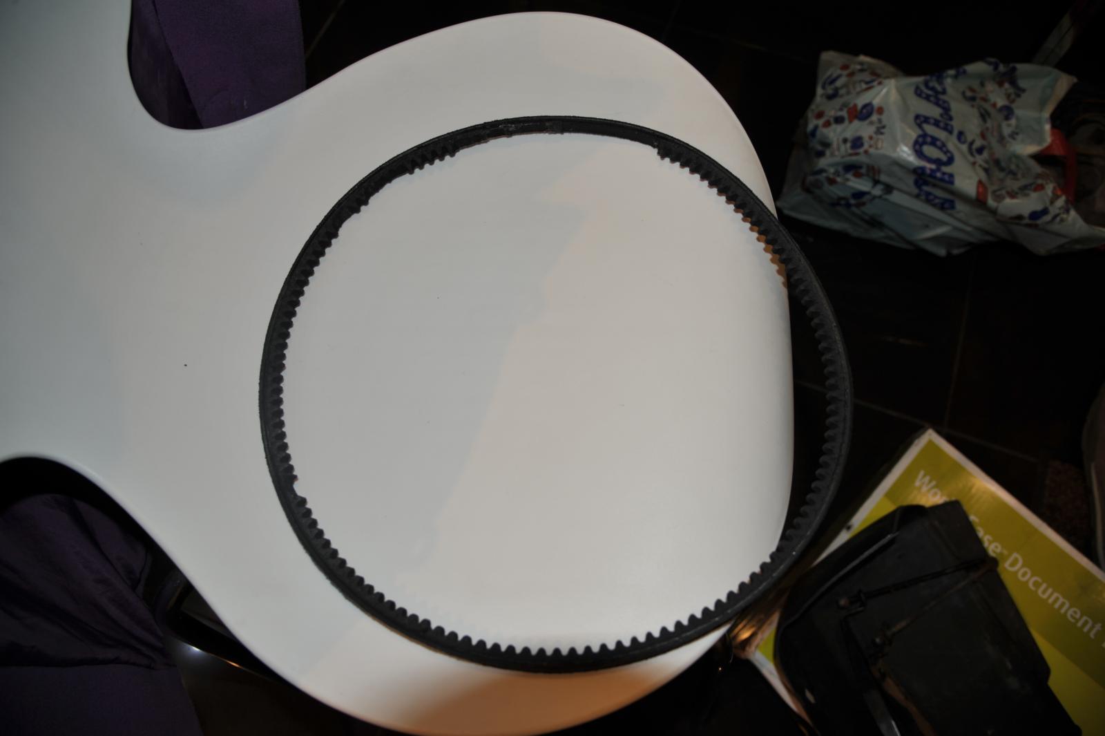

AMC Rebel Posted January 16, 2017 Author Share Posted January 16, 2017 Minor weekend ftp was the fan belt shredding itself New one purchased and will (hopefully) be fitted during my lunch hour today so I can retrieve the car from my Ma's. Just hoping the belt didn't disintegrate due to something else (water pump or power steering) seizing. Other (minor) faults noted - Heated Rear window doesn't/isn't.One side repeater out - no immediate clue as to how to remove lens and given my track record, I wasn't keen to force it.Fan only working on high speed - internet says this will be the resistor pack or maybe switch contacts - resistor pack sounds like it has a LR special random location according to phase of the moon when car was made - it's not a great hardship so may have to wait.Some sort of knock through the steering going over bumpsSuspect one of the two pipes feeding the rear vents under the cubby box is missing or disconnected as heat only comes out of one of the two sides and on the way back from BerwickI noticed the cubby box had the internal temperature of a pizza oven. Link to comment Share on other sites More sharing options...

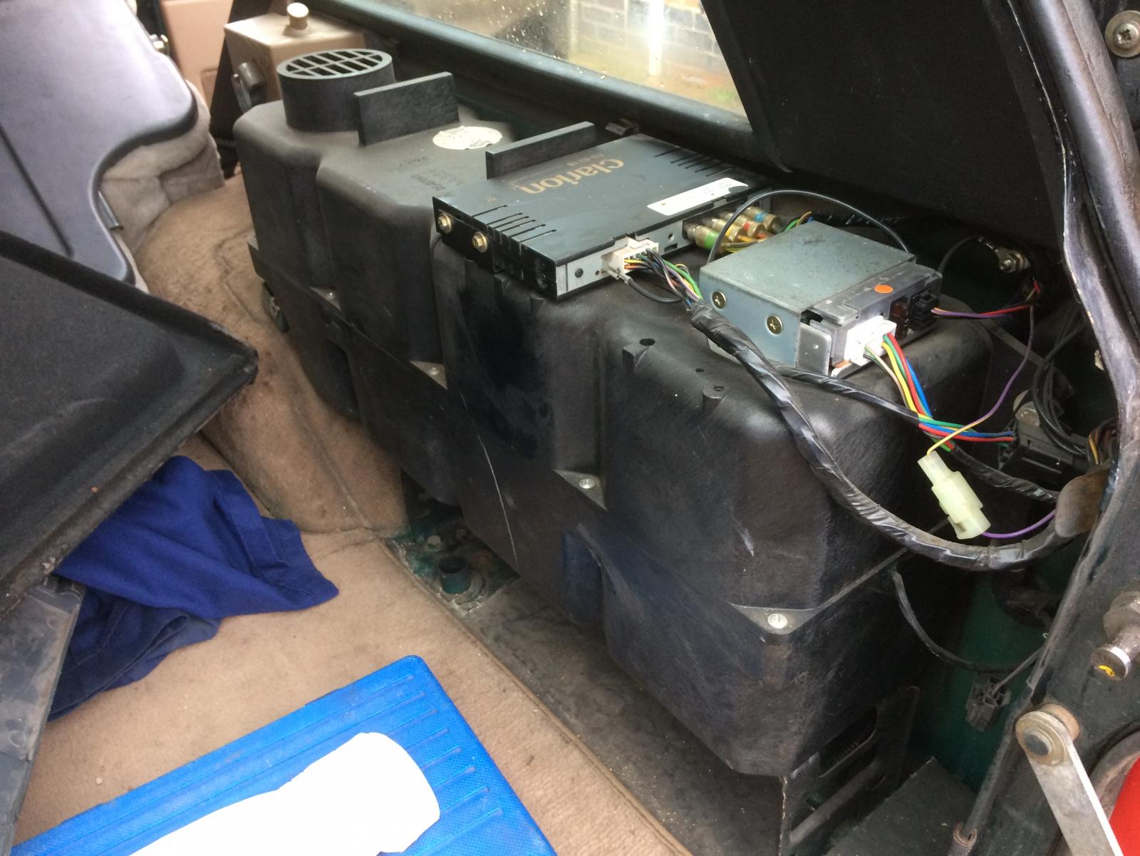

AMC Rebel Posted January 16, 2017 Author Share Posted January 16, 2017 OK, belt fitted and (touch wood) working fine. One other thing I'd quite like to do is to get this working - It's the factory subwoofer. I think the amp powers the two speakers above the tailgate and a twin coil sub in that big plastic box. mjrose78, Dirk Diggler and brickwall 3 Link to comment Share on other sites More sharing options...

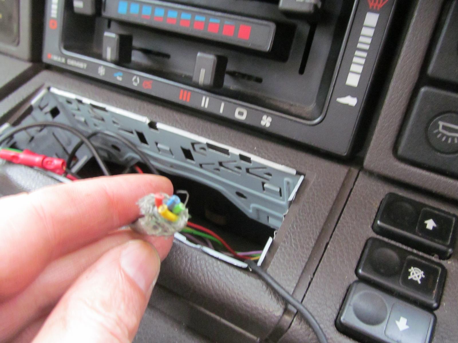

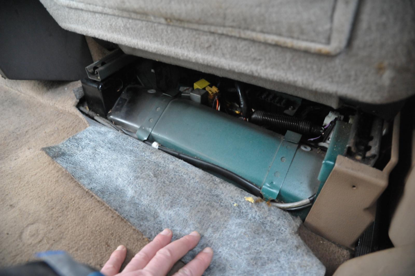

AMC Rebel Posted January 17, 2017 Author Share Posted January 17, 2017 OK, so because I am a sad git who likes taking things to bits and never putting them back together, I had another look at the stereo "arrangements" today. I posted a question in the stupid Q thread - then found a later factory shop manual online. It looks as if - -That Amp in the back does power the rear speakers and the sub - I am missing some wiring at the front, which would take the signals to the amp. I had a delve under the driver's seat where the loom from the amp emerges, but it's not easy to see without removing the seat. I am expecting to find a snipped loom somewhere. As I was tracing the audio loom back from the rear sub I was starting to think it must have been added by some hacker as it looks a bit amateurish - but then I found some pics online of a bloke with the exact same setup on his. So it's reassuringly factory bodgery (before whoever chopped it got there). The more I look at the utterly hatstand wiring, the more I like this car. Dirk Diggler 1 Link to comment Share on other sites More sharing options...
Guest Hooli Posted January 17, 2017 Share Posted January 17, 2017 Back in the day some cars used common negatives for speakers, I can't remember if RR's suffered this. If they did then you need to rewire the speakers for a new head unit anyway. Link to comment Share on other sites More sharing options...
AMC Rebel Posted January 17, 2017 Author Share Posted January 17, 2017 Fairly sure it not a common neg - certainly the rear isn't. I think these even had ISO connectors this late on (1994) The amp inputs are the RCA/Phono plugs - these run in the loom to the front (but the connection to the headunit's missing. The multiplug has the power supply and remote switch on as well as the output pairs. Someone does seem to have redone the front speakers, but I suspect there may have been a front amp too - it seems some did have that. Link to comment Share on other sites More sharing options...
AMC Rebel Posted January 18, 2017 Author Share Posted January 18, 2017 Back in the day some cars used common negatives for speakers, I can't remember if RR's suffered this. If they did then you need to rewire the speakers for a new head unit anyway. OK, mystery solved, possibly. It's starting to look as though the RCA plugs terminate at the front in a screened (Common earth via the screen - thanks Hooli) multicore - I reckon the common earth in this case won't be an issue as it's at signal level rather than speaker level. So task list is now - 1.Do a continuity check to confirm that these are really the same connections end to end.2.If so, graft some phono plugs on the the headunit end, to use the line out from the head unit.3.Connect correct power supply connections to headunit so that ign/acc etc settings work.4.fit DAB aerial.5.Hope sub amp is OK and subwoofer cone hasn't disintegrated like many - Dirk Diggler and brickwall 2 Link to comment Share on other sites More sharing options...
