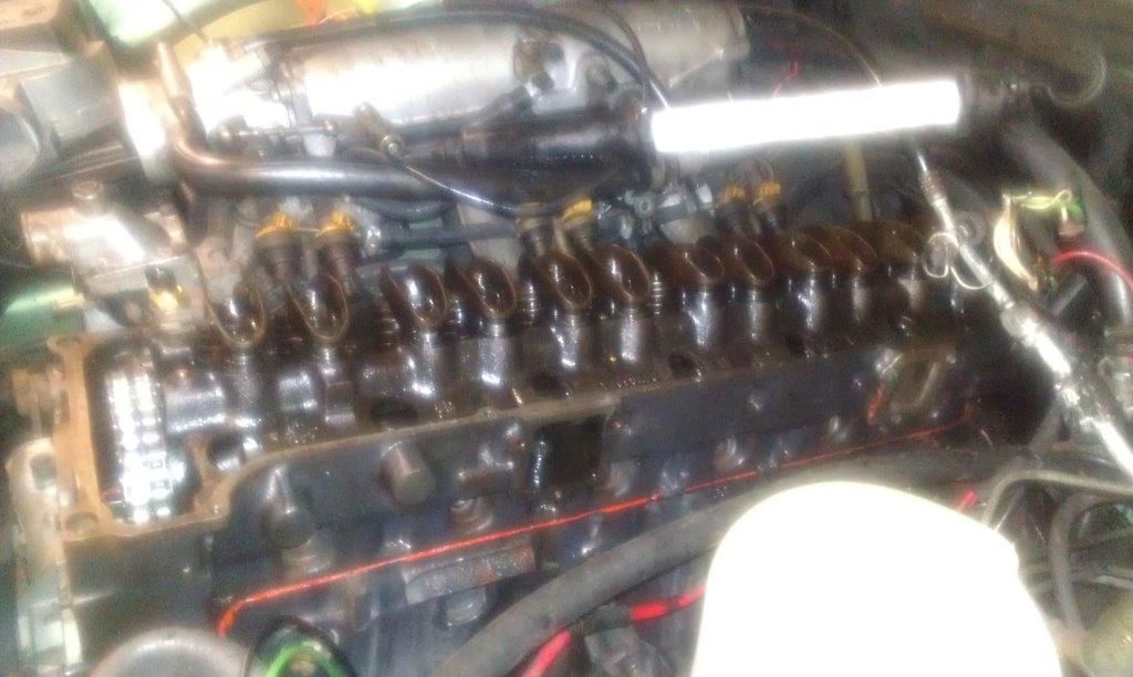

Stevebrookman Posted March 15, 2017 Author Share Posted March 15, 2017 Picture oh progress so far-head on tappets and rockers in. "Only" need to connect up pipes and wires and set the rockers with engine running and it's finished. Banger Kenny, mercrocker, Twiggy and 4 others 7 Link to comment Share on other sites More sharing options...

Stevebrookman Posted March 27, 2017 Author Share Posted March 27, 2017 Thought I'd have a "quick" look at the Senator after I got home. Two hours later I ended up with this. I'm getting good at this-must be the practise. One problem I saw was a hole blocked with sealant (wont be using it again!) No other obvious faults-"O" ring was in place I'm thinking too much paste and the fact I couldn't do the head bolts up for at least an hour as I dropped the splined socket into the head. another pic steve Banger Kenny 1 Link to comment Share on other sites More sharing options...
Junkman Posted March 27, 2017 Share Posted March 27, 2017 I have never ever seen anyone use sealant for a head gasket. That can't work properly. spike60, Stevebrookman, danthecapriman and 2 others 5 Link to comment Share on other sites More sharing options...
Stevebrookman Posted March 27, 2017 Author Share Posted March 27, 2017 Thanks Junkman!I won't be using any next time (there is a new head gasket under it). When I was a kid watching my Uncle and his friend home mechancking - they always used the old heamatite red-I definitely won't be using it next time. Steve mat_the_cat 1 Link to comment Share on other sites More sharing options...
Captain Furious Posted March 27, 2017 Share Posted March 27, 2017 Yep, using sealant on head gaskets is a definite no-no On the sort of plus side, at least you have a definite reason why it's failed first time round. Bang it on with a new clean gasket and you should be good to go mat_the_cat, Stevebrookman and Banger Kenny 3 Link to comment Share on other sites More sharing options...
Isaac Hunt Posted March 27, 2017 Share Posted March 27, 2017 Fair play for getting stuck in for round two. If having to do a job twice peeesice you off as much as it does me, you are mighty peiced. I'm with the chaps, Defo dry on a headgasket. I always used to use hylomar on thin paper rocker gaskets until it didn't work, so I moved to hermatite red, better but still not good. Then an ex RAC patrolman said 'use grease' on the paper rocker gasket, brilliant. Don't use grease on a OMGHGF though Stevebrookman 1 Link to comment Share on other sites More sharing options...

Stevebrookman Posted March 28, 2017 Author Share Posted March 28, 2017 Yep-my fault!I was given advice just to smear around the corners as Bren said, but went " slightly" overboard. Will send for a HG today and will also get a chain block from ebay to lower it down slowly. It,s a very heavy lump- bit like me! Anyway- if anyone wants a hand getting a CIH head off- I'm your man- just no good at putting it back on! No sealant this time!!!!! Thanks again Steve Ts mercrocker, Banger Kenny, danthecapriman and 1 other 4 Link to comment Share on other sites More sharing options...
The Reverend Bluejeans Posted March 28, 2017 Share Posted March 28, 2017 If you can wait a few days, I would recommend you get the head skimmed - just a 5 thou shave to make it perfect. Stevebrookman and Banger Kenny 2 Link to comment Share on other sites More sharing options...
Mr_Bo11ox Posted March 28, 2017 Share Posted March 28, 2017 Have you cleaned up the block & head faces with fine wet n dry as well? They don't look particularly clean in the pics. Banger Kenny and Stevebrookman 2 Link to comment Share on other sites More sharing options...
Stevebrookman Posted March 28, 2017 Author Share Posted March 28, 2017 They are not at the moment-all the left over sealant and gasket are still on-waiting for a new HG and I've ordered a chain block to lower it 0n-might be done on the weekend.I've got the wet n dry waiting! Thanks Steve Link to comment Share on other sites More sharing options...
Des Posted March 28, 2017 Share Posted March 28, 2017 Best not use any kind of sandpaper, scraper only, unless you have a preference for a blue tinge to your exhaust gas in which case work away. Stevebrookman, Junkman and CreepingJesus 3 Link to comment Share on other sites More sharing options...
