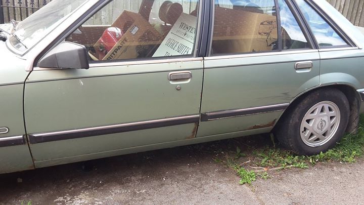

Stevebrookman Posted January 1, 2017 Share Posted January 1, 2017 Happy New Year all! I have found a 1982 Senator for £700 with 3 months MOT. Problem is the seller says it has started misfiring on one cylinder. He has replaced the fuel tank and all the pipework, it has had a new ignition amplifier, air sensor, temp sender and replacement injector wiring and plugs. Don't know if this was in order to fix the misfire or the misfire occurred afterwards. I am very interested in the car-but the misfire could be something simple or a borked engine. What do the collective think? Steve oman5 and Jim Bell 2 Link to comment Share on other sites More sharing options...

Stevebrookman Posted January 1, 2017 Author Share Posted January 1, 2017 danthecapriman, Vince70, uk_senator and 37 others 40 Link to comment Share on other sites More sharing options...
DSdriver Posted January 1, 2017 Share Posted January 1, 2017 In my mind, engines are easy to repair (once you know what the problem is) but rust is an evil thing that hides behind whatever it can.So check that it is solid before parting with your hard earned. Those door bottoms might be indicative of worse underneath.It does seem to be calling an Autoshiter. Asimo, Stevebrookman, panhard65 and 2 others 5 Link to comment Share on other sites More sharing options...
Pillock Posted January 1, 2017 Share Posted January 1, 2017 I don't care if it's rusty and the engine is borked. Those seats! mercrocker, Junkman, rantingYoof and 13 others 16 Link to comment Share on other sites More sharing options...

danthecapriman Posted January 1, 2017 Share Posted January 1, 2017 Based on your pics I'd just buy it. Aside from the fact it looks lovely (and those seats!) the pro's are that it has MOT, does run and drive and it looks pretty decent rust wise. This means you shouldn't have any issues getting it home and it might even clear itself with use.This damp cold shitty weather doesn't do old cars any favours so is it possible it's just suffering a bit from damp and lack of use? Maybe running it and driving it might dry it all out a bit? Because it's only one cylinder I doubt it'll be serious anyway.I had a Volvo 340 that developed an irritating mis fire, on checking it over I could find nothing out of place. Everything looked good but just by chance I decided to pull the HT leads off the top of the dizzy cap which revealed the fault. The brass terminal under the HT leads connector/seal was green with corrosion. This, inspite of both the cap and leads looking in perfect order. I replaced them and the fault disappeared.I'll bet it'll be something similar on this Senetor, but even if it's worse it'll only be a valve or something so isn't the end of the world at all. eddyramrod, Stevebrookman, Twiggy and 2 others 5 Link to comment Share on other sites More sharing options...
