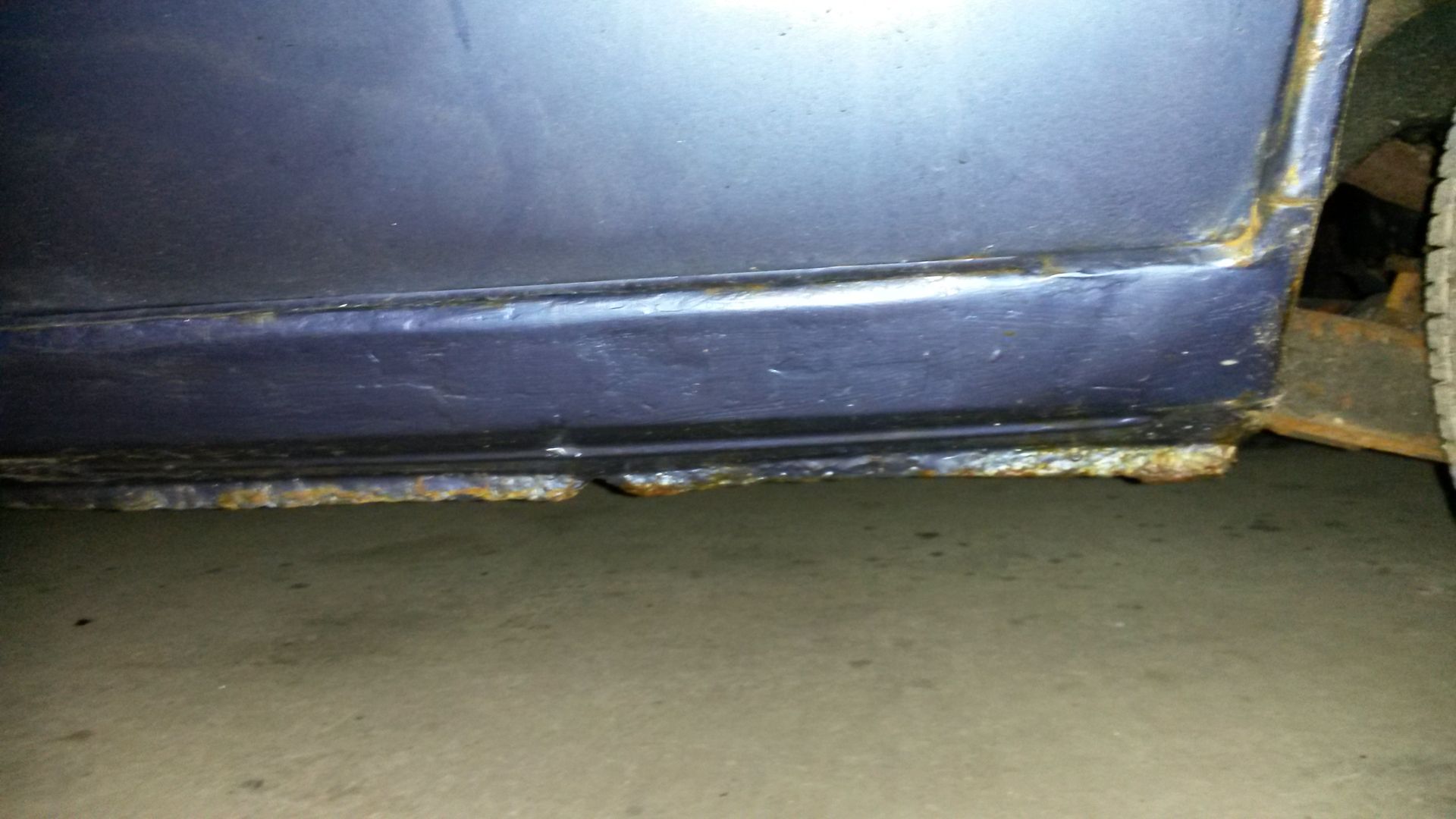

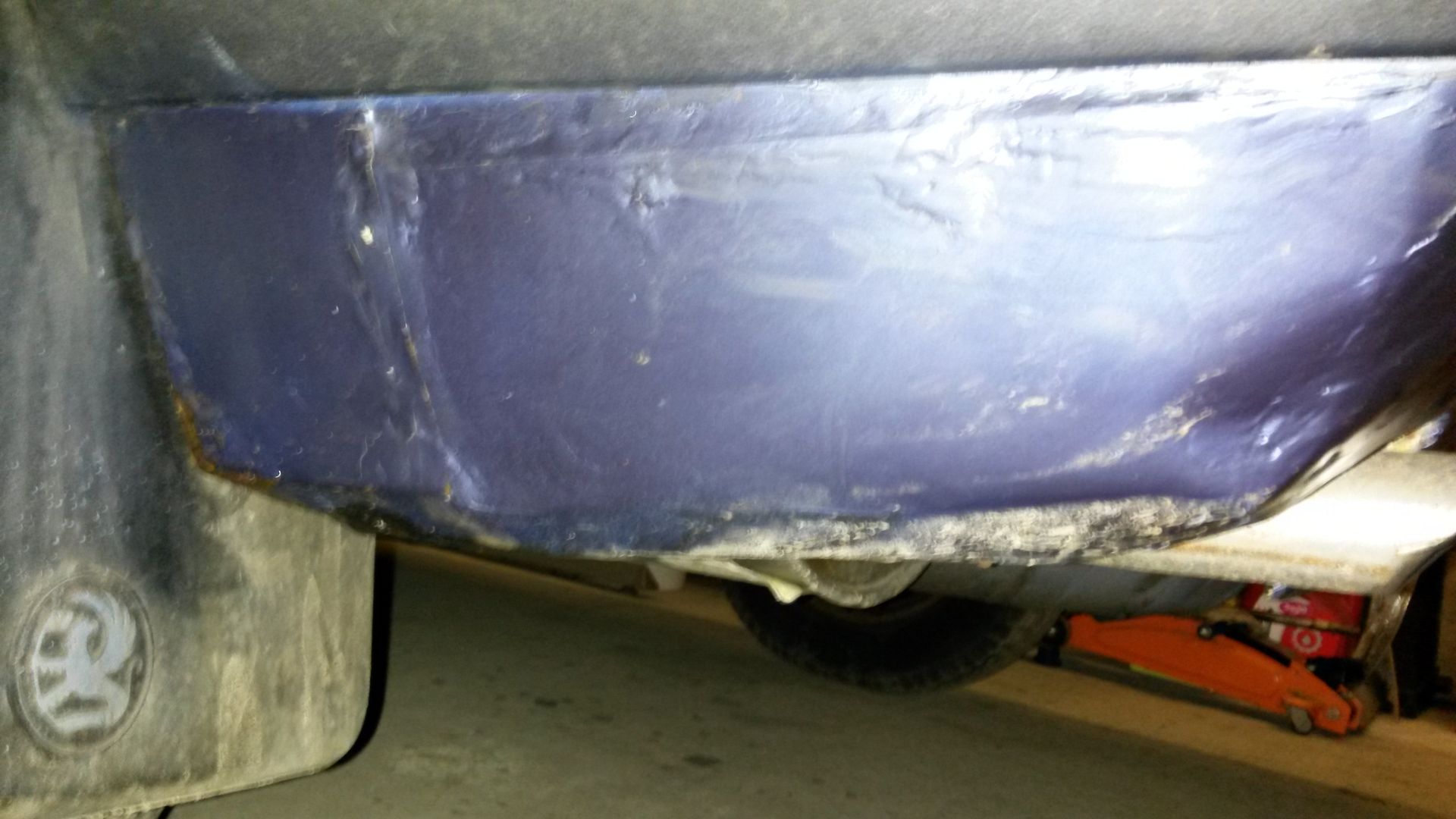

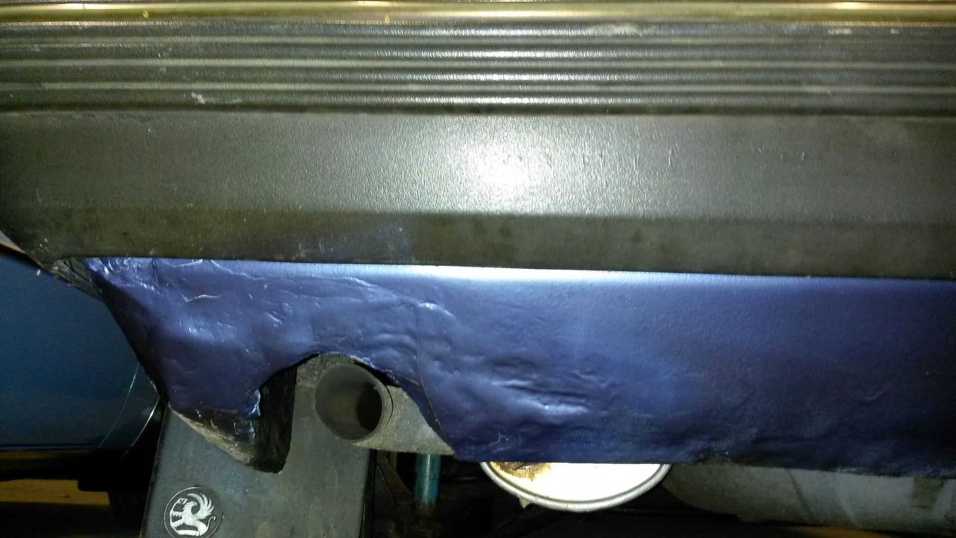

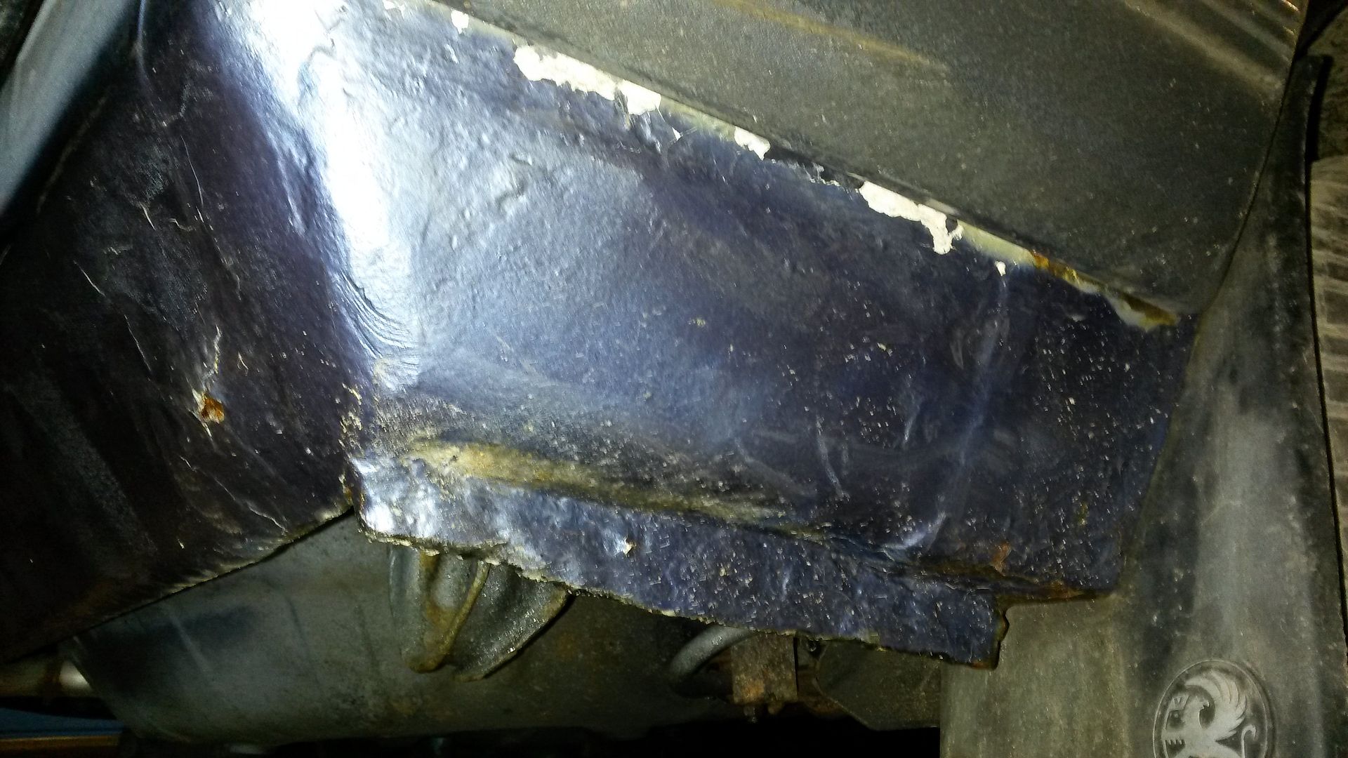

Had a good look underneath earlier, and it's good news! The spring cups on the rear chassis legs have been replaced, and a small patch has been put in the back of the inner sill on both sides. Nothing else requiring attention has been spotted, but the welding looks like it was done with a stick. It's all hammer proof, but I'll most likely tidy up the welds so that they won't be obvious. The rest of the underside appears to be in really good nick - just a few bits of light surface rust. :)
The wobbed up rear valance
Offside rear corner - arch repair section plonked over the top and wobbed up.
Nearside rear corner - similar 'repairs" to the offside - but with even more wob.
The rear half of both outer sills done in the same style as the arches - repair panel tacked over the original one, followed by lashings of wob.

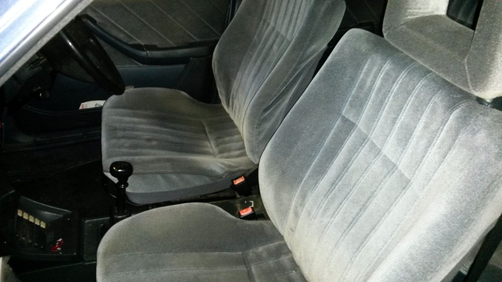

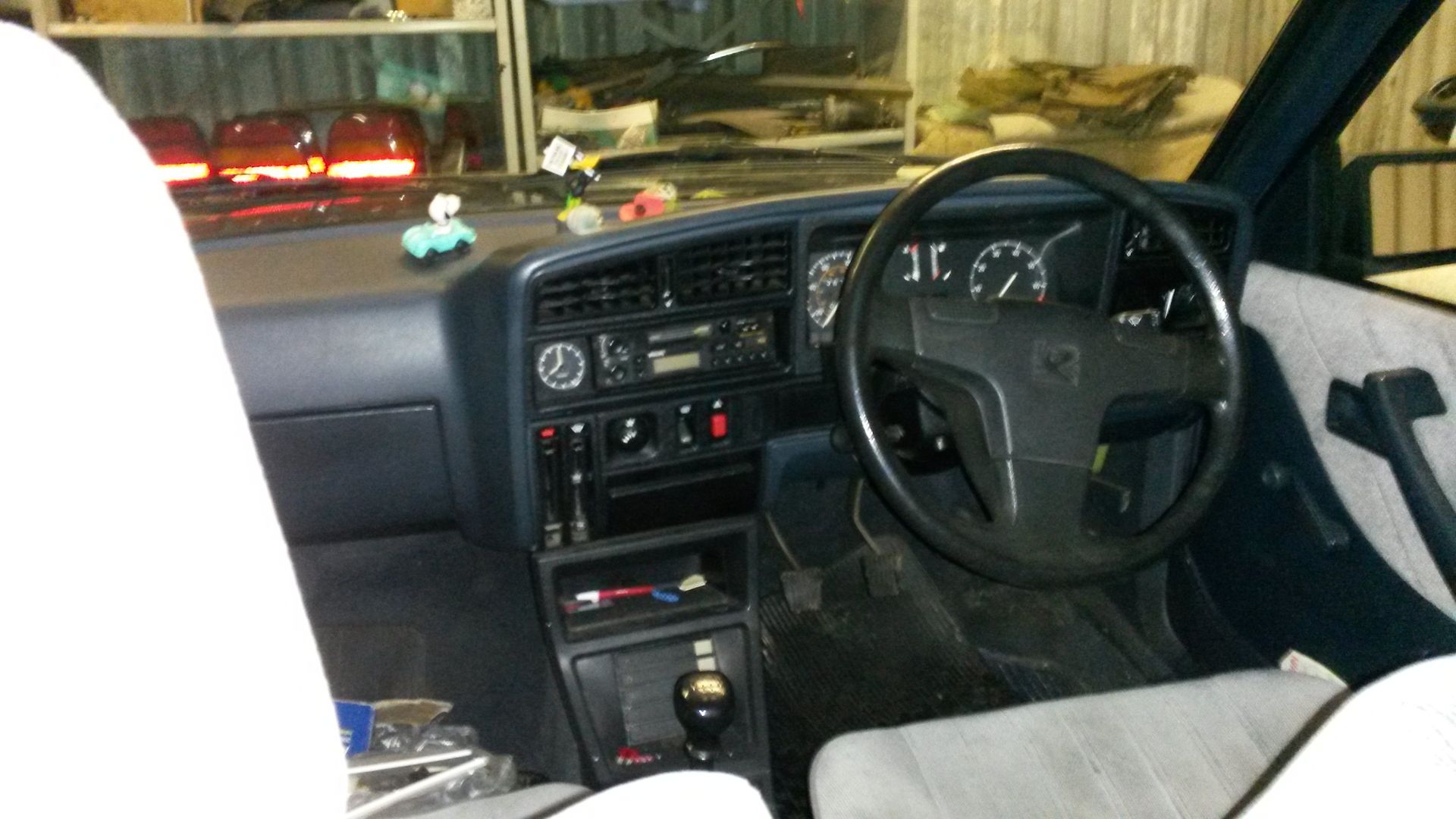

The interior is in fine fettle, sadly the camera flash makes the velour of the seats and door cards look a washed out grey - they're blue in real life!
Seats are tidy
Sunroof works well, and doesn't appear to leak

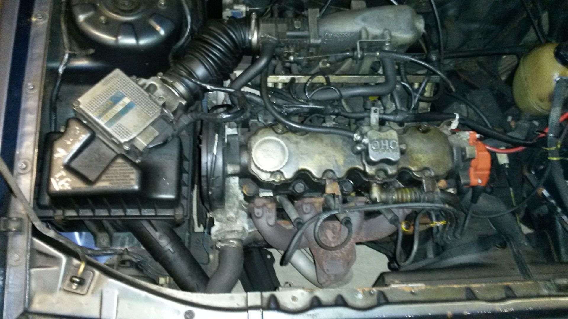

Behold! The mighty donk - its very quiet, doesn't smoke, and apart from a bit of a stutter at about 2000rpm under load, it pulls well.
The clutch can indeed be changed without removing the gearbox - I took a picture of it, and then subsequently deleted it by accident!

Somebody didn't understand how filler works.  It will be interesting to see what you uncover when you poke that.  I don't remember the interior on these being that plush.

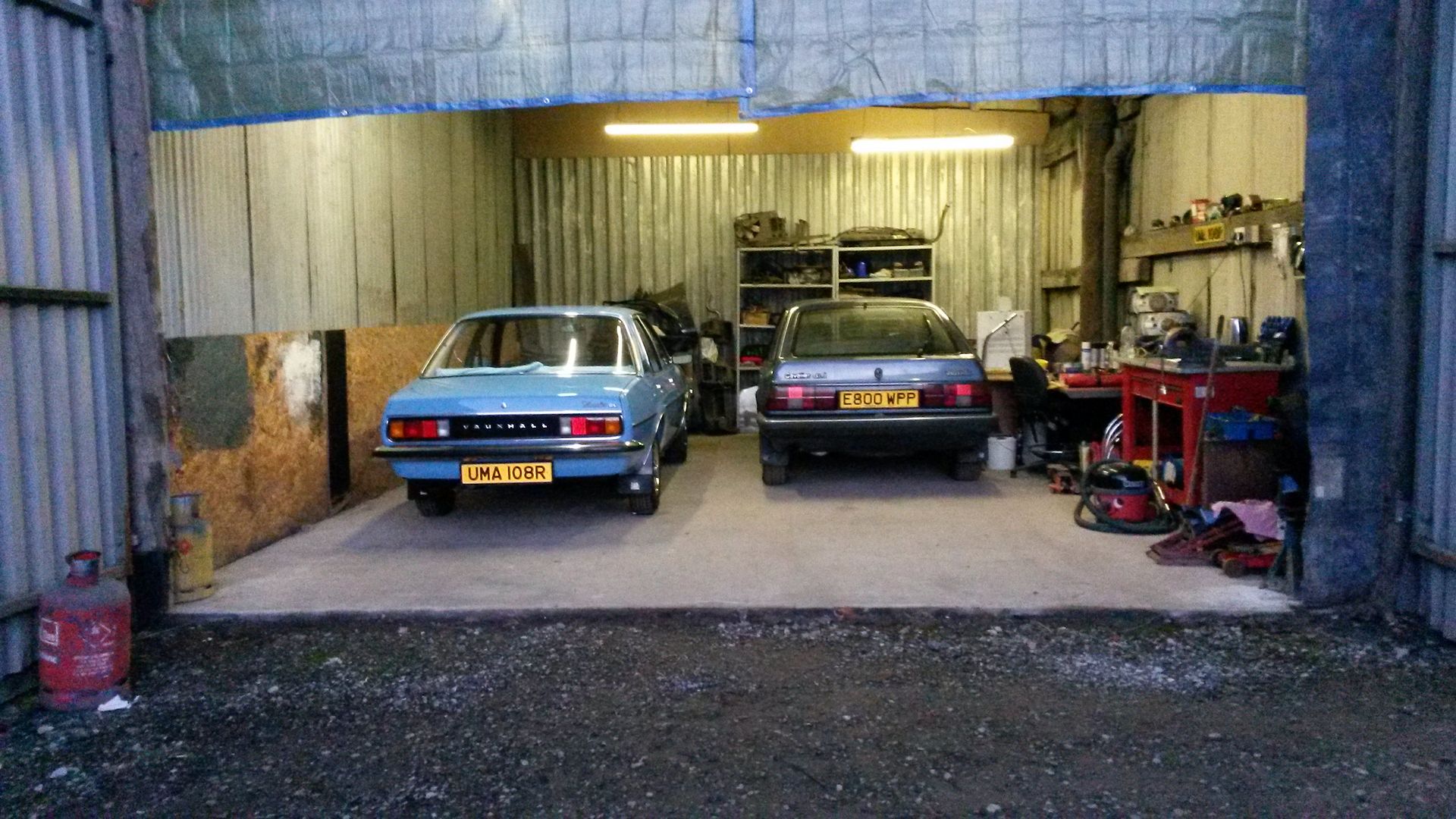

Spent a bit of time playing with my recently acquired chod this afternoon. The headlights are no longer remaining on whenever the battery is connected. The culprit was the dim dip resistor pack thingy - simply unplugging it solved the problem. If I can find one to replace it, I will do, but it's not a legal requirement anymore and so not really a problem.
The time clock in the fascia didn't work or light up, but a replacement courtesy of eGay was clipped in today too.
The clutch biting point was just off the floor when I got the car, but a cheeky adjustment of the clutch cable and it's a lot nicer to drive now.
Being totally out of practice, I completely forgot to take any pictures of today's fettlery, so here's one of the shed just before locking up for the day.
